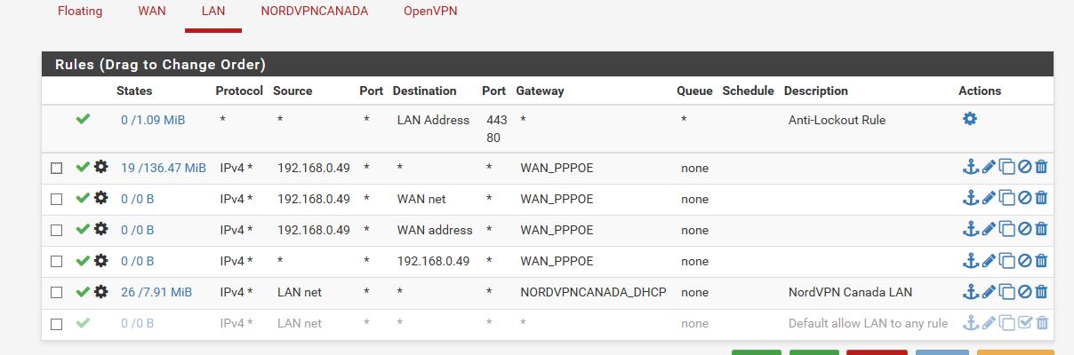

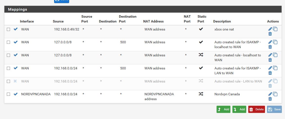

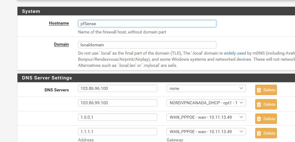

      here some pics
      T 1 Reply Last reply Aug 16, 2018, 12:13 AM Reply Quote 0
      • T
        TheNarc @comet424
        @comet424 The interface firewall rules (e.g. LAN and WAN) execute on a "first match" basis, so as configured they're not going to achieve what you want. For LAN, you'd want the following top-to-bottom order:
        • Anti-Lockout Rule
        • xbox bypass VPN rule
        • LAN net to any rule that sets the gateway to your VPN
        That assumes that you want all traffic to be routed through the VPN by default.
        I think your WAN firewall rules are okay, although I don't know what assigning a gateway on a WAN firewall rule is going to do . . . maybe nothing, but I don't think it can do anything useful. Do you have a corresponding port forward of port 80 to 192.168.0.224? You need both a port forward and the WAN rule that you already have.
        What is 192.168.0.49? I'm really not familiar with PPPoE but that rule strikes me as odd. I assume it's an IP associated with the DSL modem? If so, it's probably not ideal for your pfSense LAN net and the DSL modem to both be in 192.168.0.0/24.

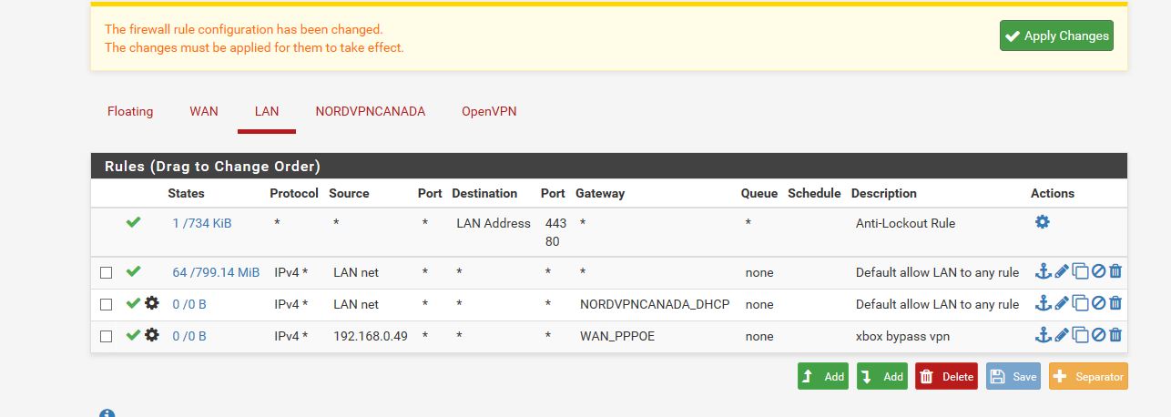

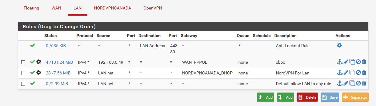

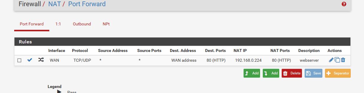

            ok so here is the port forward page hope i did right
            and i slide the rules around is that correct 1_1534380068450_pf5.JPG 0_1534380068450_pf4.JPG
            T 1 Reply Last reply Aug 16, 2018, 12:49 AM Reply Quote 0
            • T
              TheNarc @comet424
              @comet424 Alright, this looks better. Your WAN rule for the xbox (with source of 192.168.0.49) is unnecessary though and you can remove it. Your LAN rules look better, although the way they are now, nothing will be routed through the VPN. Traffic from your xbox will match the "xbox bypass vpn" rule and should successively bypass the VPN, but all other traffic will match the rule right under that one, and also bypass the VPN. If you want everything except your xbox to go through the VPN, just remove the rule directly below your "xbox bypass vpn" rule.
              Your port forward and corresponding WAN rule look good to me (actually it looks like pfSense added the WAN rule automatically when you added the port forward, which is exactly what should have happened). Can you get to port 80 on that machine from your LAN? There's nothing I see here that would be standing in the way, so I'd be inclined to move suspicion to the machine that's running the web server.

                        TheNarc @comet424

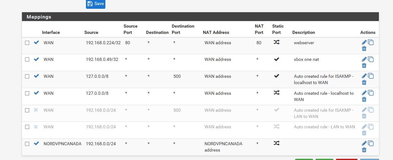

                        @comet424 I see it, sorry I should have seen it before. Get rid of the "mapping" for 192.168.0.224.
                        • C
                          comet424
                          which one location? i did rename it to 192.168.0.11 that way it wasnt run by dhcp

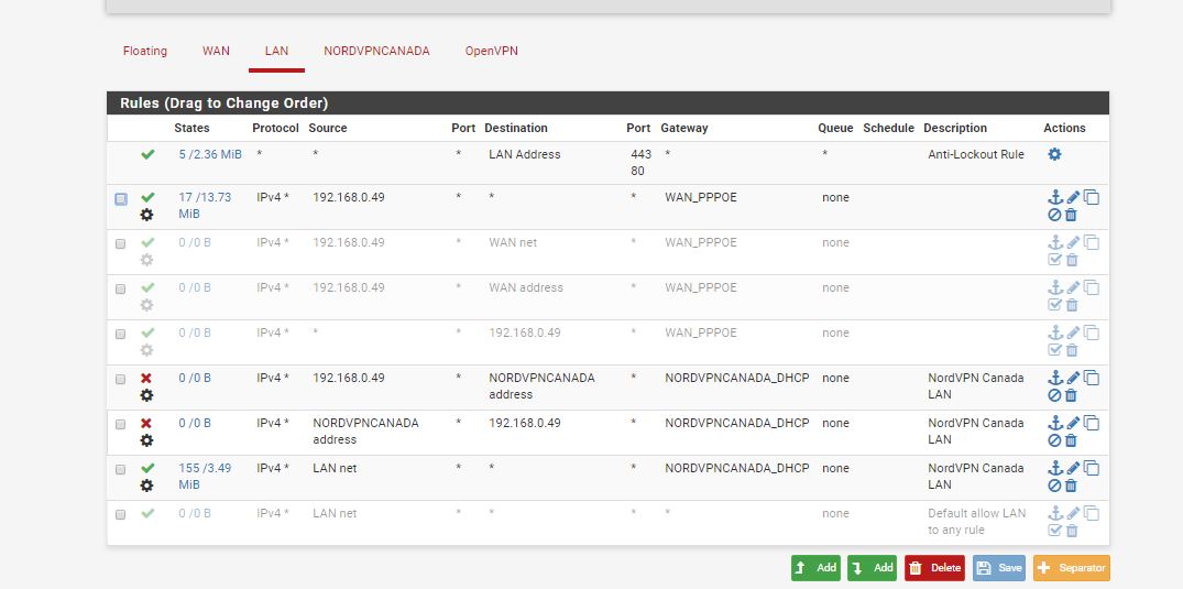

                              ya i have followed both of those ways before and just did it again
                              if i do a clean install of pfsense.. and do either of those instructions Xbox Opens
                              when i setup the VPN.. it sees i have internet.. but then i get the Teredo IP address so xbox doesn't function anymore.. so i must be missing a step
                              this is the tutorial i followed for the vpn
                              https://nordvpn.com/tutorials/pfsense/pfsense-openvpn/
                              so maybe one of them settings is buggering up the thing
                              i redid the setup and here some pics
                              3_1534435489705_p4.JPG 2_1534435489705_p3.JPG 1_1534435489705_p2.JPG 0_1534435489704_p1.JPG
                              so i stumped works fine before i setup the vpn but i set the vpn below the xbox bypass so it should work must be a setting just a check box that needs checking i bet

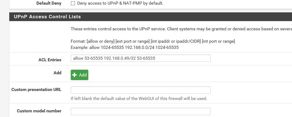

                                here is the UpnP settings i set too

                                  also experiencing from xbox high packet loss %22 packet loss
                                  and I finding computer slow and wasn't sending pics
                                  so frustrating it should be working
                                  and I disabled the upnp cuz the one article said it conflicts but still not working

                                    below is rules I just playing with I tried going xbox ip to Wan address Wan Net didn't work, if I did destinate * or the any it showed packets going as you see but it also was sending at the vpn… its not working just sending directly to the WAN interface I so frustrated
                                    I do reboots of the pfsense and xbox nothing helps
                                    T 1 Reply Last reply Aug 17, 2018, 2:46 PM Reply Quote 0
                                    • T
                                      TheNarc @comet424
                                      @comet424 I don't have a theory as to why just adding the VPN client connection breaks the xbox, since your firewall rule is excluding the xbox from going through the VPN. One thing would at least be easy to try is to have a LAN firewall rule that directs all traffic whose source is NOT the xbox through the VPN. That way you don't have a firewall rule explicitly matching traffic from the xbox. However, I can't think of any way in which having a firewall rule matching traffic from the xbox would in any way cause problems. But if you want to try that, just disable all but the bottom two LAN firewall rules from your most recent screen shot. Enable the bottom "Default allow LAN to any" rule, and then edit the "NordVPN Canada LAN" rule above so that the Source is set to 192.168.0.49 with the "Invert match" box checked (i.e. the source is anything EXCEPT 192.168.0.49). I don't have high hopes for this, but I don't have any other ideas at the moment either.

                                          @comet424 It's expected that you would see both firewall rules (the one for your xbox and the one for your VPN) getting traffic. And the fact that the xbox rule is getting traffic would seem to indicate that it's working. So I don't know why it's not.
                                          For your web server, did you delete the outbound NAT rule, the one with the source of 192.168.0.224/32? I think if you get rid of that, if should work.
