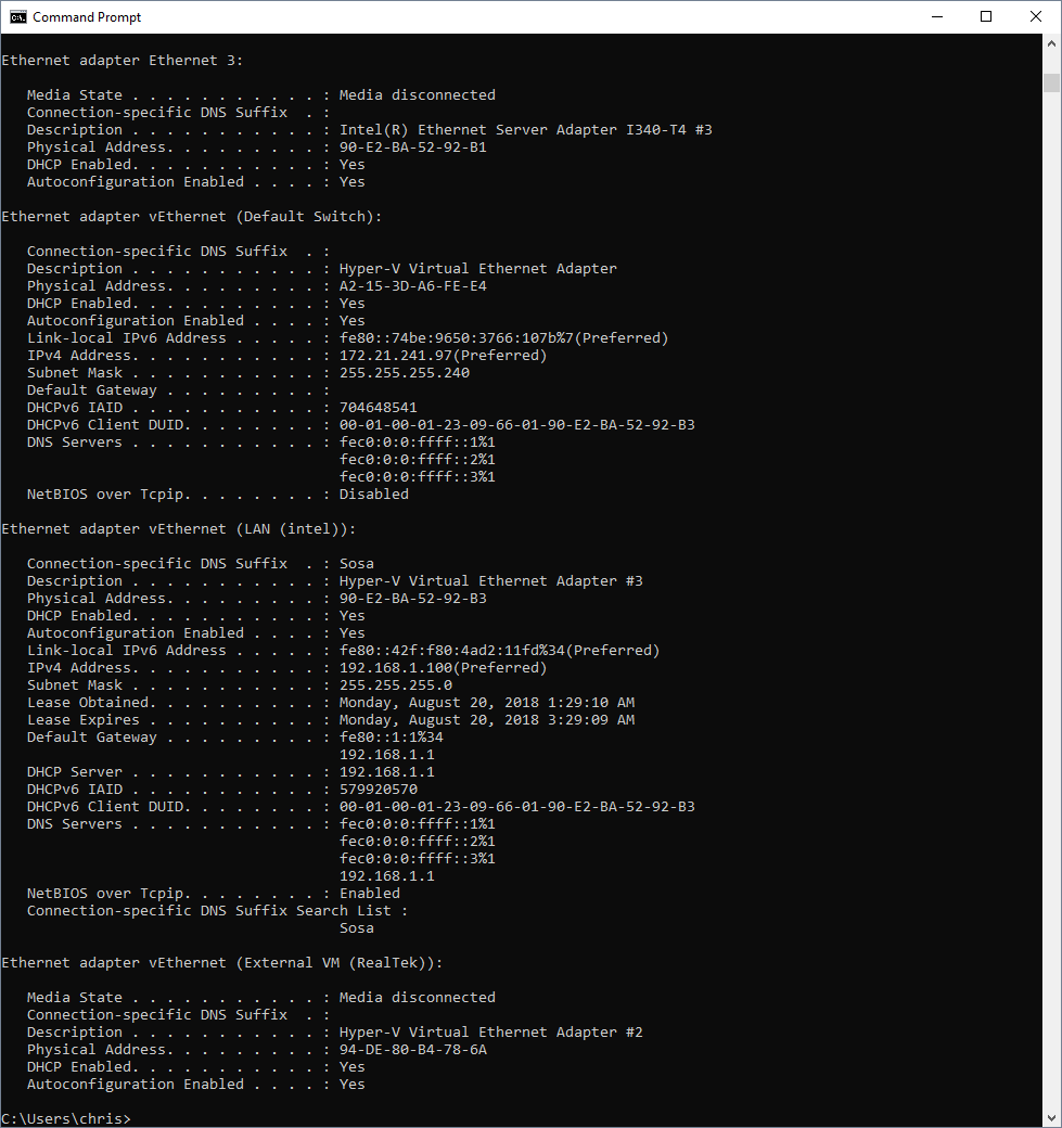

      Here is a screenshot of what windows is showing within ipconfig

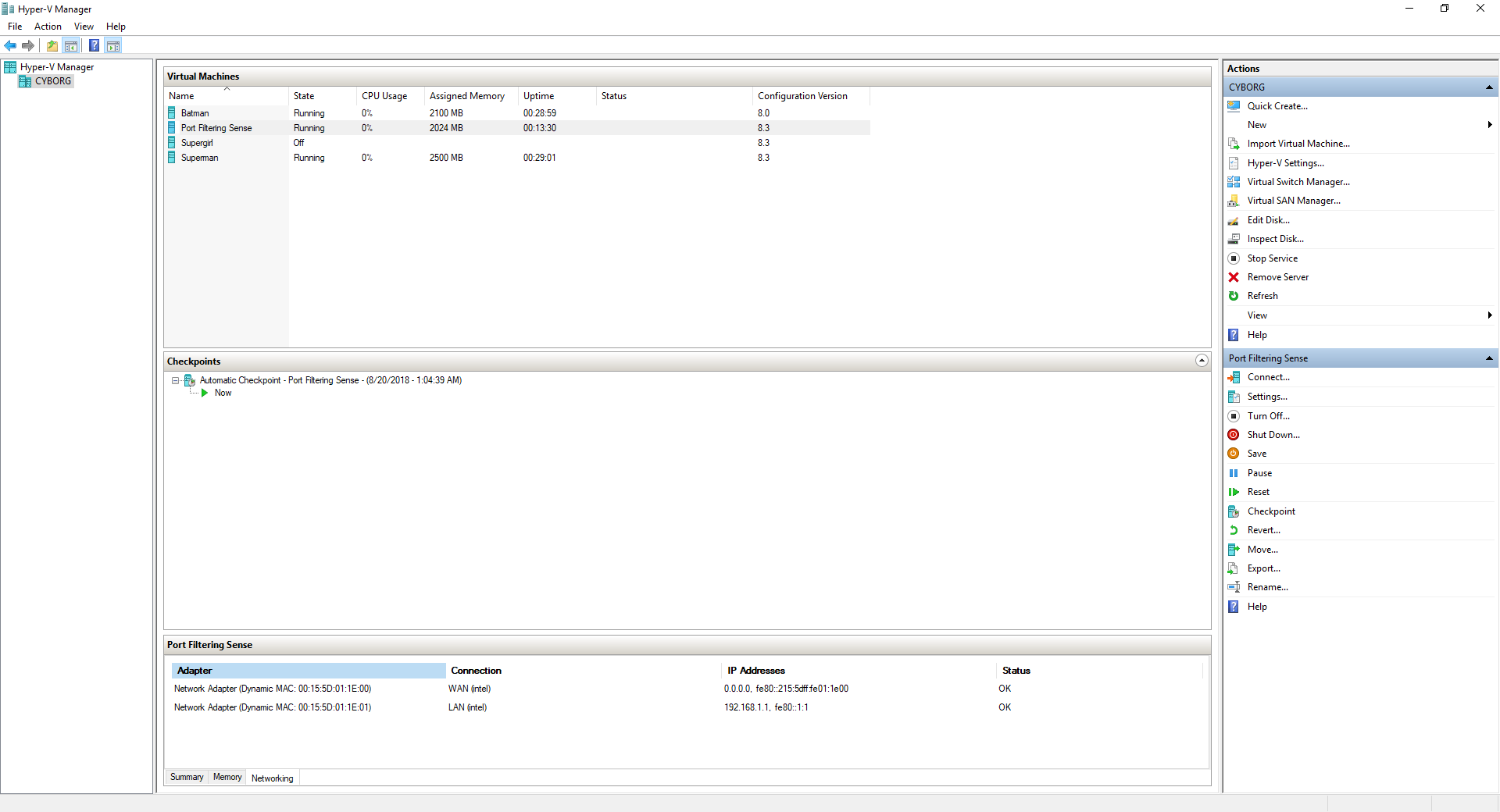

      Settings of the network adapters within pfsense vm

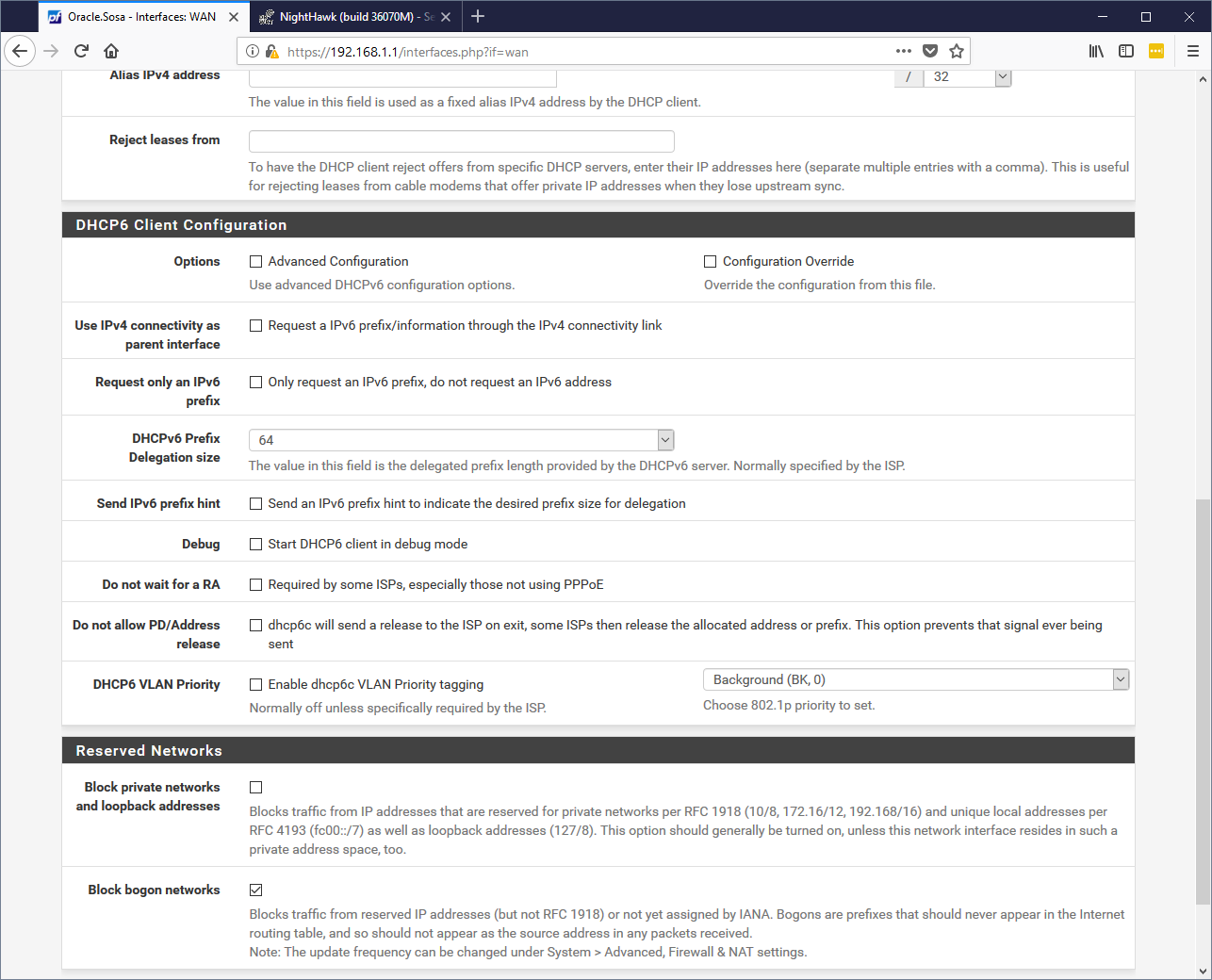

      pfsense WAN general configuration below.
      5_1534759562171_pfsense WAN gen config.PNG 4_1534759562170_pfsense WAN gen config 2.PNG

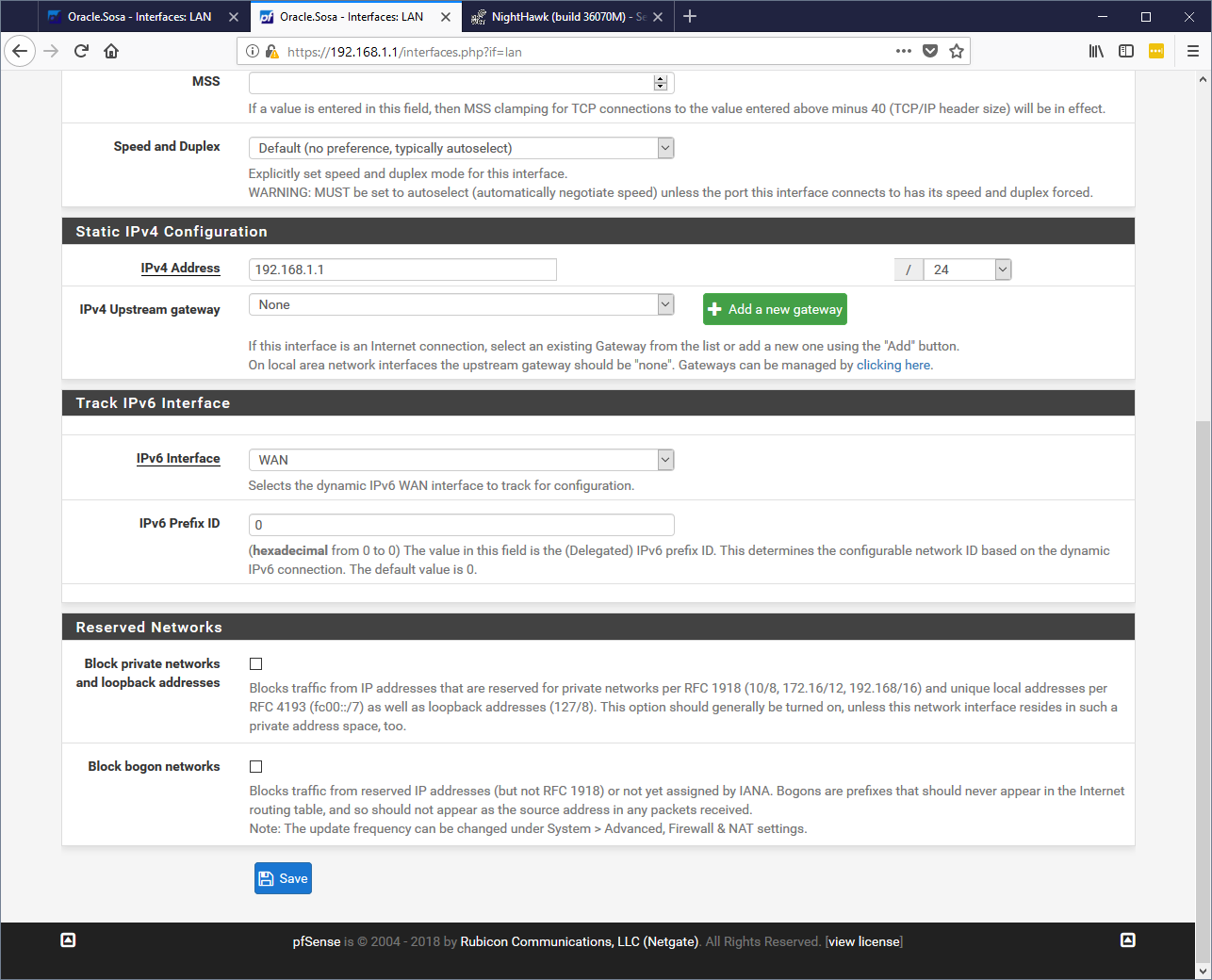

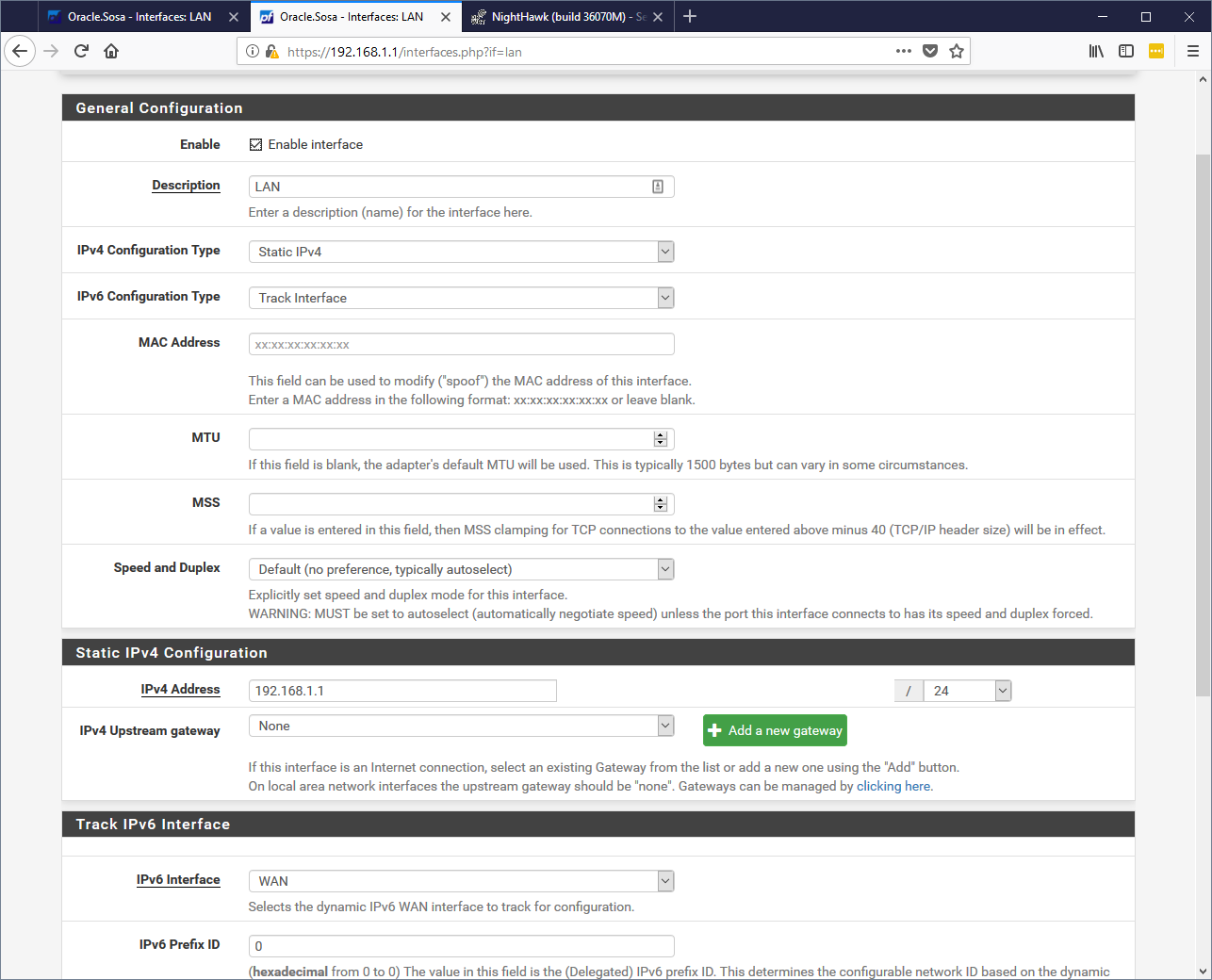

      Pfsense LAN general config
      3_1534759562170_pfsense LAN gen config.PNG 2_1534759562170_pfsense LAN gen config 2.PNG 1_1534759562170_pfsense interfaces.PNG
