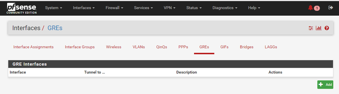

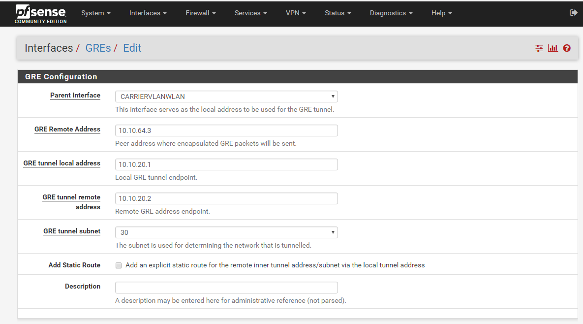

      GRE Tunnel Setup seems to be broken in 2.4.4
      If you create a gre tunnel and hit save you get a red warning bell in the upper right corner and it tells you config has been restored. I'm using nightly build vom 21.8.2018

        I found on the pfSense device a crash report:
        Crash report begins. Anonymous machine information:
        amd64
        11.2-RELEASE-p2
        FreeBSD 11.2-RELEASE-p2 #82 eb425b2af5a(RELENG_2_4_4): Tue Aug 21 23:59:33 EDT 2018 root@buildbot3:/builder/crossbuild-ce-master/obj/amd64/FWJoMRHc/builder/crossbuild-ce-master/pfSense/tmp/FreeBSD-src/sys/pfSense
        Crash report details:
        PHP Errors:
        [24-Aug-2018 19:35:08 Europe/Berlin] PHP Warning: exec(): NULL byte detected. Possible attack in /etc/inc/util.inc on line 1720
        [24-Aug-2018 19:35:08 Europe/Berlin] PHP Warning: file_put_contents() expects parameter 1 to be a valid path, string given in /etc/inc/interfaces.inc on line 1068
        No FreeBSD crash data found.

          • jimpJ Offline
            Looks like https://redmine.pfsense.org/issues/8683
            I added a note there that it also affects GRE
