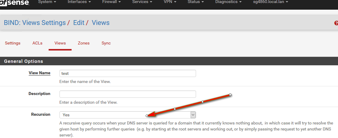

                So your saying none of those resolve? What do you get back when you ask NX or ServFail?
                If you don't want bind client to be able to resolve - then set that up in your view.. Set it to no recursion if you only want to return what your authoritative for.

                              We seem to be missing each others edits ;) Did you get my edit about views to prevent recursion.
                              curtisgriceC 1 Reply Last reply Reply Quote 0
                              • curtisgriceC Offline
                                curtisgrice @johnpoz
                                @johnpoz Yes I did find the recursion setting in the view view. Thank you.
