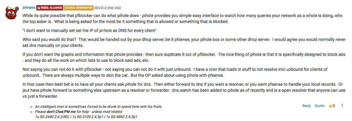

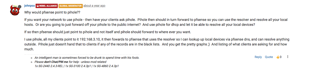

      The one that made the most sense to me was in these forums: a year old posts by @johnpoz in response to a user asking the same question.

      The original posts by @johnpoz are here below:

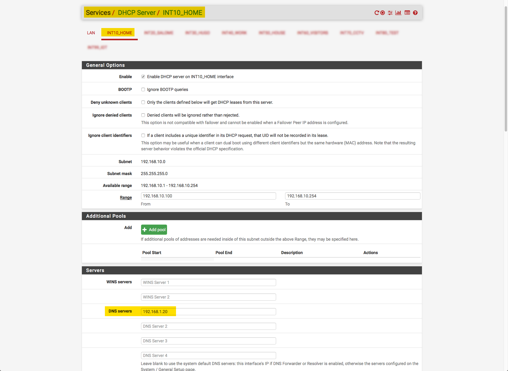

      1/ For each VLAN I point to the pi-hole in the DNS setting:

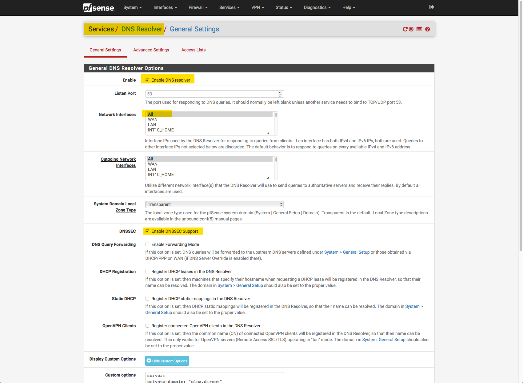

      4/ My PfSense DNS Resolver is configured as follows:

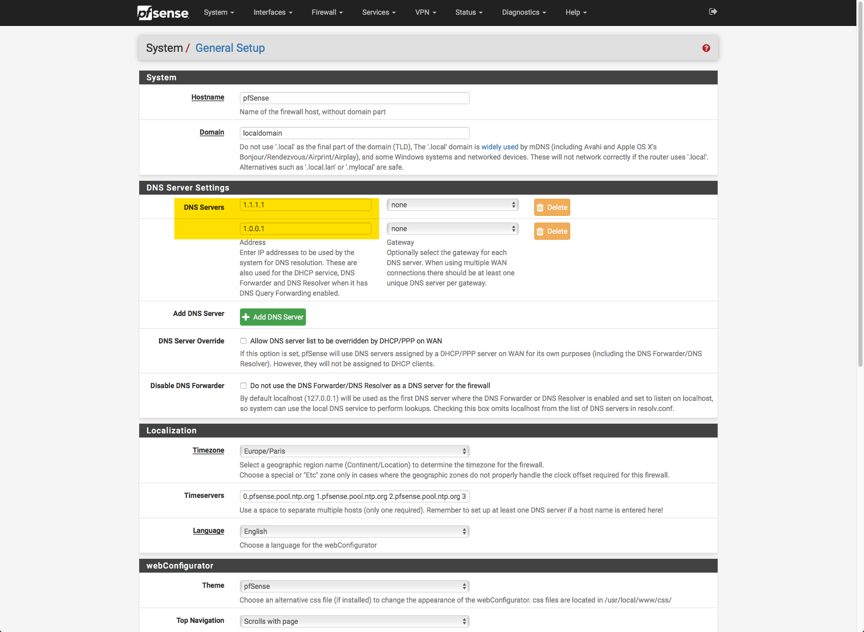

      5/ My PfSense General Settings finally point to the Clouflare servers (1.1.1.1):

        Pfsense should point to itself for dns.. ie 127.0.0.1.. If you want to use cloudflare vs resolve - then you would set that up in unbound - have it forward vs resolve. Pfsense would still point to itself..

          E.g. looking at the Resolver settings for instance, it seems to me I should check the 'Static DHCP' setting as well.

            If your setting up all yoru devices as dhcp reservations, ie static - then sure in unbound have it register your static stuff.
