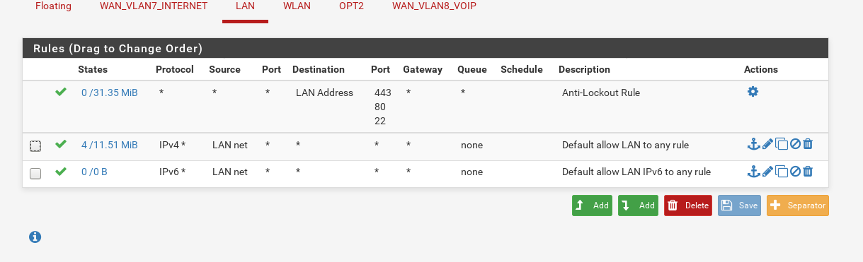

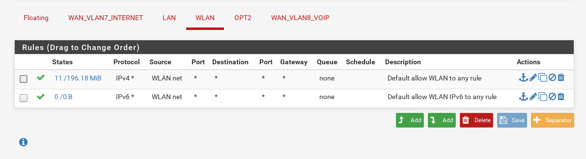

                  I really don't know why. The firewall rules are equivalent on both interfaces and allow each interface to any with protocol any.
