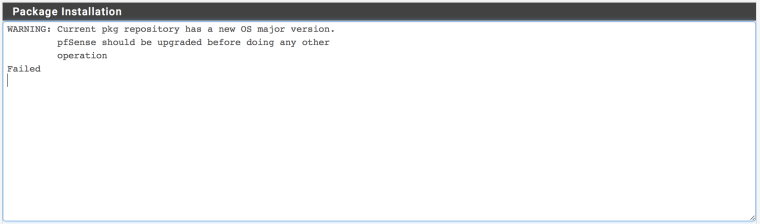

      • Z Offline
        zwoop
        Also, this is the error I get from the GUI when I try to install a package now after the reset. It's likely I did not have WAN access when I did the hard reset, so unclear what state I'm in...

            • jimpJ Offline
              Somehow your kernel is from 2.3.x and the rest (maybe?) is from 2.4.x.
              You should probably reinstall it from scratch, or, failing that, at least force an upgrade of everything:
              pkg-static clean -ay; pkg-static install -fy pkg pfSense-repo pfSense-upgrade; pkg-static upgrade -f

                • jimpJ Offline
                  I would take a backup before you do anything else. The system is in a broken state right now so anything you do is likely to help. Your choices are really:
                  1. The pkg commands above to force everything to update
                  2. Reinstall from a freshly downloaded image and restore your configuration
                  If anything offered a "downgrade" while trying the first step it's possible you were not pointed at the correct repository for updates. Make sure that under System > Update it is set to use the latest stable update branch.
