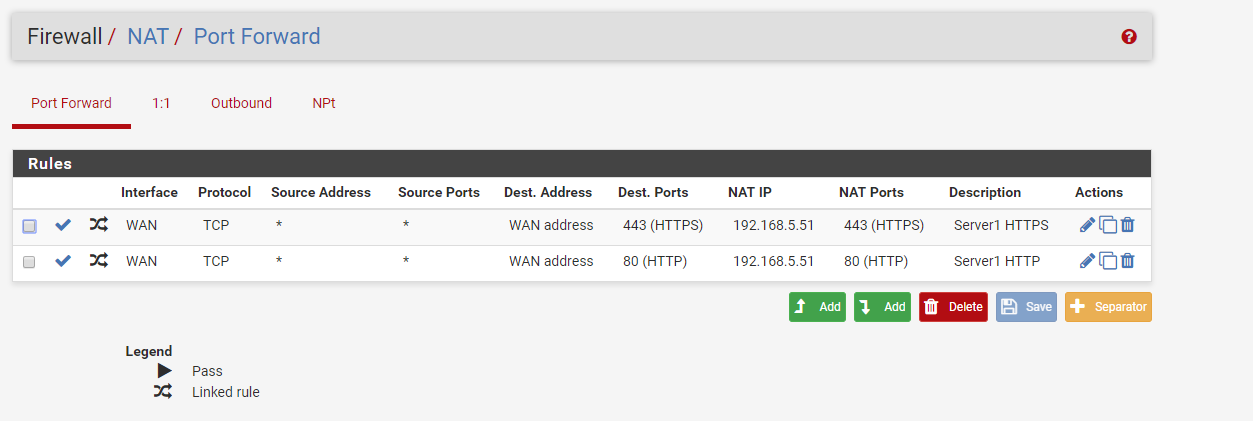

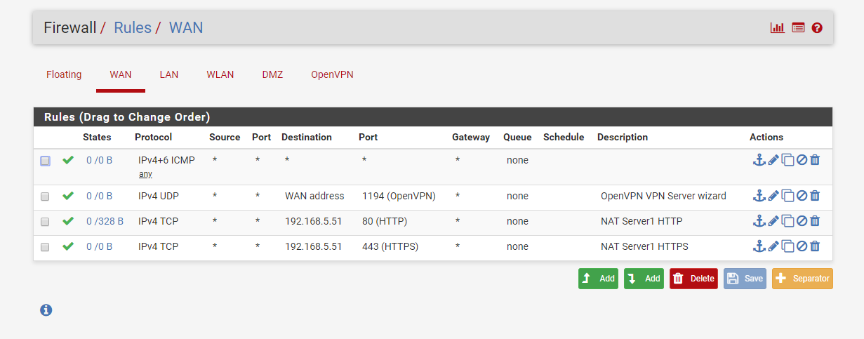

      I've my portforwarding set up as always and it has been working for quite a long time. But yesterday it stopped working, I've already checked everything and the problem is definitly the pfsense system. I already went though the troubleshooting guide (https://www.netgate.com/docs/pfsense/nat/port-forward-troubleshooting.html) and Nat reflection is enabled. I will post a pic. of all configs and Packet Capture.

                      That is still showing zero traffic sourced from the internet to destination 192.168.178.26 TCP port 80, which would be the Pre-NAT destination address and port for inbound connections. Without that traffic arriving on WAN, there is nothing to forward.
                      You would see something like this on WAN:
                      19:53:09.199222 IP 93.184.234.213.31156 > 192.168.178.26.80: tcp 0
                      It would look like this on LAN (after the port forward):
                      19:53:09.199222 IP 93.184.234.213.31156 > 192.168.5.51.80: tcp 0
                      Still leaves us at point 5 under common problems. Something upstream not sending the traffic to you.
