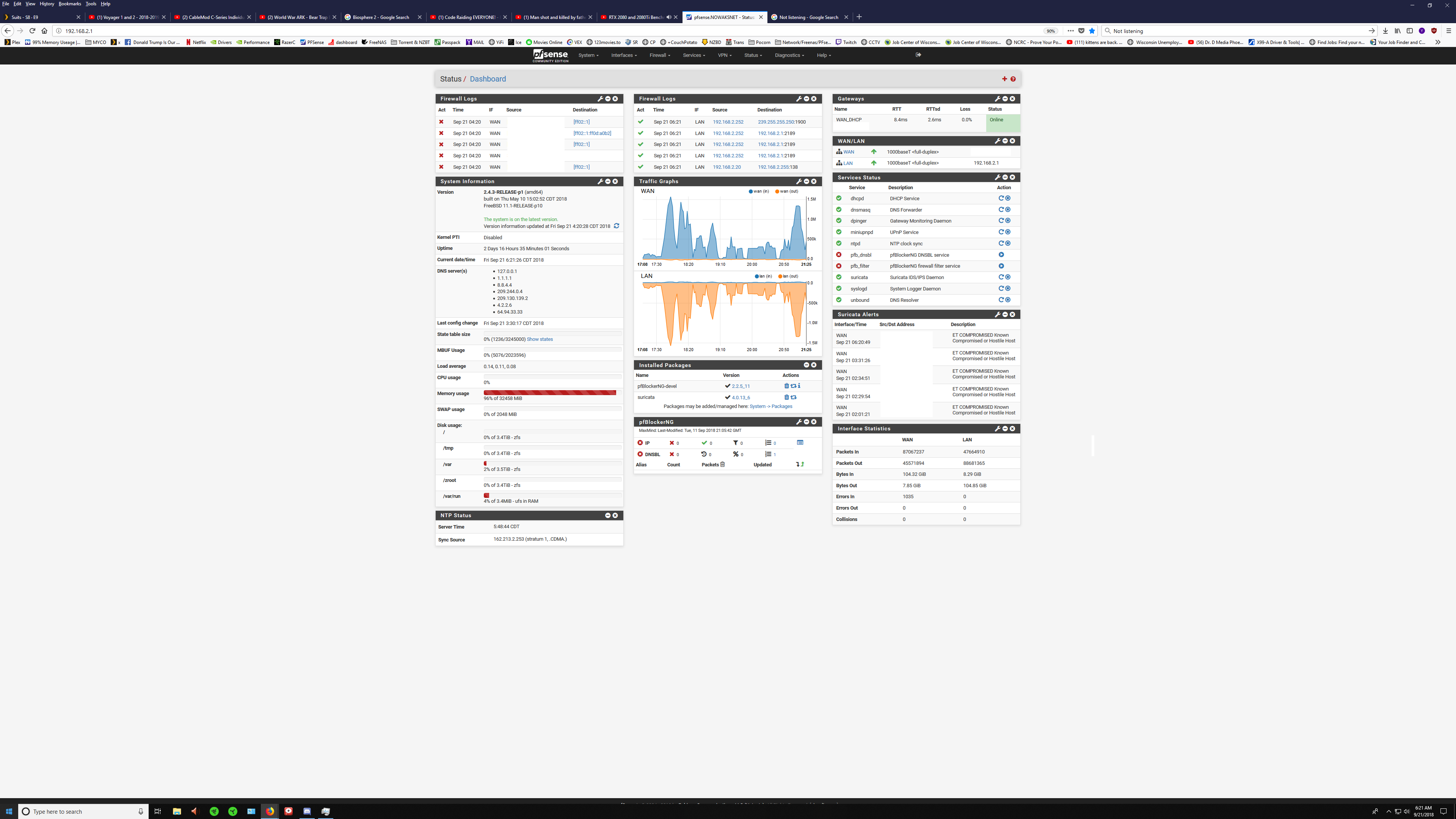

      So where to start well I have been running Pfsense for about 8 years now. the Problem I Am running in to is after a reset I get to about 99% memory Usage
      and the network become's unstable a restart or setting Ram dsik fix's this. I can set up a Ram Disk but it gets used up. If i set up a ram disk does not use all my memory. This was a fresh install then backup applied . What happend was I did a hardware swap and then had a bad disk.
      The hardware I came from was a Dell 2900v3 2x Xeon 4 cores Also due to to much power usage.
      That's when this Problem start the old system did have 58Gb ECC of Ram.
      New Harware Specs:
      AMD 6 Core FX-6300
      ASUS M5A99FX
      32Gb Crucial DDR3 ECC Non Reg
      4 Port Intel Nic
      3x2Tb HDD In Raidz1 Setup as a ZFS Raid.
      States are At Default setting so are Mbufs.
      Packages:
      Suricata
      PfblockerNG
      Removed: Squid Proxy to help with memory usage

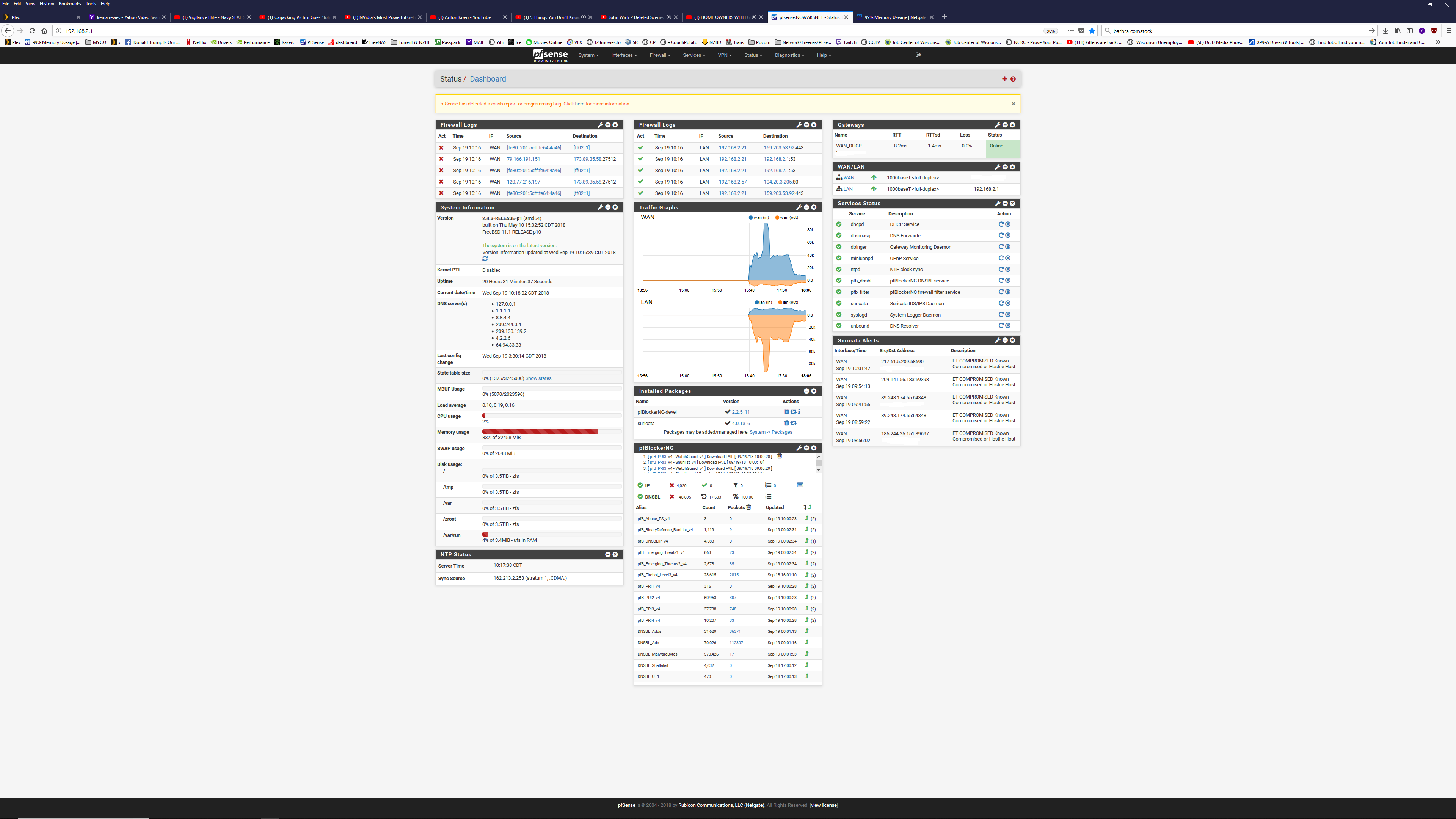

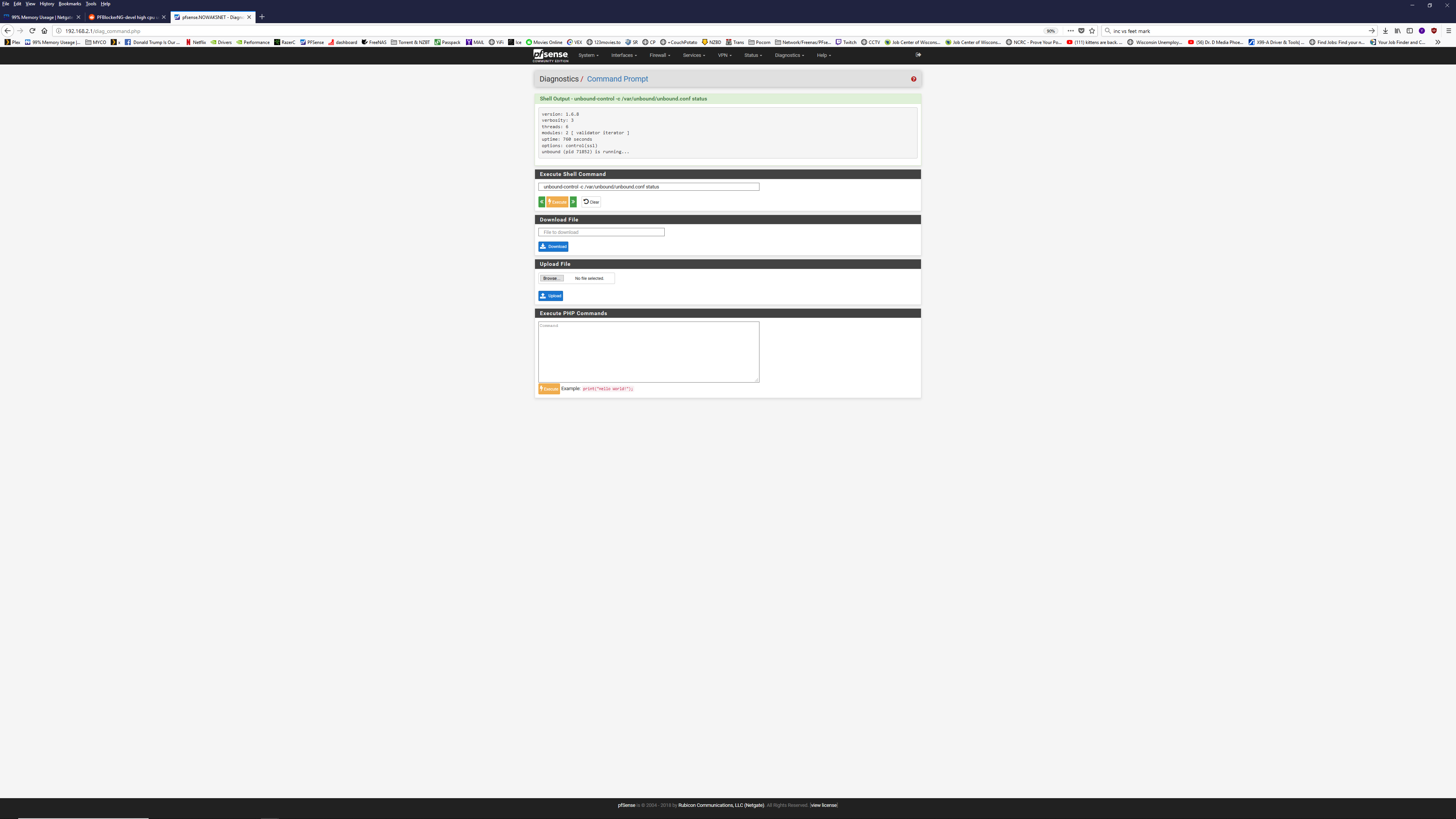

      0_1537293935875_pfsense.png 0_1537293944623_pf2.png !0_1537297437570_pf3.png

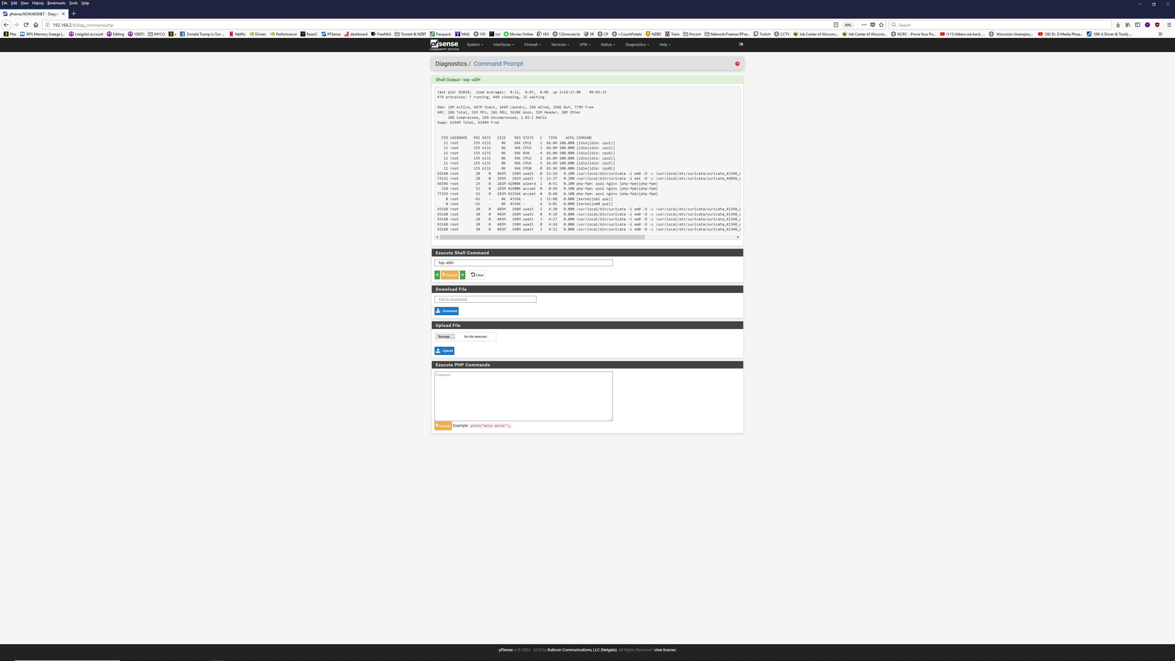

                        Also try running the following top command:
                        top -aSH
                        "Experience is something you don't get until just after you need it."

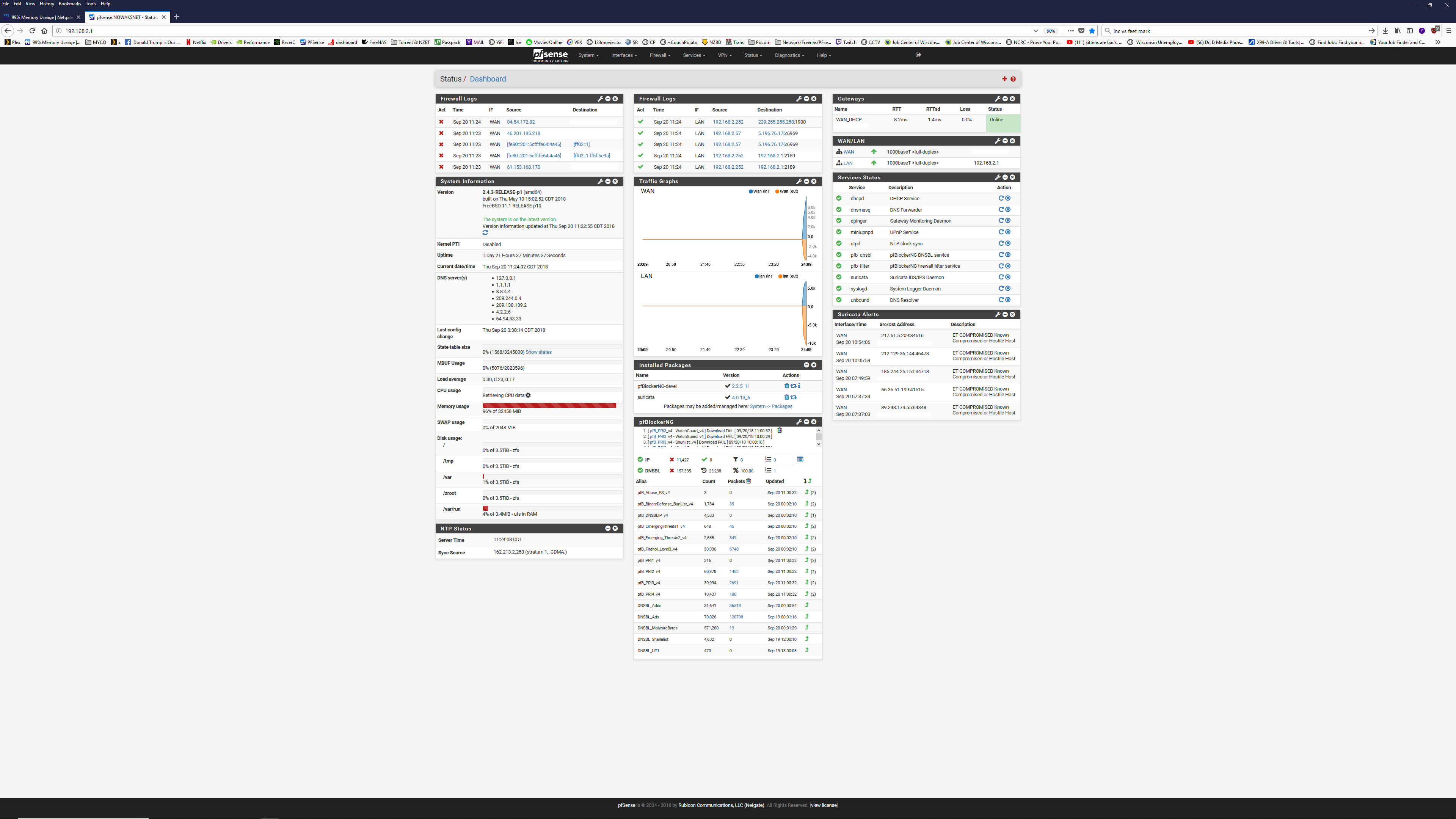

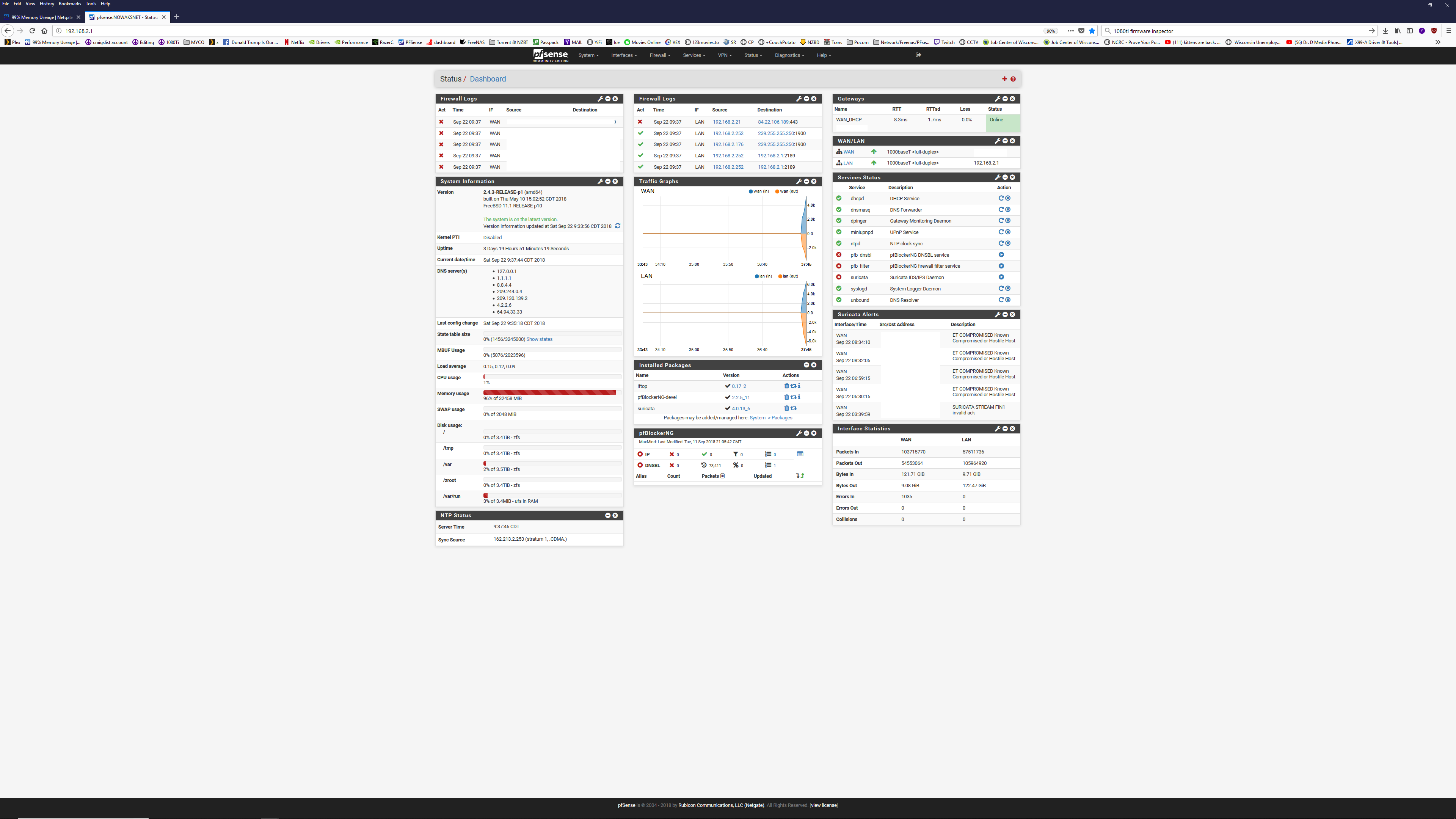

                          • SnowaksS
                            Snowaks
                            PFblockerNG Off for 1 day still showing 90% Plus
                            • SnowaksS
                              Snowaks
                              @bbcan177 said in 99% Memory Useage:
                              top -aSH
                              I mist your command as it was in black.
                              • X

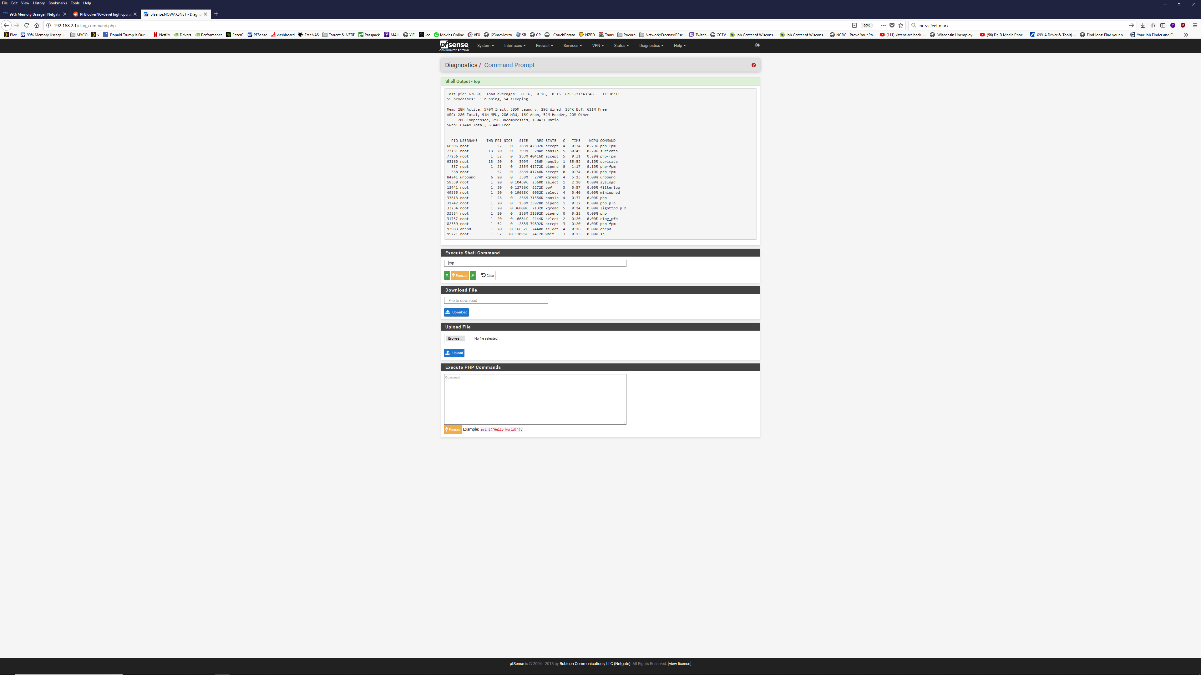

                                Are Your sure it's not Surricata eating all the RAM?
                                P.S. - You could install htop with "pkg install htop". Might need a reboot to work(for me at least). There you can check in real time what's going on.

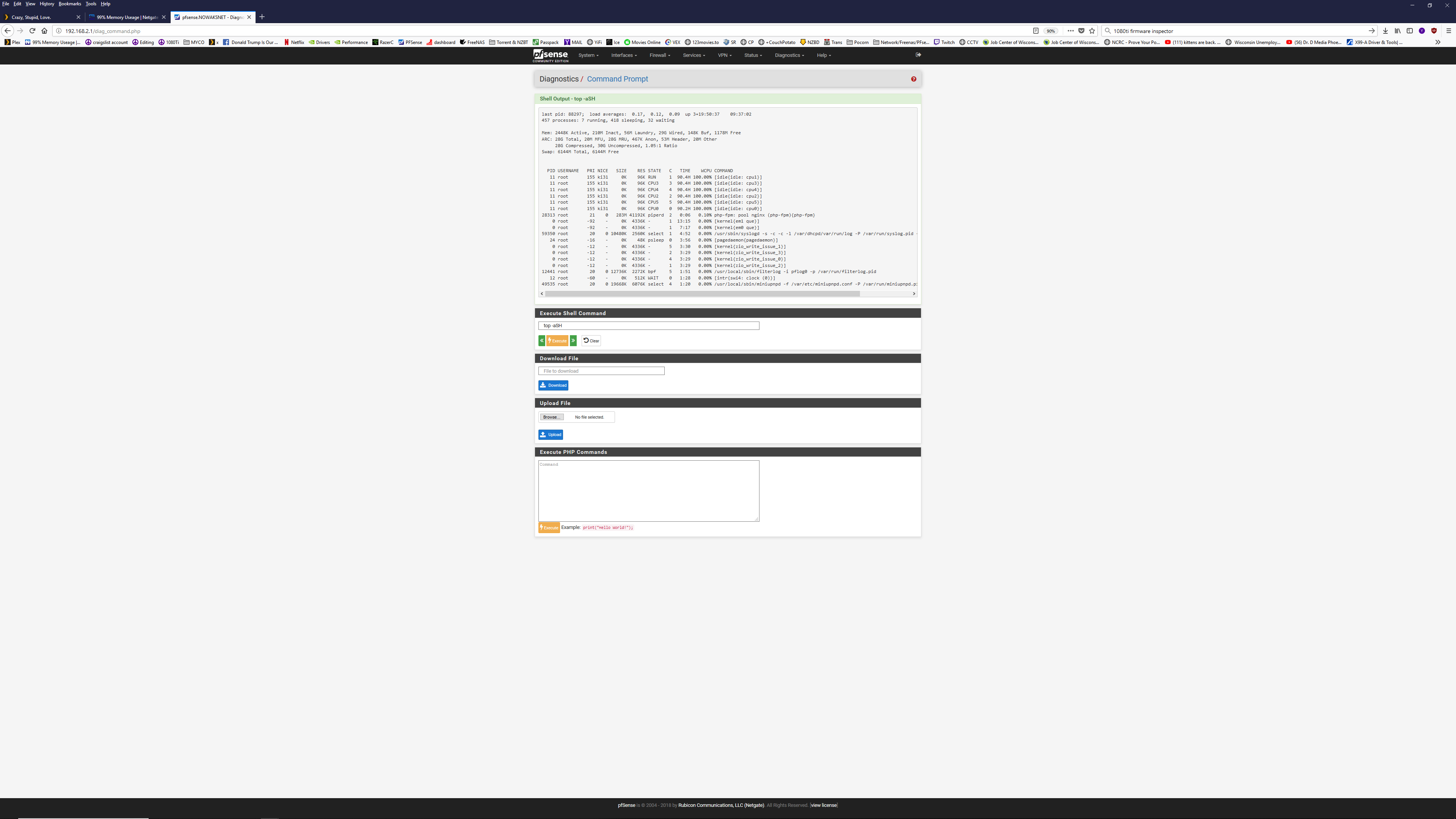

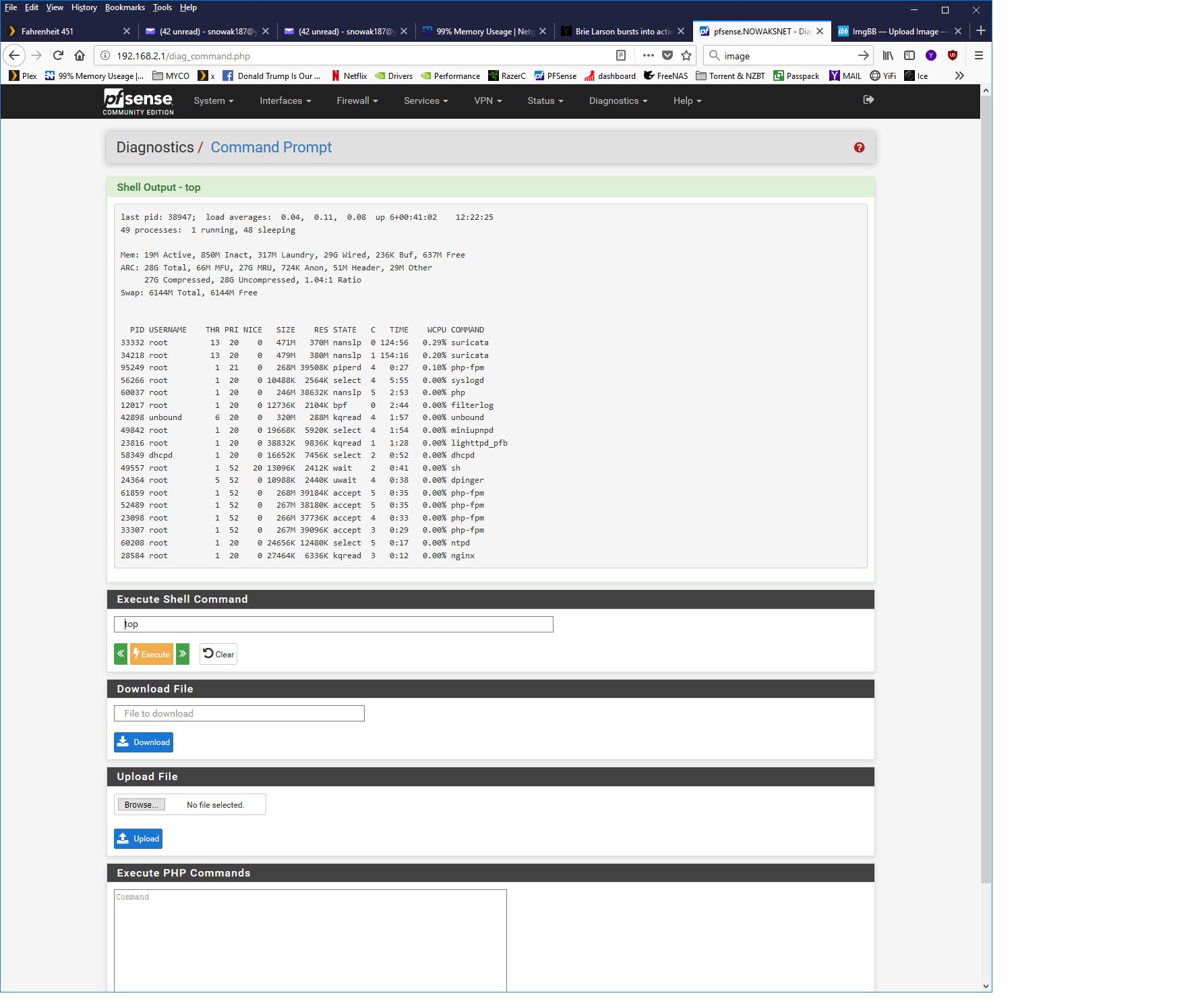

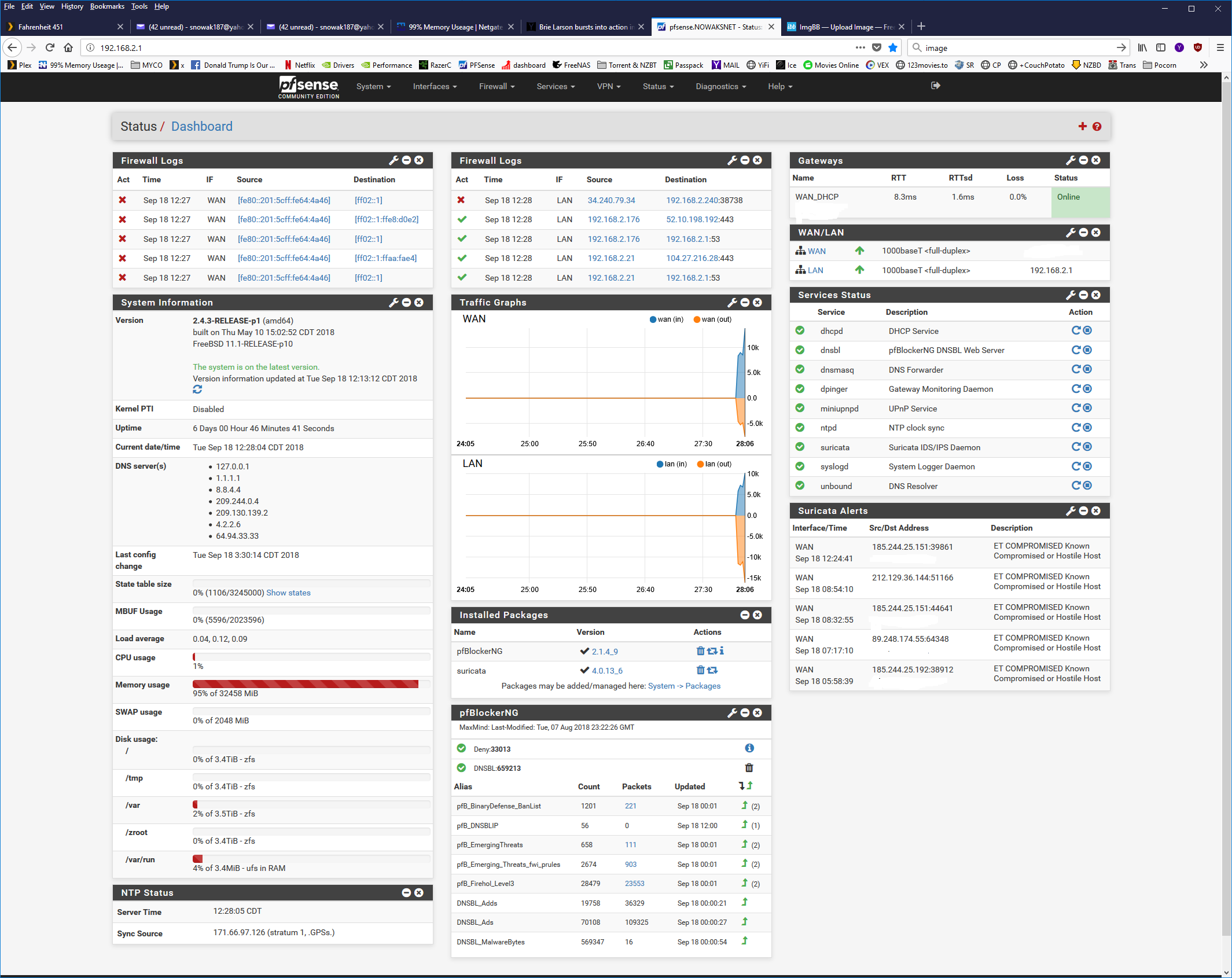

                                • BBcan177B
                                  BBcan177 Moderator
                                  @xciter327 said in 99% Memory Useage:
                                  Yes its definately Suricata .. you can see several PIDs for the same interface...

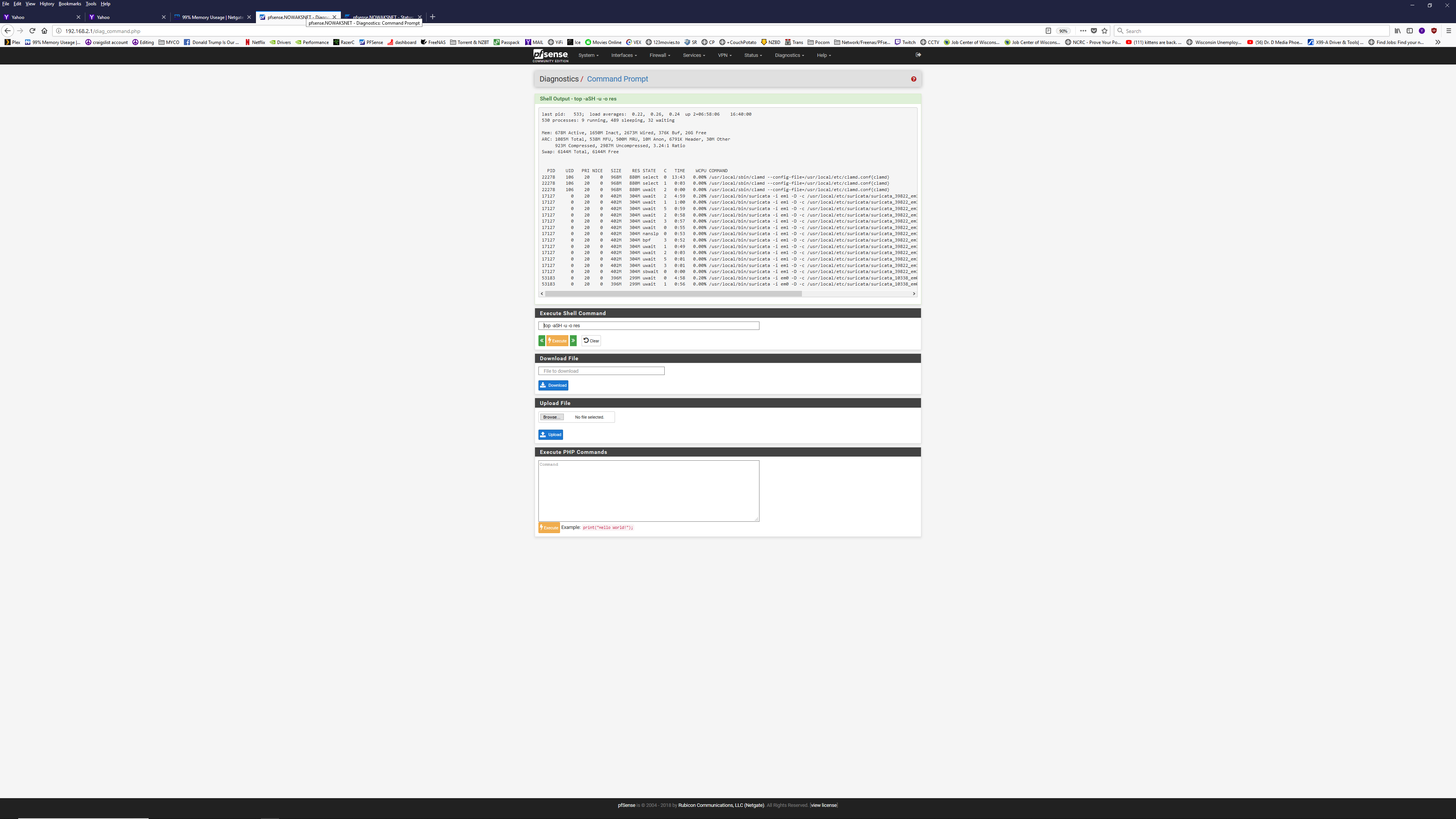

                                    • SnowaksS
                                      Snowaks
                                      @snowaks said in 99% Memory Useage:
                                      top -aSH
                                      • X
                                        xciter327
                                        With Suricata disabled, do a reboot to make sure it's all clean.
