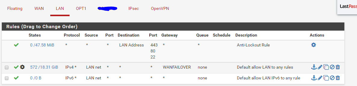

I have my outbound LAN rule setup to use the gateway group. I do get an error in the notifications I'm not sure if it's relevant or not, it can be seen in the notification below.

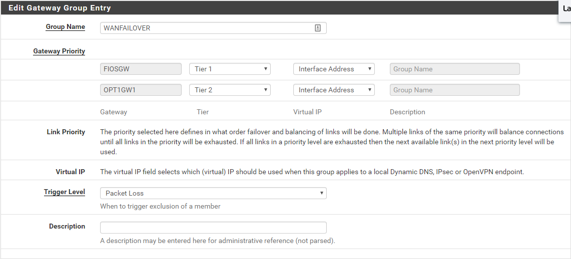

23:03:54 DynDNS updated IP Address on OPT1 (igb2) to 2.2.2.2I've tried 'member down' in addition to the 'packet loss' show below for trigger level.

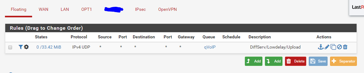

I have tried disabling this floating rule below. It was generated by the traffic shaping wizard for voip.

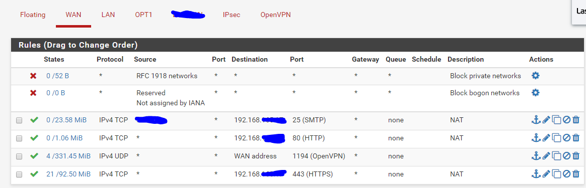

I would like the internal resources be available even when on the backup internet connection, so I have rules setup for both interfaces, I imagine this would be cleaner accomplished with floating rules also?
