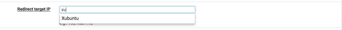

              I chose to use the Alias because it was the only thing I could get NAT "Redirect target IP" to accept:
              You can see pfSense makes it available in a drop down selection.

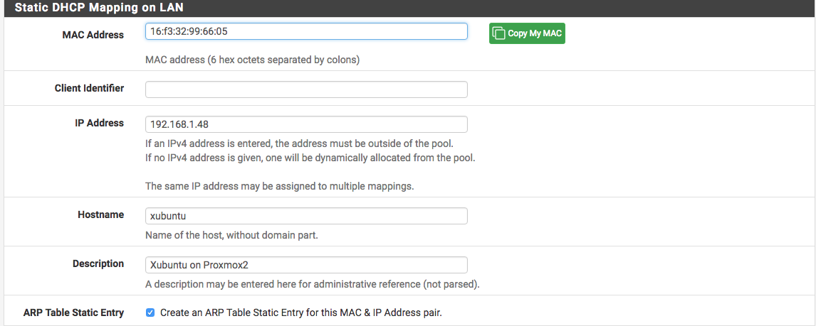

              I had previously set that machine in DHCP Static mapping except I did not append the domain because it says not to below the text box:

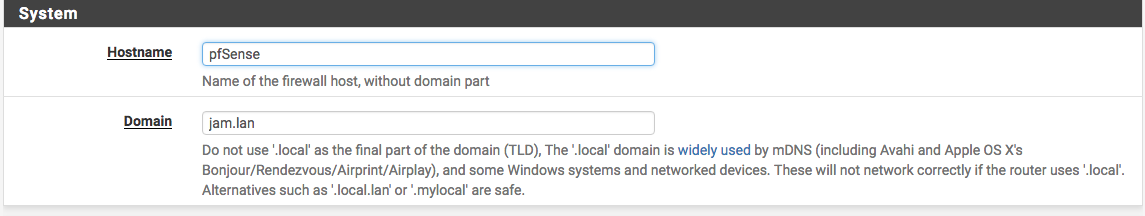

                    This is what I have always had for my pfSense name and domain:
                    Did you test within your LAN or through your WAN? Mine has always worked within the LAN but will not work from my WAN unless I change the: "Redirect target IP" from the Alias name to the actual IP address of the machine...then it will work from the WAN.
