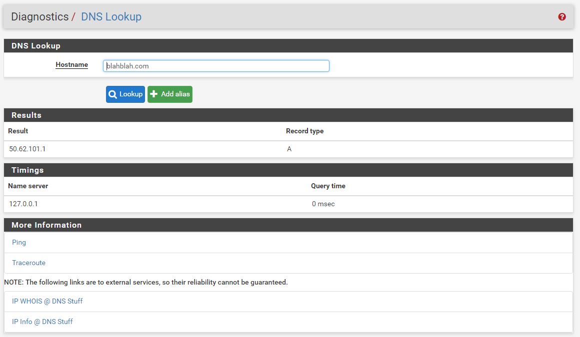

I've been trying to figure out how my unbound DNS server is doing in terms of query timing. I have been noticing some delay when loading up non-cached sites. I know it's normal for it to take longer, but call me crazy, I like test results rather than "it seems slow" or "it seems ok".
I tried namebench and DNSbench but I think there is too much going on across my LAN for reliable results. Every time I try DNSbench it tells me (paraphrasing) there are more than 20% failing servers and it's likely due to traffic on my LAN, therefore the results are invalid.I then tried the DNS lookup under diagnostics, but no matter what I lookup the Query time is 0 msec. I even tried a bunch of random sites I knew (or thought) wouldn't be cached and it still came up as 0 msec. I know my server is not that good. What's going on? And how can I get a reliable benchmark of DNS queries on a live office LAN?

I forward to external DNS (MS AD) and my times bounce between 14-38ms. This might be a gui glitch when using the resolver locally.
Thanks @KOM , that's good to know. Those numbers sound like very good times for a query. That gives me an idea of what a decent setup should be getting me in the ballpark of. I remember at some point doing the DNS lookup and getting varying numbers as one would expect. That was a long time and many updates ago, so a GUI glitch sounds about right. Is there a command line equivalent of the DNS lookup?
