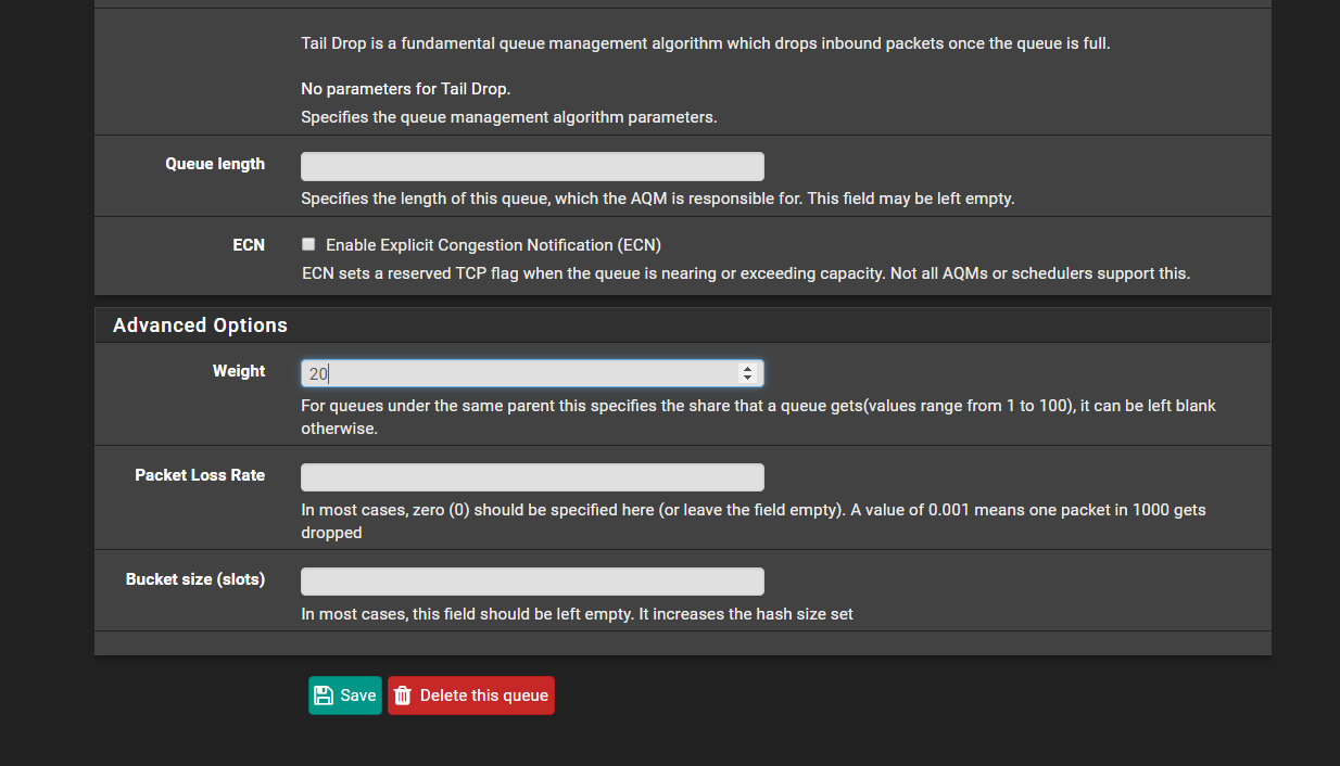

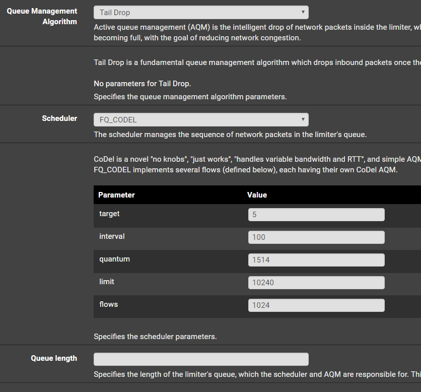

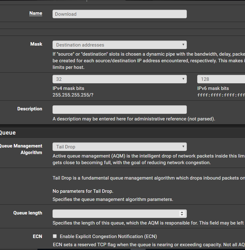

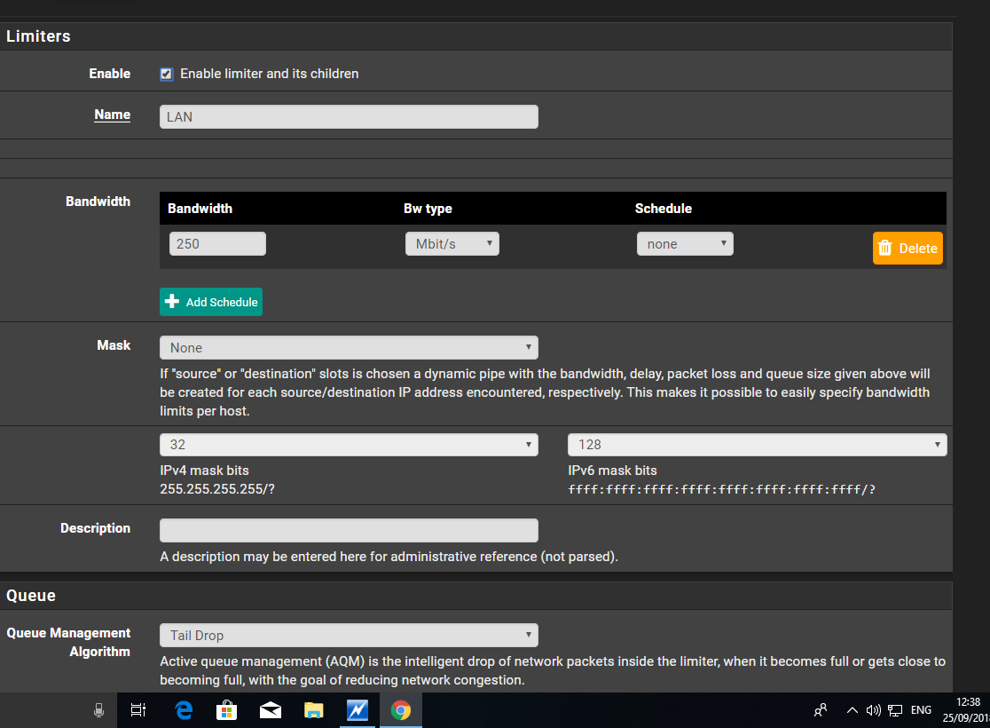

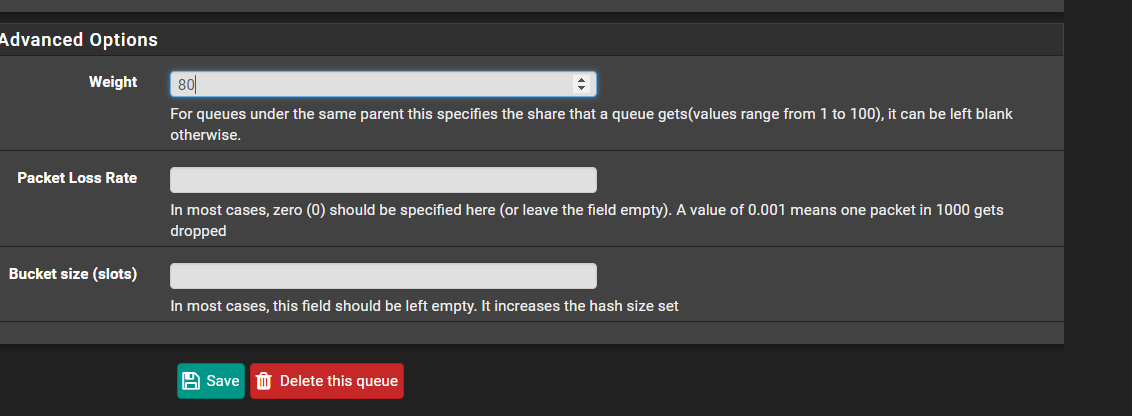

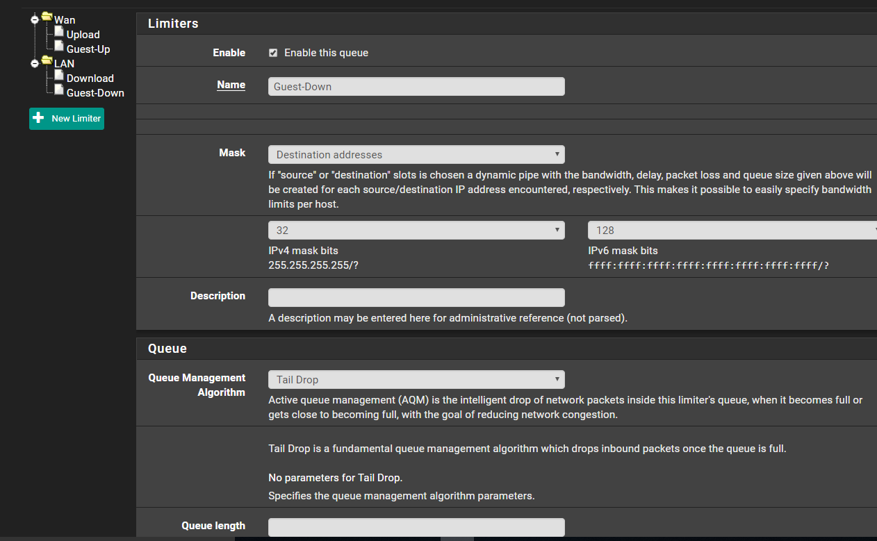

      I am trying to make a guest vlan get full speed but when land is using bandwidth vlan gets example 30 percent of bandwidth but when I test this out the bandwidth split evenly. This is what I am doing
      Create a limiter Download
      enable it
      250mbps
      fq_codel
      Create a child limiter
      enable it
      destination address
      weight 80
      second child
      enable it
      destination address
      weight 20
      So choosing the child limiter with 20 weight in the guest firewall rule vlan the vlan still can split the bandwidth evenly with the LAN. Is there something wrong with my rules?

        FQ_codel does not allow priorities/weights, you should use QFQ scheduler + Codel queues.
