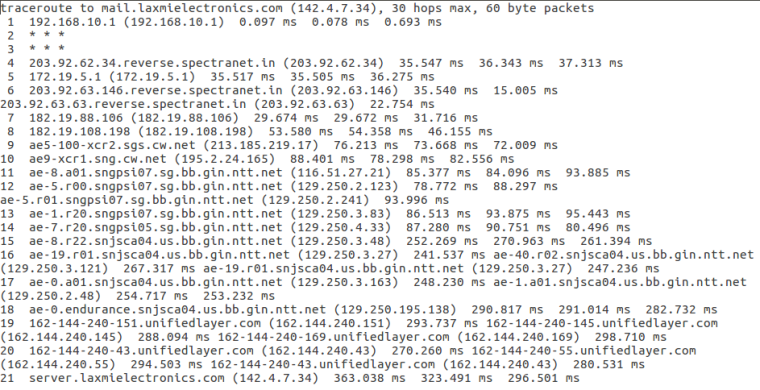

            Traceroute Output.
            LAN Traceroute
            Marketing Traceroute
            Purchase Traceroute
            Lokesh Kamath

              Does it work when you did those traceroutes?
              S 1 Reply Last reply Oct 8, 2018, 9:35 AM Reply Quote 0
              • S
                slkamath @johnpoz
                @johnpoz
                Thank you.
                Yes it is working when i give traceroute mail.laxmielectronics.com.
                Lokesh Kamath
                • J
                  Well there you go then you have your root cause - users not using your connection when they fail ;)
                  The HUGE delays in that network could be a problem, or more than likely that isp they are going out blocks outbound 25.. If that is the port your talking to vs say 465 or 587 which are typical ports talking to smtp server when using encryption..
                  So now you need to figure out why that one that was failing was using that other network..
                  S 1 Reply Last reply Oct 8, 2018, 10:14 AM Reply Quote 0

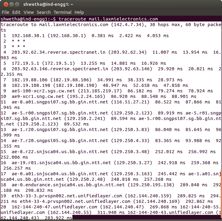

                        Yes, we need to see a traceroute from a machine on one of the affected subnets when it is NOT working.
                        If you see no hops at all when you try that then check the connection information. Most likely it is no longer using pfSense as it's gateway.
                        S 1 Reply Last reply Oct 9, 2018, 10:20 AM Reply Quote 0

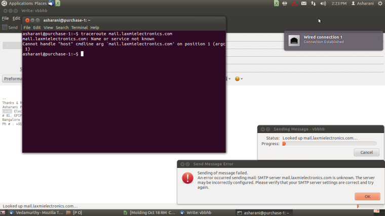

                          If VLAN Clients are idle for 10 to 15 min we are facing the issue of disable & enable network.
                          Please find the below picture for better understanding.
                          Marketing-VLAN
                          When it is not working if i run traceroute command
                          Before Disable & Enable Network
                          After Nework Disable & Enable (in Picture you can see wired connection connected)
                          Traceroute After Nework Disable & Enable
                          Purchase-VLAN
                          Before Disable & Enable Network. Printing also holding. In picture you can see the print icon
                          Printing is completed After Nework Disable & Enable
                          Traceroute Output after Nework Disable & Enable

                            So from that you can not just resolve it?
                            Can your clients resolve anything? Do a simple nslookup or dig for mail.laxmielectronics.com
                            Can you traceroute to its IP vs its name.. 142.4.7.34, Can you ping IP of pfsense - oh prob not because you are not even allowing basic icmp for troubleshooting..
                            And lets go over this yet AGAIN!!!~~ your rules are pretty much pointless... Those allow rules mean zero when below them you have an ANY ANY... Other than you saying your limiting bandwidth on that rule? Is that the case?
                            So your clients are pointing to DC for DNS? Thought you removed them? Where do the DCs get their dns - do they forward do they resolve? What network segment are they in? What are their rules for outbound to dns if resolving.
                            When you enable/disable the interface - what was it before?? Do a simple ifconfig output.. What was your IP of this device? What was its routing, do a simple netstat -nr

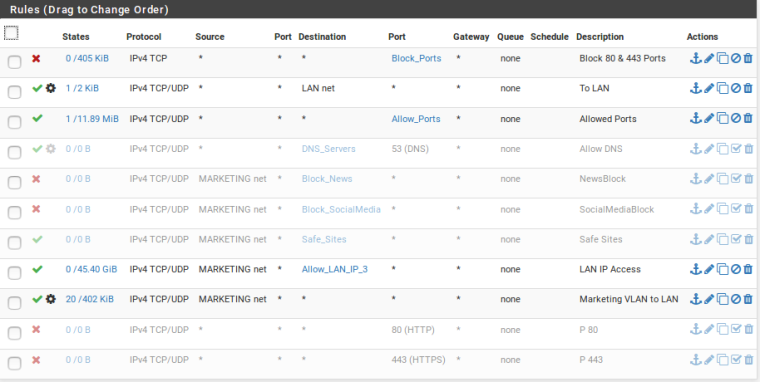

                                Thank you very much.
                                Rules of Marketing-VLAN

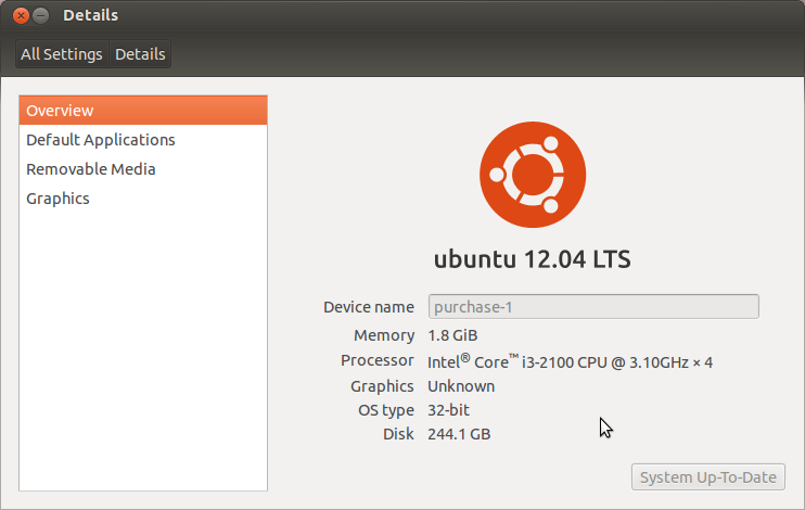

                                System Info
                                Marketing
                                System Info

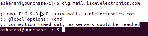

                                DIG & NSLOOKUP
                                Marketing - - - -> dig mail.laxmielectronics.com & dig 142.4.7.34
                                DIG & NSLOOKUP
                                Purchase - - - -> dig mail.laxmielectronics.com & dig 142.4.7.34

                                • J

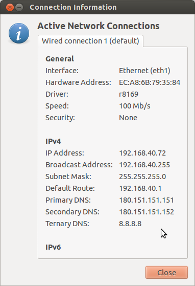

                                  So your pointing to local cache for dns... Doesn't actually tell you where your dns points to...
                                  When did I ever say do a dns lookup of the IP?? Dude - how are you in this field??? I don't need to see every freaking screenshot when it works!!! Or doesn't work for gosh sake... Can you not take basic info and understand what is happening??
                                  I you can not resolve the name - then NO shit your never going to get there..
                                  You need to figure out WHY you can not resolve.. Is your local dns cache is failing or the actual dns?? Do a simple nslookup for the name to the actual dns server vs the local cache.. of 127.0.0.1
                                  Pfsense is your dns right??? So
                                  dig @ipaddressofpfsenseforthatvlan mail.laxmielectronics.com
                                  If that fails - then WHY????? That is your problem...
                                  • S

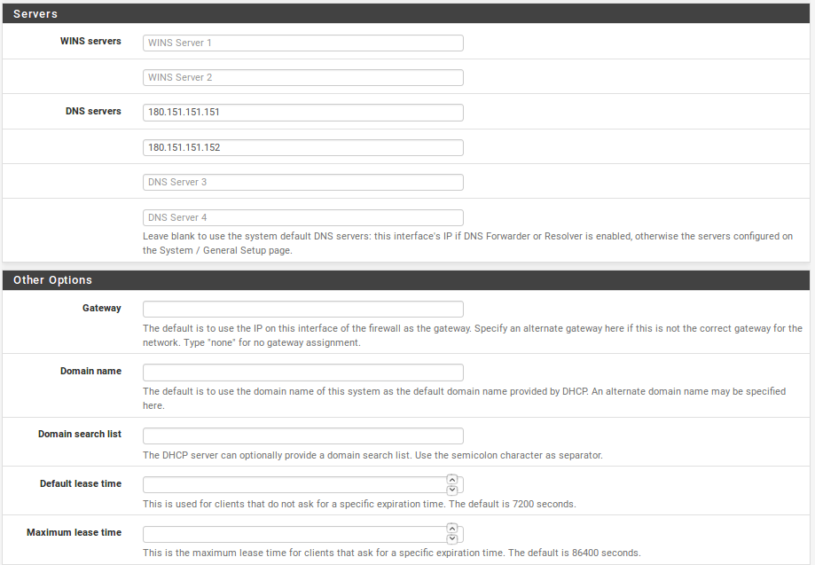

                                    Ok, so I think what you are showing there is that the machine in the Marketing VLAN is working and the machine in the Purchase VLAN was not able to resolve the mail server until you disabled/enabled the adapter, right?
                                    Both those machines are configured to use external DNS servers. If that Connection Information screenshot was taken when it was not working it looks OK though. So you have some DNS issue.
                                    Is there some reason you're not handing out the interface IP as DNS in DHCP?
                                    Also both those machines are now out of date, the one in Purchase by a long way!
                                    S 1 Reply Last reply Oct 12, 2018, 4:47 AM Reply Quote 0

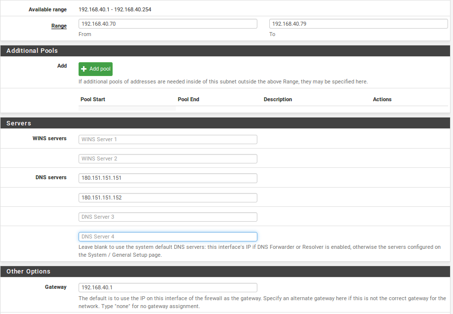

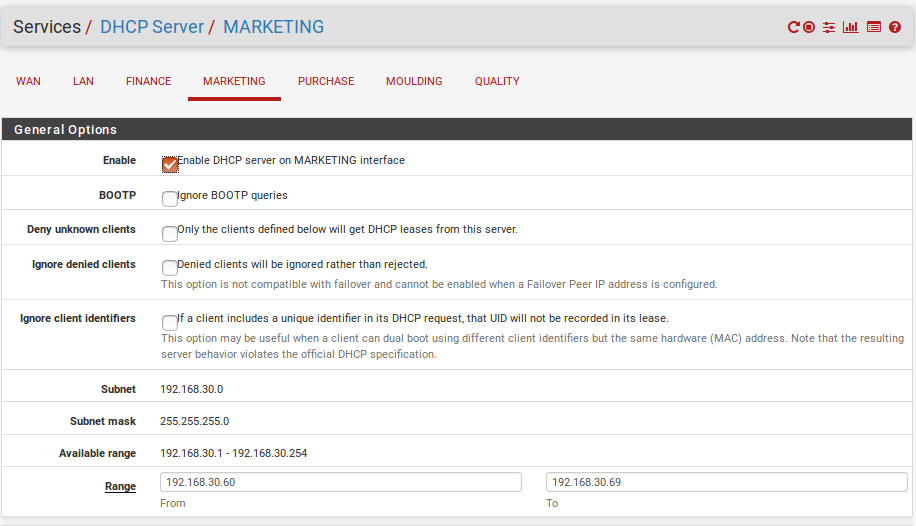

                                      @stephenw10 @johnpoz

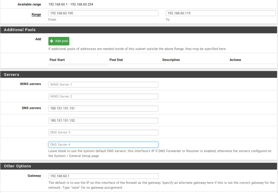

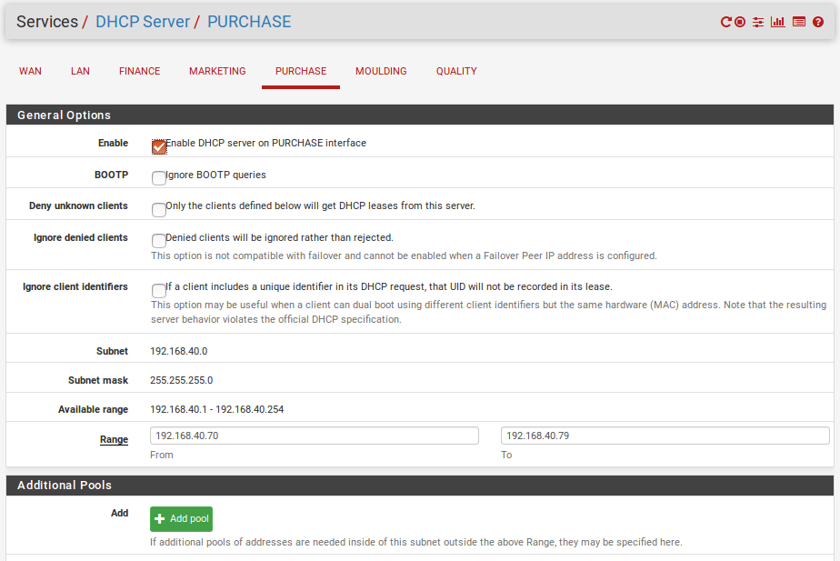

                                      I think initially pfsense IP (192.168.10.1) was not been set as DNS. Now I removed External DNS fom LAN & VLAN and kept blank. Now I am getting Primary DNS as pfSense IP.
                                      dig 192.168.10.1 mail.laxmielectronics.com
                                      did this from Purchase-VLAN and i am getting answer for both.
                                      dig 192.168.40.1 mail.laxmielectronics.com
                                      I did some changes:
                                      1. Removed External DNS from LAN.
                                      2. Now LAN IF CONFIG - IP: 192.168.10.2 SUBNET: 24 Gateway: 192.168.10.1 Primary DNS: 192.168.10.1 (No Secondary DNS) I think now pfSense is pointing as DNS
                                      3. Removed External DNS (ISP Provided) from all VLANS.
                                      4. Now VLAN IFCONFIG - IP: 192.168.30.60 SUBNET: 24 Gateway: 192.168.30.1 Primary DNS: 192.168.30.1 (No Secondary DNS)
                                      5. Firewall VLAN Rules did few changes. (Same for other VLAN too)

                                        @slkamath said in How to assign Domain Controller to VLAN Systems:
                                        Your clients that are members of AD... Ie you have domain controllers should be pointing to your DC that running dns for your domain.. This will be the authoritative NS for your AD.. And have all your AD records in it..
                                        This or these NS if you have more than 1 running your AD dns will either forward or resolve any domains it is not authoritative for.. Member machines of AD should always point to the NS for your AD.. That would not be pfsense out of the box running unbound.. You could prob do with the bind package.. But when you have AD, it makes little sense to not just run DNS for on one of the DCs if not multiples of them.
                                        Pointing client machines to more than 1 NS that can not resolve the same stuff is going to lead you to nothing but problems since you can never be sure which NS your client is going to ask for specific query.
                                        If your clients were pointing to multiple NS and 1 of them could not resolve your smtp servers fqdn, then yeah a reset of the interface would prob force it to query the 1st vs the 2nd, etc. Or who knows how you had them setup..
                                        If your going to point your clients to pfsense for dns and you running an AD, your going to want to make sure you setup all the domain overrides for your AD dns, or your going to want to make sure pfsense points to your AD nameserver(s)..
                                        S 1 Reply Last reply Oct 12, 2018, 5:41 PM Reply Quote 0
