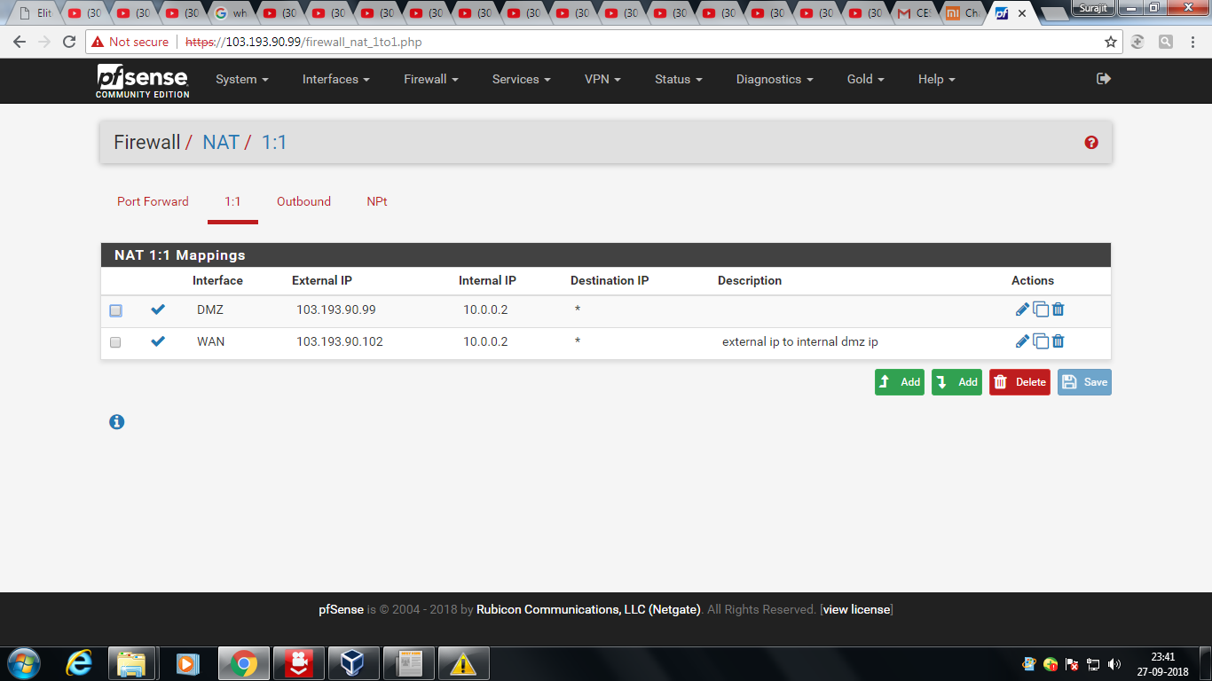

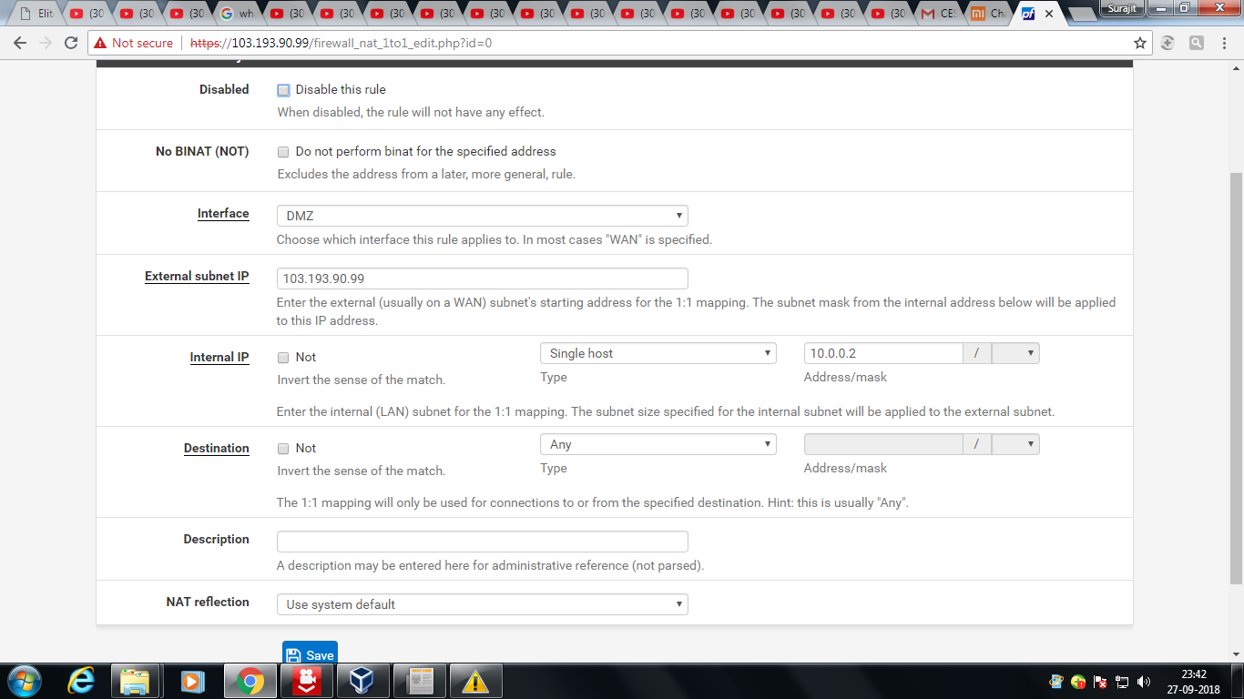

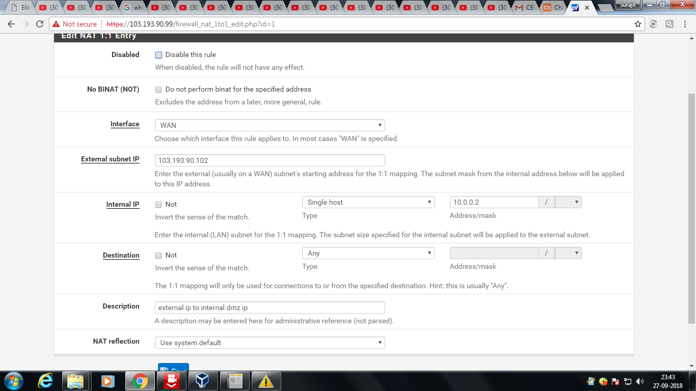

      3_1538073734786_NAT.png 2_1538073734786_inside the NAT2.png 1_1538073734785_inside the nat1.png 0_1538073734776_dmz rule.png Hello everyone
      I am using 2.35 version.I am having problem that my server under the DMZ network, not getting the internet.I can ping my firewall, I an access my server using ssh very smoothly, but that server itself is not able to accessing the internet.
      Need help as soon as possible.[4_1538073702254_Network Diagram.docx](Uploading 100%) ![3_1538073702254_NAT.png](Uploading 100%) ![2_1538073702254_inside the NAT2.png](Uploading 100%) ![1_1538073702253_inside the nat1.png](Uploading 100%) ![0_1538073702252_dmz rule.png](Uploading 100%)

        Why do you show 1:1 NAT? If you want access the Internet from any of your Networks (LAN, DMZ, ...) you don't need 1:1 NAT...
        Are you in Manual NAT Mode and missing the DMZ net? Show your Outbound tab please.
        Your pfSense Login Portal is open to the whole World, do you know that?
