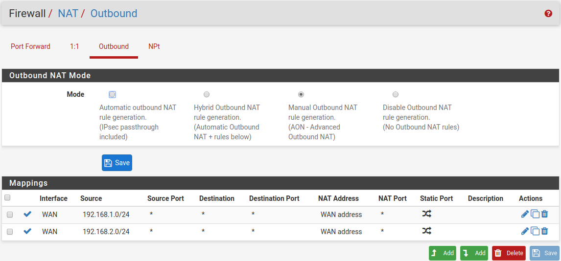

      So I'm trying to create a setup that has a single WAN in which has a few public IP's available which should bridge over to what i have called "Statics", which is just OPT2 which will go to a switch that needs to simply work as a transparent firewall.
      I then have 2 dhcp networks, one called DHCP and one called Phones which are just a simple NAT'd dhcp addresses for internet access which works fine.
      The static bridge however I can't seem to get working despite everything I've read on the internet, I've created the bridge and disabled NAT for that range (at least I think so) and the virtual machine I have on the static adapter get's an IP address from my router but the traffic simply isn't routing.

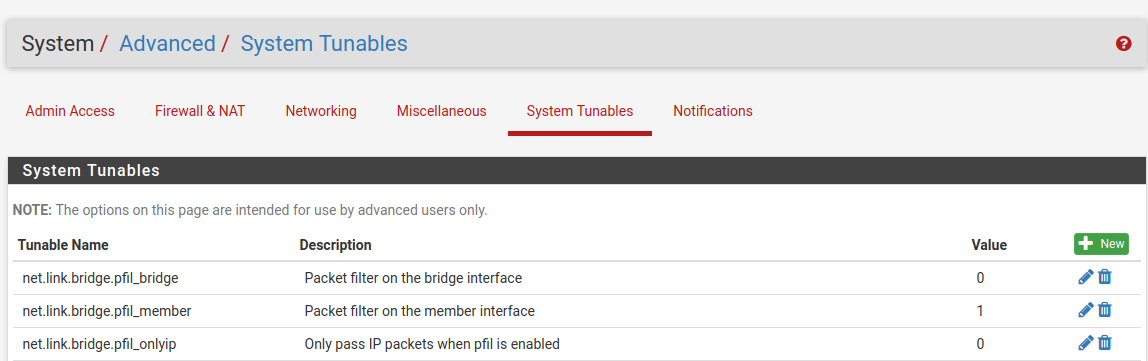

      I've attached a screen grab of what I think are all the relevant parts but I'm still not getting traffic across the bridge even though DHCP seems to go across fine :/ I've tried all sorts of configurations with the tunables but not getting anywhere
      Obviously I've added firewall rules to allow all from all on each interface. Any ideas would be fab :)

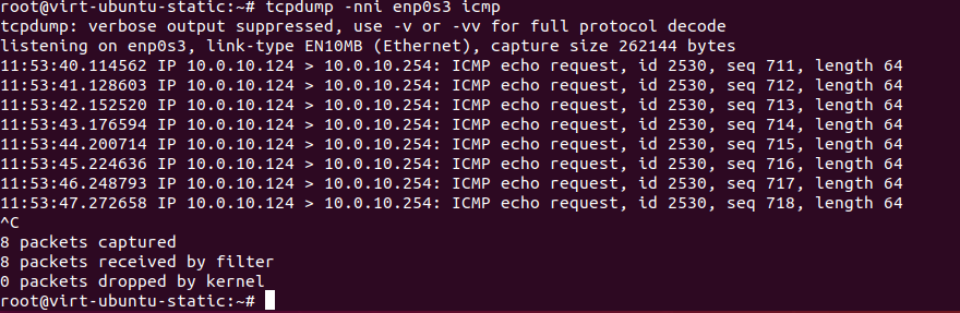

              VM tcp dump for icmp:
              I am i right in thinking that incoming flow from WAN to the Statics is what's failing? Are there other diagnostic steps I can take to work this out?
