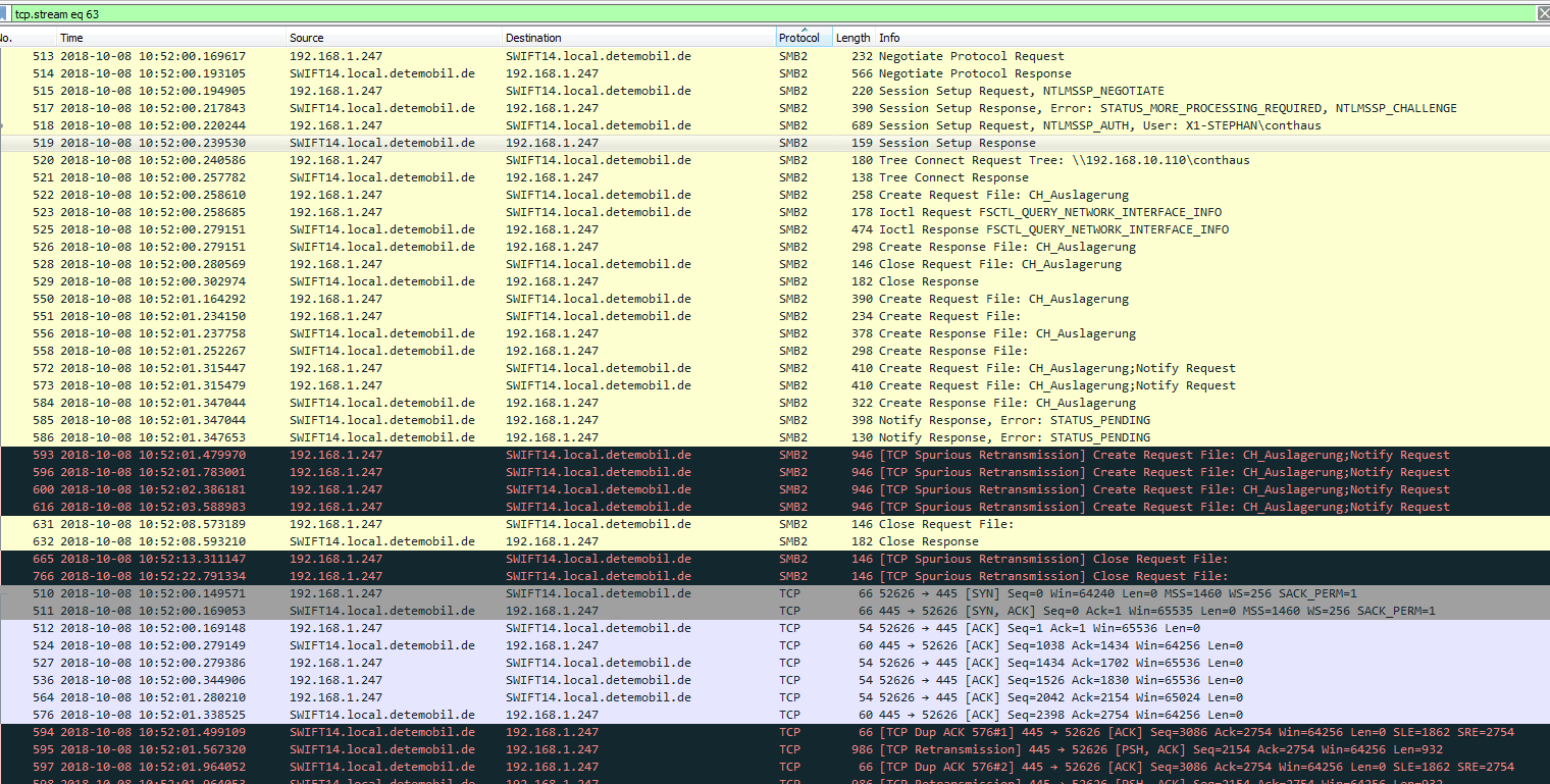

                Thank you NogBadTheBad, but since the shares work when i am in the same subnet (physically), do you thinbk it really can be the abandonment of smb1?
                Thank you very much johnpoz, i upload the pcapng-file. My local machine in my homesubnet (site-home: 192.168.1.0/24) is 192.168.1.247, the pfsense-home is on 192.168.1.250, the router on 192.168.1.1. The machine i want to reach in the office-subnet (site-office: 192.168.10.0/24) is 192.168.10.110, the pfsense-office is on 192.168.10.250 and the router is 192.168.10.1.
                So do you think the RST is sent by one of the routers (or should i better call them gateways?)?
                I hope you can help me further!

                    Looks like you auth fine - but there there is some sort of problem for sure See all the retrans..
