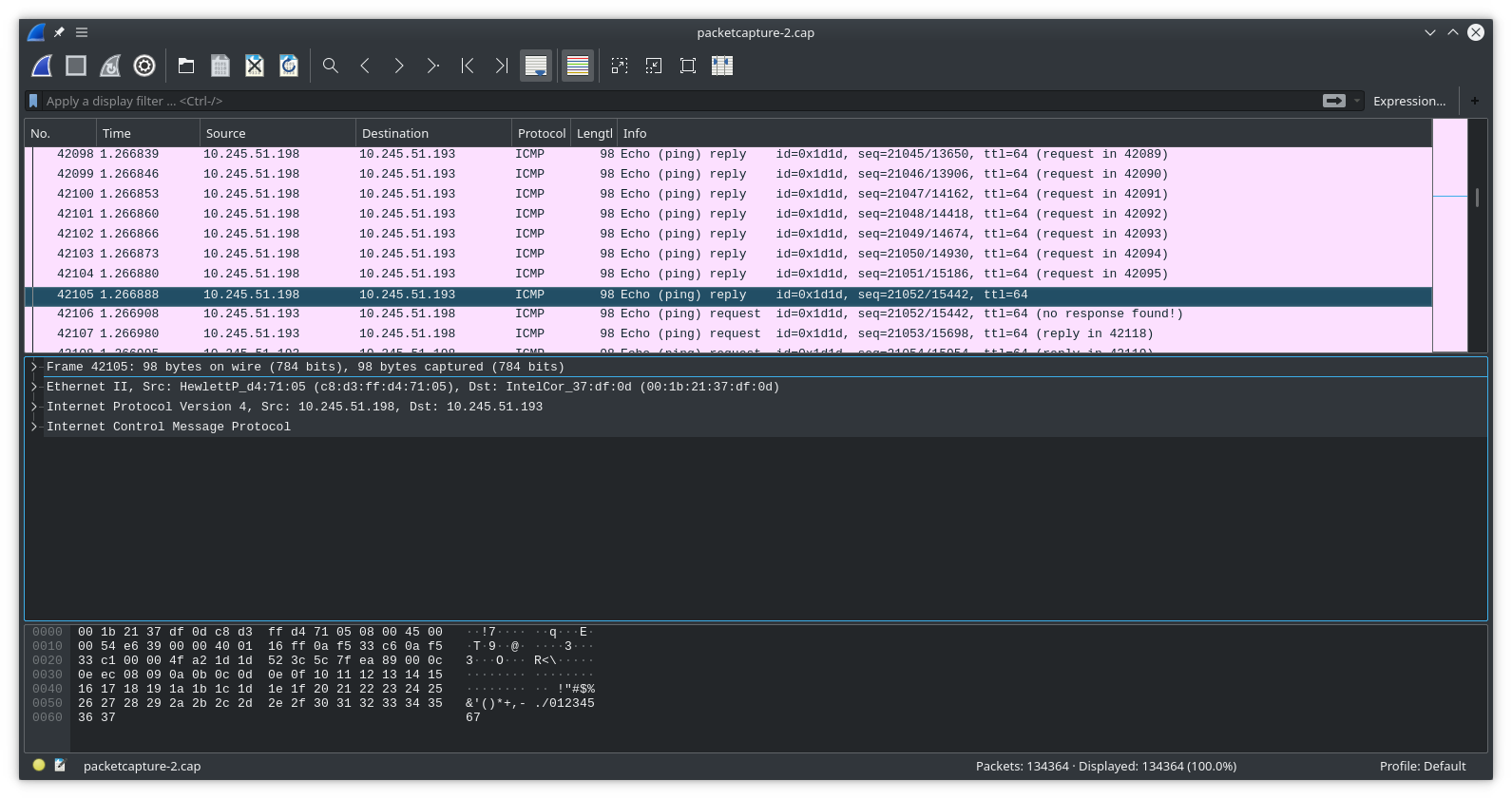

                        coque @stephenw10
                        @stephenw10 This is getting really weird. Now we get around a 0.1% of packet loss (53 packets over 3 seconds), according to the ping output:
                        [2.4.4-RELEASE][admin@firewall]/root: ping -f -t 3 -W 10 10.245.51.198
                        PING 10.245.51.198 (10.245.51.198): 56 data bytes
                        --- 10.245.51.198 ping statistics ---
                        67182 packets transmitted, 67129 packets received, 0.1% packet loss
                        round-trip min/avg/max/stddev = 0.048/0.190/1.167/0.087 ms
                        However, in the capture taken from the pfSense we see all the answers, but some of them arrive before the requests is sent!
                        Using the filter "not icmp.resp_in and icmp.type==8" in wireshark, there are only 6 packets like that one.
                        You can find the complete pcap here: https://send.firefox.com/download/1784845d32/#0tHxIDIhgpwnvZEW8WIhrA
                        Regards.
