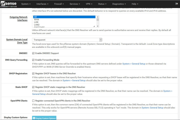

              Thank you for your reply. If I uncheck DHCP Registration, then will I be able to enter the servers and etc with their hostname, not with their ip address?
              My screenshot:
              Elvin
                Gertjan
                @emammadov said in dhcpleases error in system log:
                DHCP Registration
                When "DHCP Registration" is checked, on every incoming (new) lease, the dhcpleases process will restart unbound.
                This is a very know subject on this forum btw.
                You have many devices ? unbound will get hail-stormed.
                So, as said above, create "DHCP Static Mappings" (DHCP Server page) for all you devices (or : the ones that need to be resolved) and you'll be fine, or at least : better.
