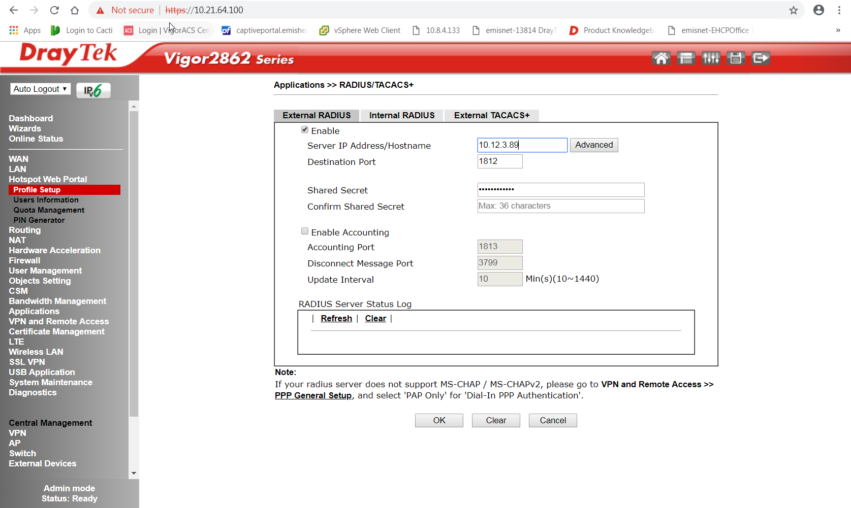

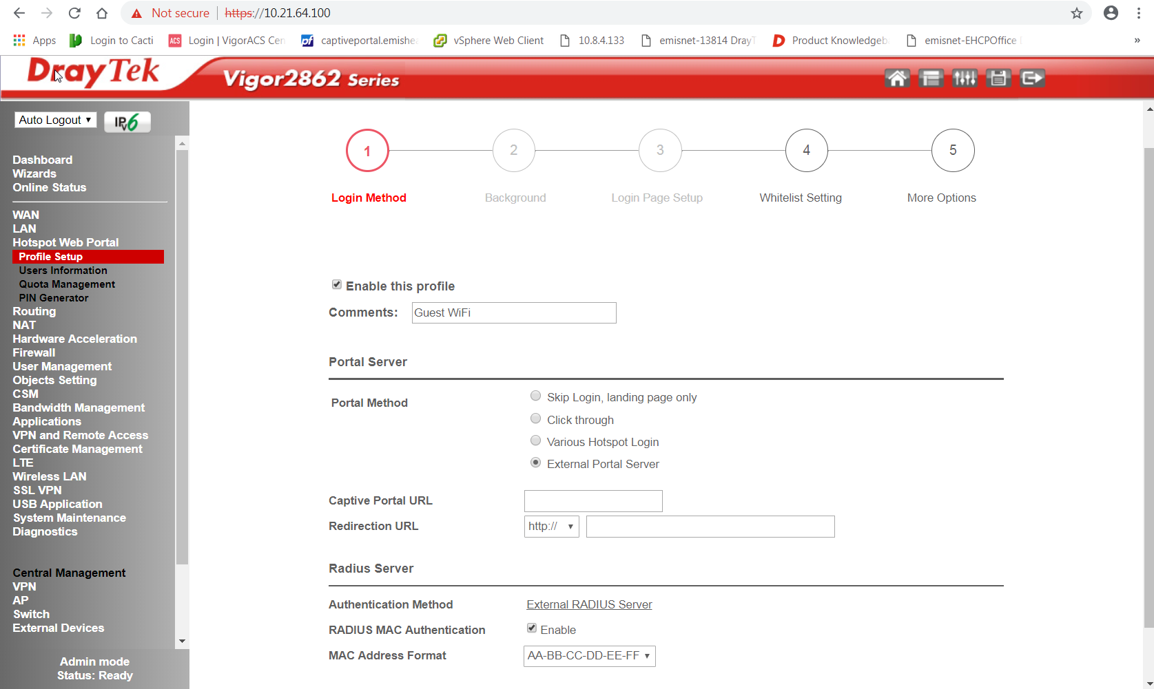

              Hi I have attached screenshots of the Draytek "external auth".
              ![alt text](0_1539358601985_2018-10-12 16_35_36-emisnet-hiran Vigor2862 Series.png image url)
              ![alt text](0_1539358617035_2018-10-12 16_34_39-emisnet-hiran Vigor2862 Series.png image url)
              ![alt text](image url)
                Gertjan
                The image confirms : set up and have it talk to a (Free)Radius server.
