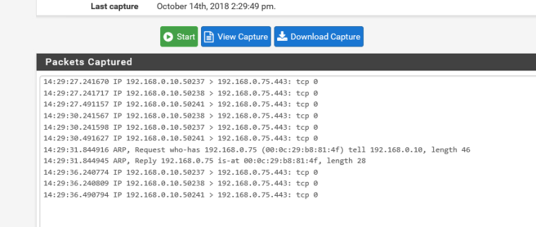

                    • P
                      Ptibiskwi
                      I just did it on the PfSense side and it sees the request and sends an ack.

                          • johnpozJ
                            johnpoz LAYER 8 Global Moderator @Ptibiskwi
                            @ptibiskwi said in Acces WebGUI from Wan issue.:
                            No it didn't - it answered an arp request, from your pic it is not sending back anything.. All I see it traffic to 443, no response from 443.
                            Same with your ssh - no response, just an answer to the arp request.
                            Did you edit your wan rules to allow ssh? What is in your floating rules if anything?
                            edit: Do you have any sort of port forwards that might be forwarding those ports or floating rules that would block them? You sure your rules loaded? Once you allowed the port?
