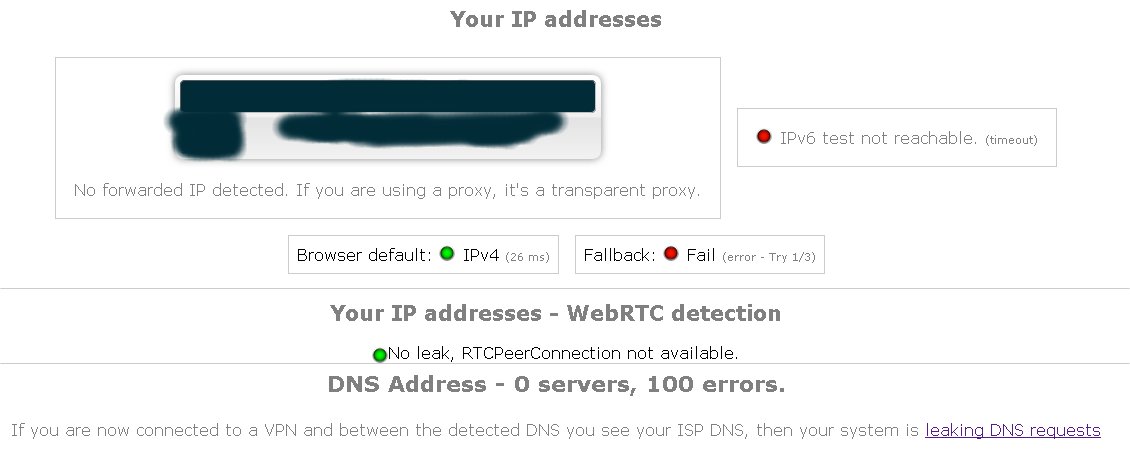

    I’m not really sure what the question i need to ask is in order to solve my problem all i know is that when i upgraded from 2.4.3 to 2.4.4 ipleak.net started giving me 100 dns errors.
    Having looked at the release notes for 2.4.4 i’ve noticed that something new was done to the dns resolver feature so my assumption is that this is what’s causing my problem.
    What i don’t know though is exactly what the problem is or what to do to fix it.
    All i know is that the settings i use for 2.4.3 work and give me no dns errors on the ipleak.net site but don’t work if i upgrade to 2.4.4. I’ve gone back and forth a number of times now making sure it’s pfsense 2.4.4 that’s causing the problem. That much I’m very confident about. I just have no real clue as to why other than the above mentioned change to the dns resolver feature.
    As far as i can tell everything else works fine and so does ipleak.net when not using pfsense 2.4.4. Soon as its used however the dns errors appear when running the ipleak.net dns test.
    I’ve tried blindly ticking and unticking the new boxes in the dns resolver page but nothing helped.
    Does anyone have any idea why this is happening and ideally how i fix it?

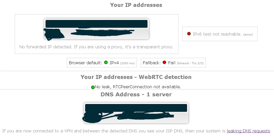

    Just for reference this is what i get when running 2.4.3 and is what it should show:
    And this is what i get if running 2.4.4 and gives me the errors:
