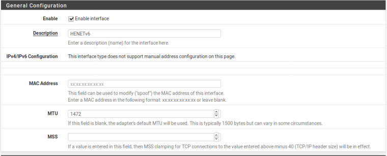

                    Also, just double check that on the Interface you have assigned to the HE GIF, you are allowing ICMP through too.
                    As for the MTU Size, I've got mine set to 1472 (my PPPoE is set to 1492) and this works fine for me. Make sure, again, that the interface assigned to the HE GIF, has the same MTU as configured within tunnelbroker:
                    IPV6 over IPV4 (which is effectively what is happening with this tunnel) we only need to work out the IPV4 overhead (20 bytes) so this is why my MTU is set to 1472. I'm not sure if you would also need to consider the overhead for 802.1q (VLAN) which is 4 bytes, so you may need to up it to 24 bytes overhead.

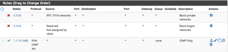

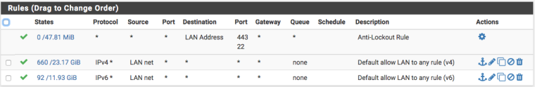

                        On the vlan I have
                        On the tunnel interface I have
