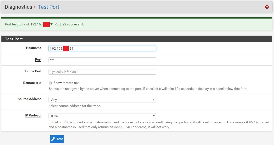

      Also the device I am trying to SSH to is working properly and yes it has the pfsense set as the gateway. I can connect to this device via SSH on the LAN with zero issues. The test port to host function on the pfsense router shows this port open and working.

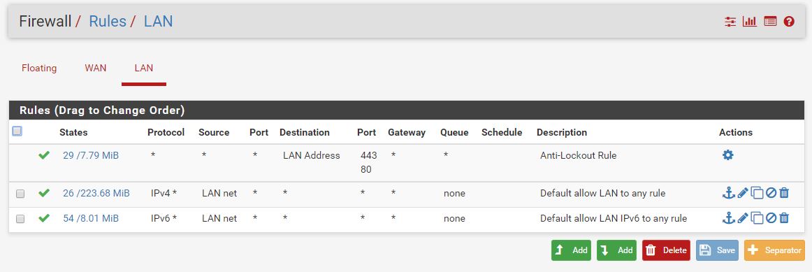

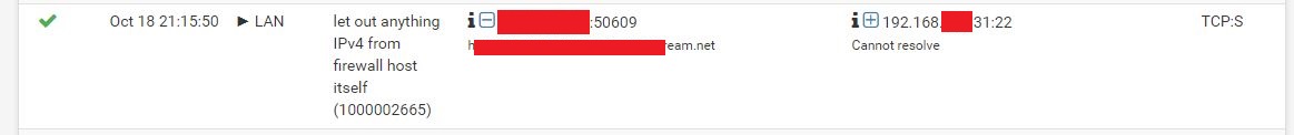

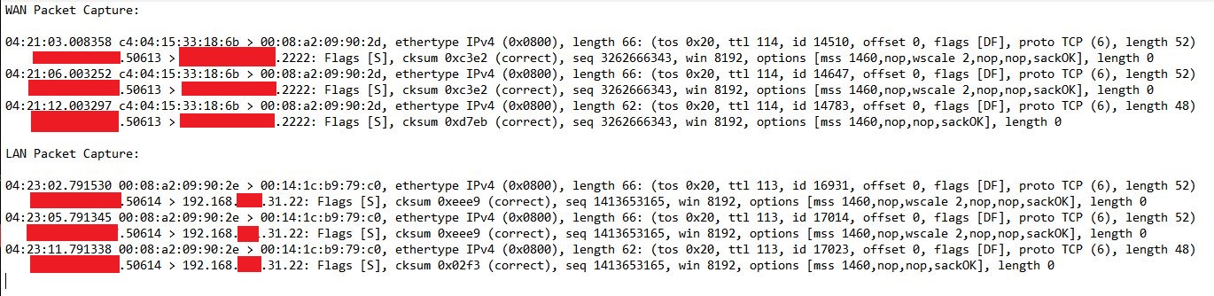

        The SSH server is not responding to the connections from the foreign subnet. Test port connects from its local subnet.
        Either its firewall is blocking it or its default gateway is not set to pfSense.

            In case anyone was curious about what my issue was it was indeed the SSH terminal server that wasn't responding.
            The boiled down version is I am using a layer 3 Cisco router as an async terminal server. Overkill but this is the hardware I had so I'm using it.
            The gateway was indeed set to the pfSense however apparently because of the configuration I am using with ip alias and vty; routing is enabled. When routing is enabled the Cisco ignores the default-gateway for obvious reasons. The order in which I programmed and tested configuration had me believing the gateway was being used.
            Ultimately it was Derelict @Derelict on here that got me pointing in the right direction. I was too deep in the forest to see the trees. Once he proposed the foreign subnet and gateway suggestion this made me verify again the route information on the Cisco. This is when I discovered the gateway was no longer the default-gateway despite my running config stating such.
            I can't recall the forum post on Cisco forums however it was this information that made me realize that I have to run my terminal server in router mode whether I wanted to or not so I setup a static route to point to the pfSense at the gateway.
            This got things chooching again.
