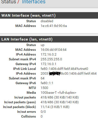

Hi, I use a second pfsense install where I turned off firewalling in config and routing because its only one LAN Interface and a disabled WAN.
radvd is still sending Route InformationTo turn off this, I'd like to set its Lifetime to 0, but I have only a slaac IPv6 at LAN and I get
I don't want use DHCPv6, I want to change the RouterLifetime to 0. It should be automatic turned off iff only one Interface ist present, but I can do it by hand. Maybe some other things should be changeable in radvd beside no static IPv6 is there?

This is what I get if I want to reach the RA gui. I can not change Router Lifetime, becaus it wont let me. The Error message tells me, I can not turn on dhcpv6, but I wont do this. I want to see RA Option to set Route Lifetime to 0 because it is 60 as you see.

@johnpoz My pfsense#1 is doing routing, firwalling, dns resolver, radius and gets from WAN a dynamic /56 Prefix from Deutsche Telekom. Just a normal internetrouter. Works.
my pfsense#2 is just for a second DNS Resolver, and a proxy and a freeradius server in the future. I could use a debian installation but I choose to use pfsense. pfsense#2 is only an other serving thing on my LAN side, so WAN port is disabled and not configured and LAN port gets an IPv6 via SLAAC from pfsense#1, how else? pfsense#2 should advertise via RA the RDNSS and I think it does. But it advertise a Route Lifetime at 60s too.
@JKnott I don't turned it on. Why you are thinking this? The error message is confusing because I don't want to turn on any dhcpv6, it comes on the way to the RA GUI I want to reach. Is it a language problem and I discribe it in a stupid way? My problem is clear to me and I'm wondering that nobody see it ;-) I'm sorry, will try to describe the whole thing:
I have a internetconnection where a router is at the edge. this router does routing, firewalling, dns resolving, gets dynamic IPv6 prefix for the LAN-side. Pretty good. I call it "pfsense#1".
I want to have a DNS Resolver at my LAN. Maybe in future a radius. No router or fw nessessary because there is only one interface/port, the port to the LAN. I choose to use a virtuell pfsense installation and call it "pfsense#2". Thats it. Should be a normal thing, is'nt it? How can I use it with IPv6 if I get only dynamic IPv6? How can I tell the LAN clients about this DNS Resolver via IPv6? RDNSS? Ddhcpv6? I'm right or totaly wrong?
Why propagates pfsense#2 a Route Lifetime of 60s? Why can I not turn on an dhcpv6 with a valid but dynamic IPv6, if dhcpv6 should only propagate the DNS Resolver at pfsense#2? Why can I not reach the RA GUI to change Route Lifetime to 0s (there is nothing to tell from pfsense#2 because there is no route to nowhere).

This second pfsense has only 1 interface right? I can try and duplicate what your doing.. But if the pfsense box only has 1 interface it would be considered its wan.. Since it would have a gateway.. Pfsense shouldn't be sending RA into its lan with any sort of prefix on it. Can we see your radvd.conf
@johnpoz this point is really good, but I wanted to use the same base, gui and so on. Could be, that this never work, but what else should one do with this weather outside :-)
See my edit - does this pfsense only have 1 interface? What is your conf file look like.. Why would radvd even be running?

/var/etc/radvd.conf
Automatically Generated, do not edit
Generated for DHCPv6 Server lan
interface vtnet0 {
AdvSendAdvert on;
MinRtrAdvInterval 5;
MaxRtrAdvInterval 20;
AdvLinkMTU 1500;
AdvDefaultPreference medium;
AdvManagedFlag on;
AdvOtherConfigFlag on;
prefix 2003:xxxx:xxxx:8c00::/64 {
DeprecatePrefix on;
AdvOnLink on;
AdvAutonomous on;
AdvRouterAddr on;
AdvValidLifetime 86400;
AdvPreferredLifetime 14400;
route ::/0 {
AdvRoutePreference medium;
RemoveRoute on;
RDNSS 2003:xxxx:xxxx:8c00:1406:ddff:fe6f:464 { };
DNSSL example.lan { }; -

If you want to use pfsense as standalone box it would only have 1 interface it would call its wan.. You have it with 2 and just have its wan disable.. So it thinks its router - and then then it would need to run RA, etc. To provide to its clients..
When you install pfsense and only bring up 1 interface it gears itself more as standalone box.. But again its not really a great choice of just running unbound..
@johnpoz Its not only running unbound. there is pfblocker, radius, maybe a proxy in future. thats the idea.
And RA should running for advertising the DNS Server at pfsense#2. I think, dhcpv6 should also be running for advertising DNS. Or doesnt like the clients RAs from different servers in the network?
Here I fired up pfsense with just WAN in my lan network, using slaac.. So its standalone mode so to speak. As you can see NO radvd even there... no dhcpd or dhcpdv6 etc etc...
If you want to use it as standalone - then there should be only 1 interface - and it will be wan... Then no RA will never be sent at all.. Because its not a router ;)
