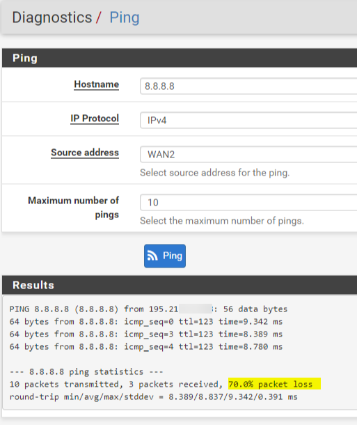

          2_1540300861995_Status_ Gateways.png 1_1540300861995_Diagnostics_ping_WAN2.png 0_1540300861994_Diagnostics_ping_WAN.png

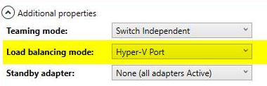

                      Hi everyone,
                      The solution : replace "Dynamic" by "Hyper-V Port" protocol in the "Load balancing mode" of the Teaming properties.
                      Everything work and no more packet loss !
