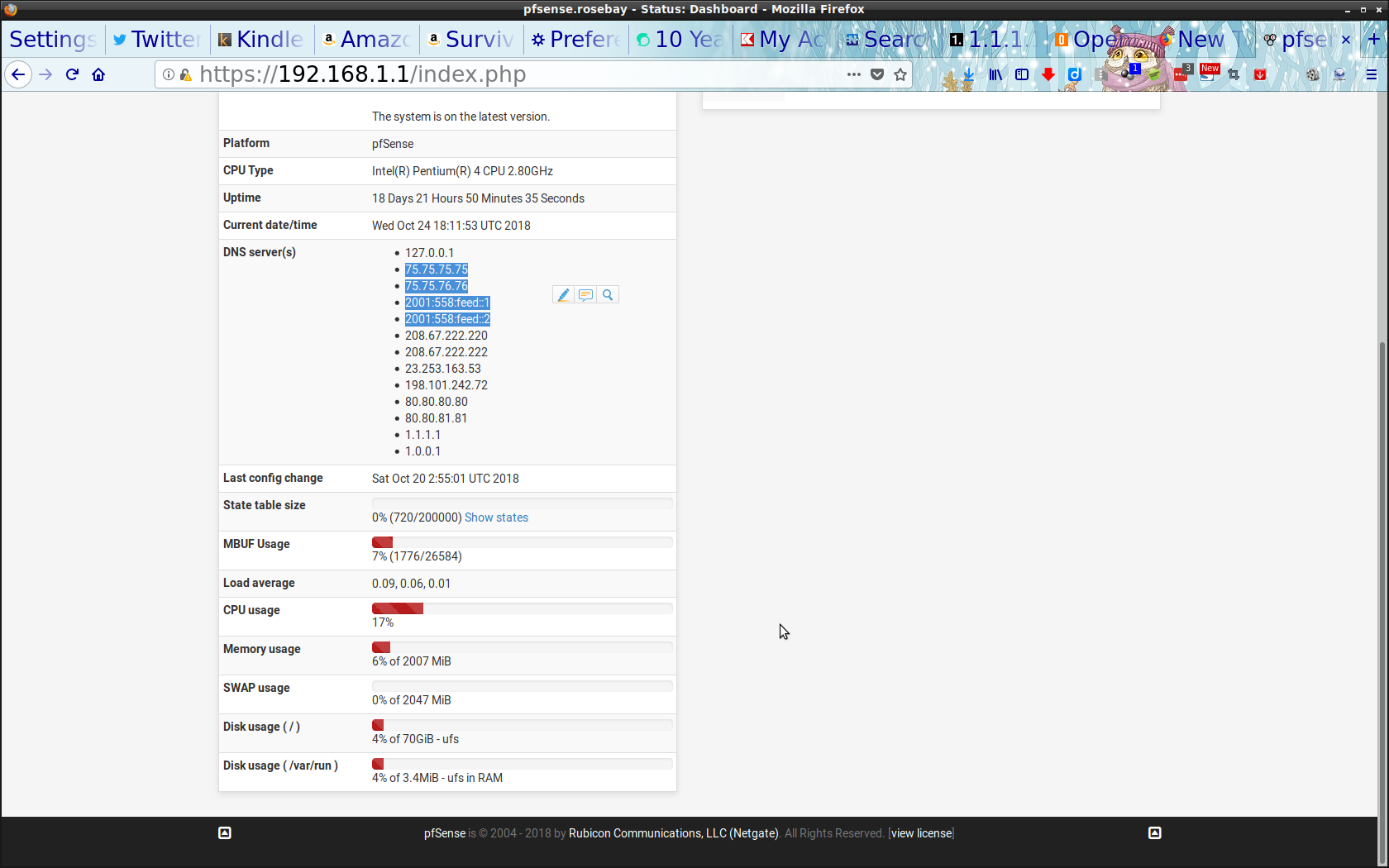

      Can some one please explain why my isp's dns server (Comcast) is popping up in my dashboard? 😠 I have not configured their isp dns for my setup nor care to. yet its there. i can't figure out howto remove them nor have i found anything talking about it elsewhere. Insight appreciated.☺
      0_1540404841714_Screenshot from 2018-10-24 14-12-02.png 0_1540404882909_Screenshot from 2018-10-24 14-12-59.png

        Look at your second screenshot, you have the mouse already in the right place.
        @hart02 said in dns isp hijacking:
        H 1 Reply Last reply Reply Quote 2

          Also, that isn't ISP DNS hijacking. ISP DNS hijacking is when your ISP intercepts your DNS requests to any public DNS server and redirects them to its own DNS.

            @grimson so i turn off "Allow DNS server list to be overridden by DHCP/PPP on WAN", and I get this0_1540426909456_Screenshot from 2018-10-24 20-18-55.png the end result i wanted

              Start a new thread about it in the pfblocker sub. This has nothing to do with your 'DNS servers from ISP' issue. By unchecking that box, your ISP's DNS are no longer in your list.
