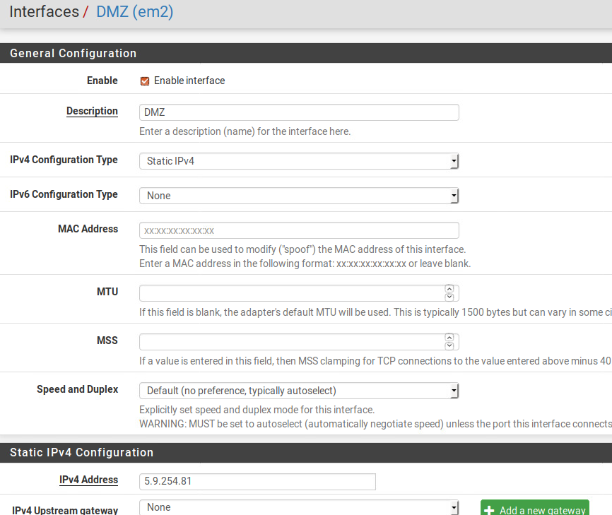

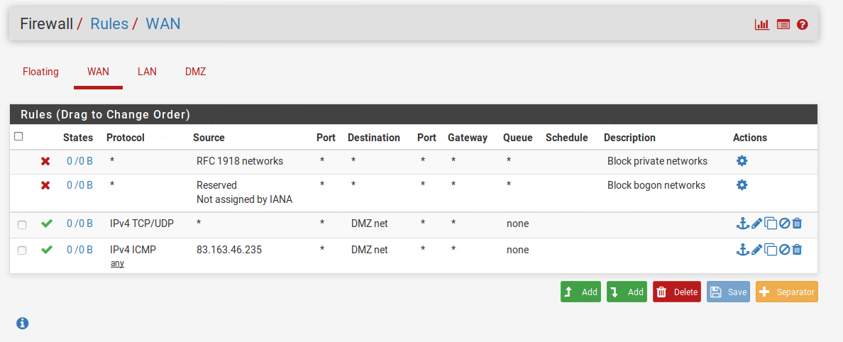

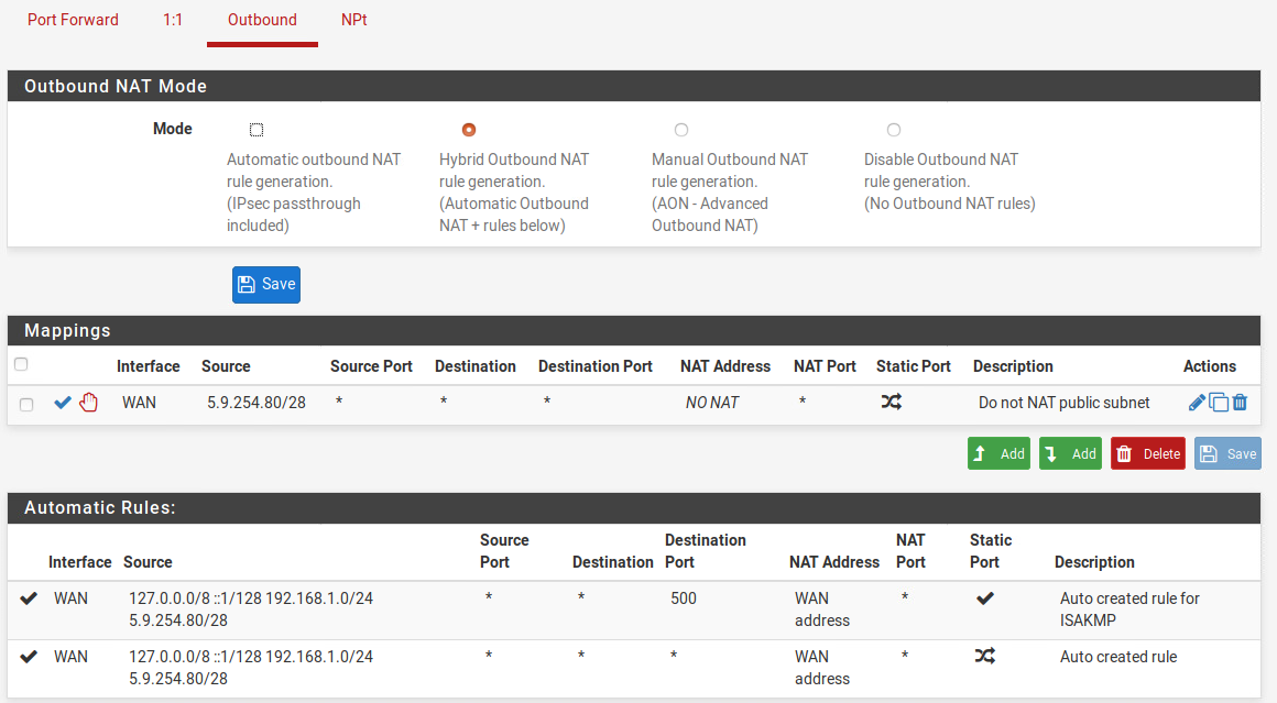

                      comnsense
                      Okay, it seems that they (Hetzner) have now router everything correctly.
                      To be sure I did a factory reset of pfsense and configured it again. Unfortunately nothing seems to have changed, DMZ clients still can't connect to the outside.
                      I've included several screenshots of my configuration.
                      5_1541034747085_4_dmz_rules.png 4_1541034747076_3_wan_rules.png 3_1541034747066_6_dmz_client_term.png 2_1541034747057_5_dmz_client_ip.png 1_1541034747047_2_nat.png 0_1541034747019_1_interface.PNG
                      I hope this helps in trying to figure out where I went wrong.
