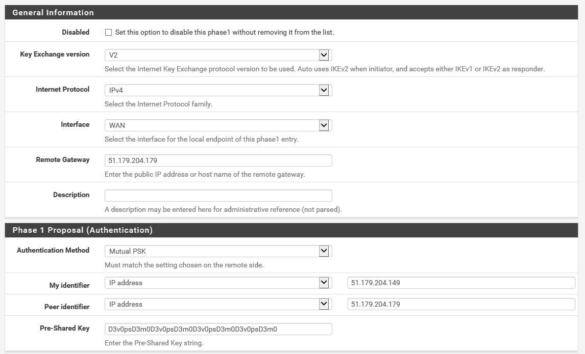

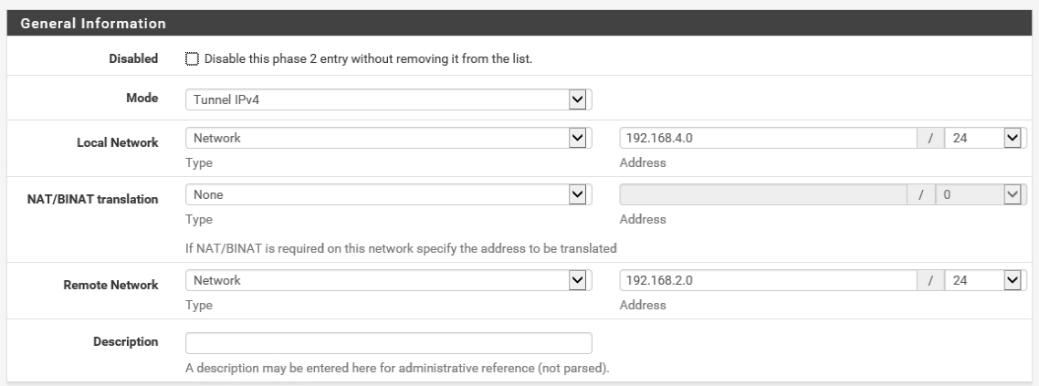

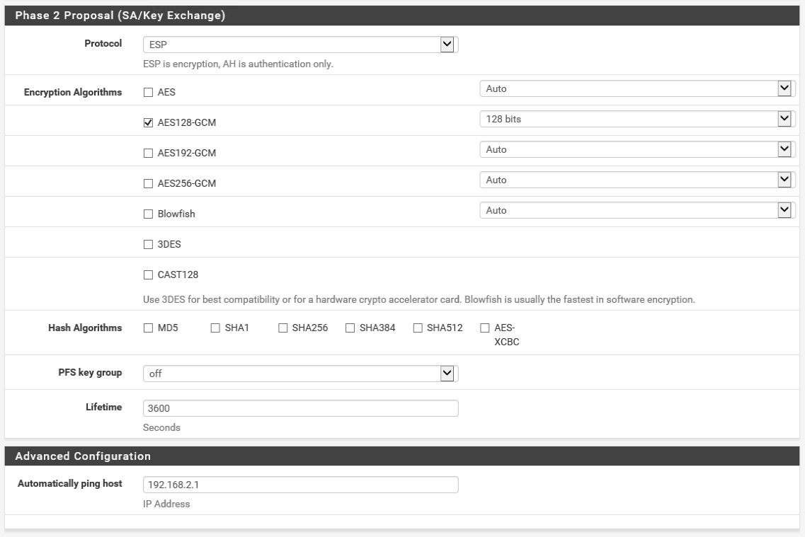

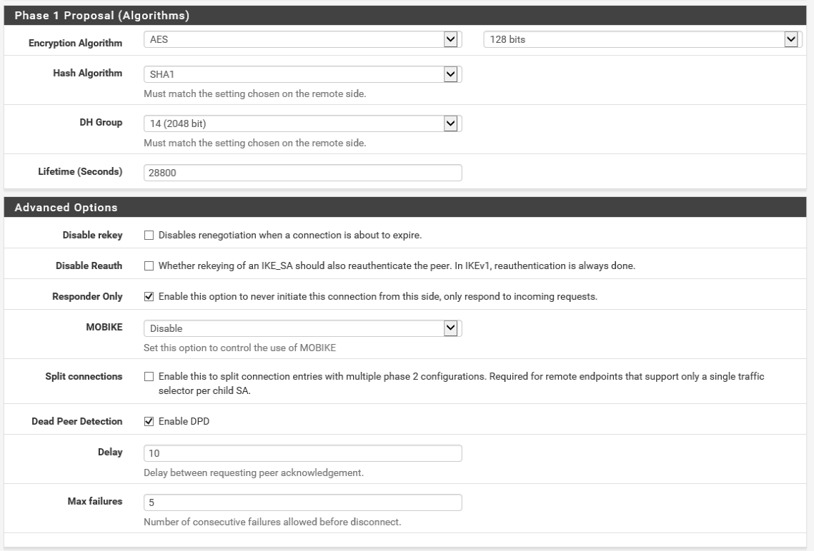

      Hello,
      I'm setup an IPSec VPN (2.3.2-RELEASE) between two OpenStack environments and the two pfsense boxes connect but I am unable to tunnel traffic through them.
      Below is the setup (mirrored with the other box-with the corresponding IP ranges):
      Below is the VPN logs:
      Can anyone give any pointers to where I may be going wrong?

        You have "Responder only" checked on both sides? If so, the tunnel can never establish as neither side will try.
        And also: Upgrade.
