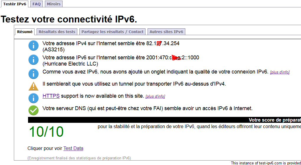

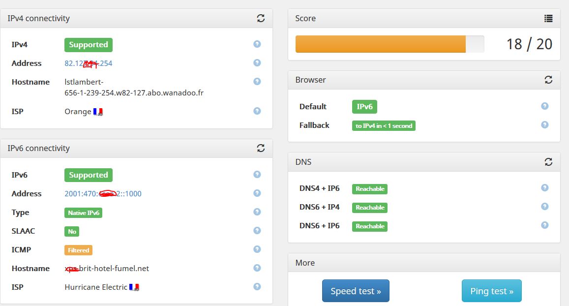

My office uses pfSense, situated begin the same ISP, using the same router, also : only IPv4.But, because I use pfSense at the Office, I've set up he.net and I used their /56 to attribute full IPv6 on my office LAN's.
I also setup a VPN server "road warrior" access on my pfSense using both IPv4 and IPv6.Now, when I start the VPN access to my Office from Home, I have full IPv6 access at home.
Btw : the /56 and /64 he.net never change as long as you keep your account. The WAN IP4 on both Home or Office can change any time, my tunnel always works, using the same IPv6 prefix for years now.
