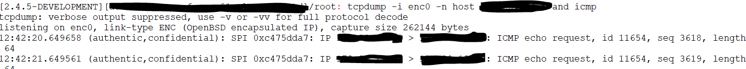

    Packet Cap on enc0 while pinging from router - the filter is for the firewall address, the packets are router > firewall:

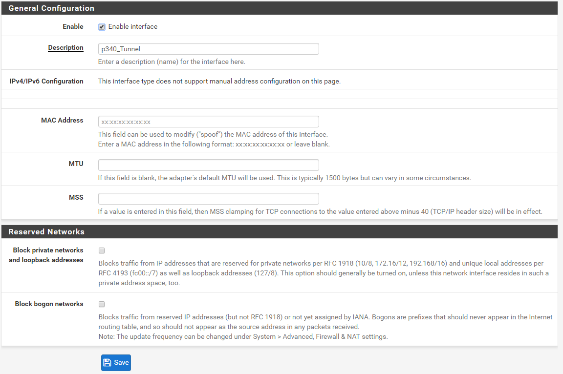

    Here's the config on pfSense:

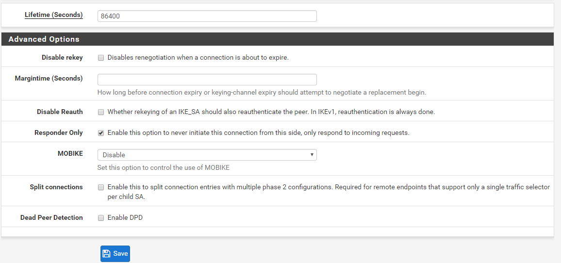

    Phase 1 - 0.0.0.0 as our endpoints are dynamic addressing:

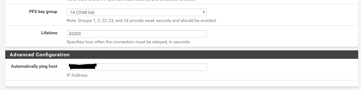

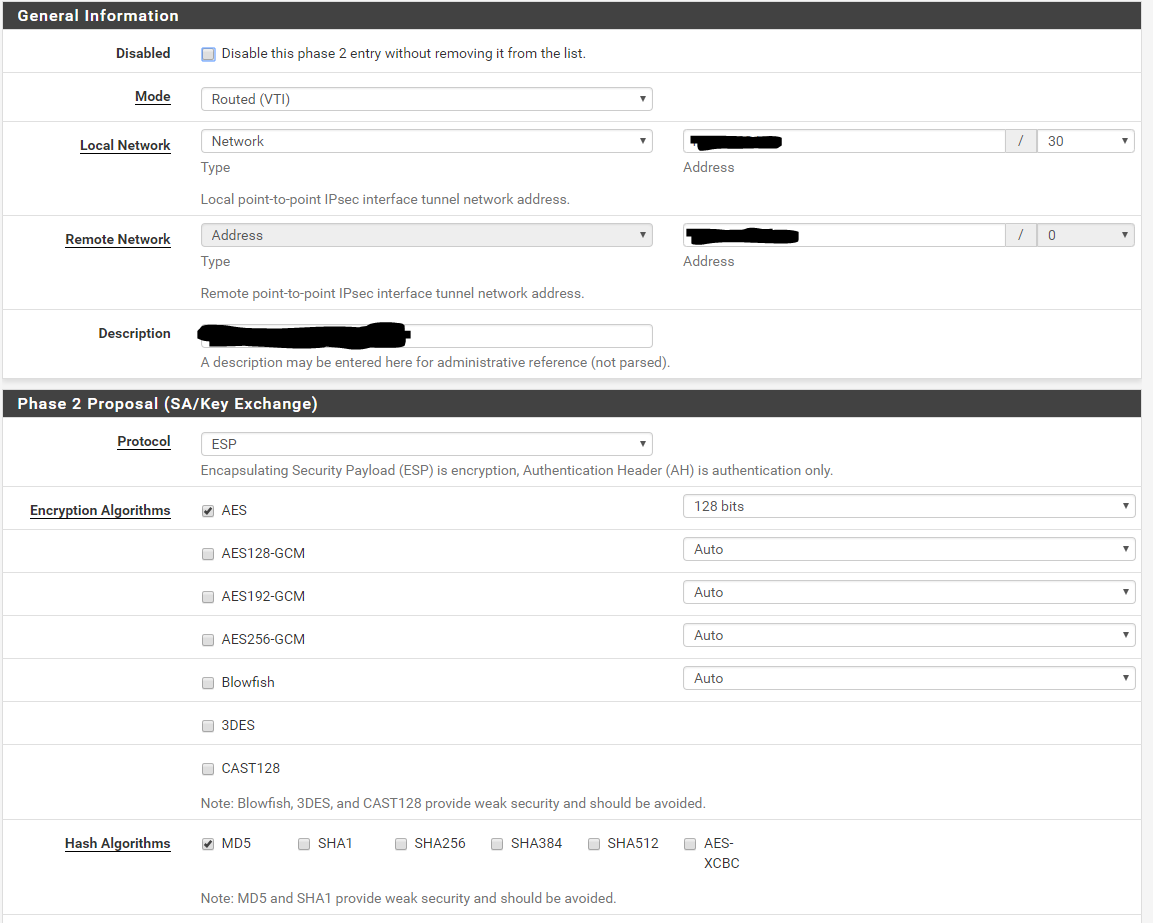

    Phase 2:

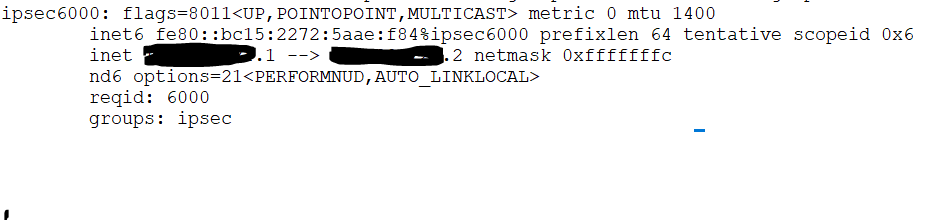

    Interface:
    Route exists (.1 is firewall, .2 is router)

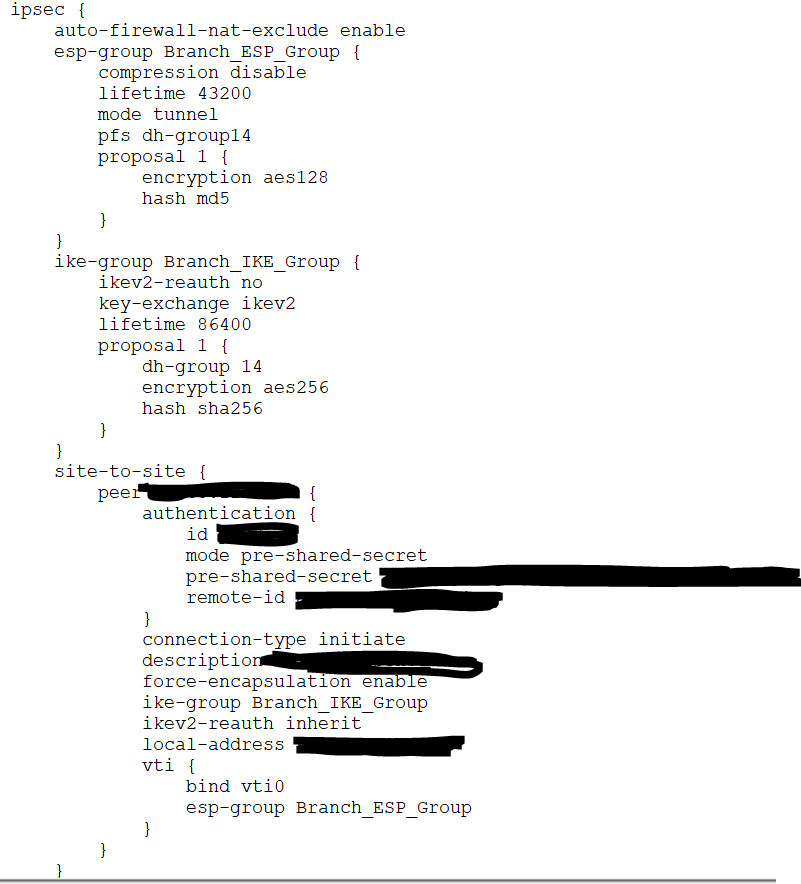

    EdgeRouter Config (this editor is removing the tabs from config FYI so I had to use a snip):

  • Upon further investigation I've noticed the following:
    The interface is not showing a 'running' status, which explains my problem. Now to find out how to resolve it.
  • To answer my own question now:
    VTI tunnels cannot be set up with 0.0.0.0 as the remote peer, you must use an IP address or domain name.
