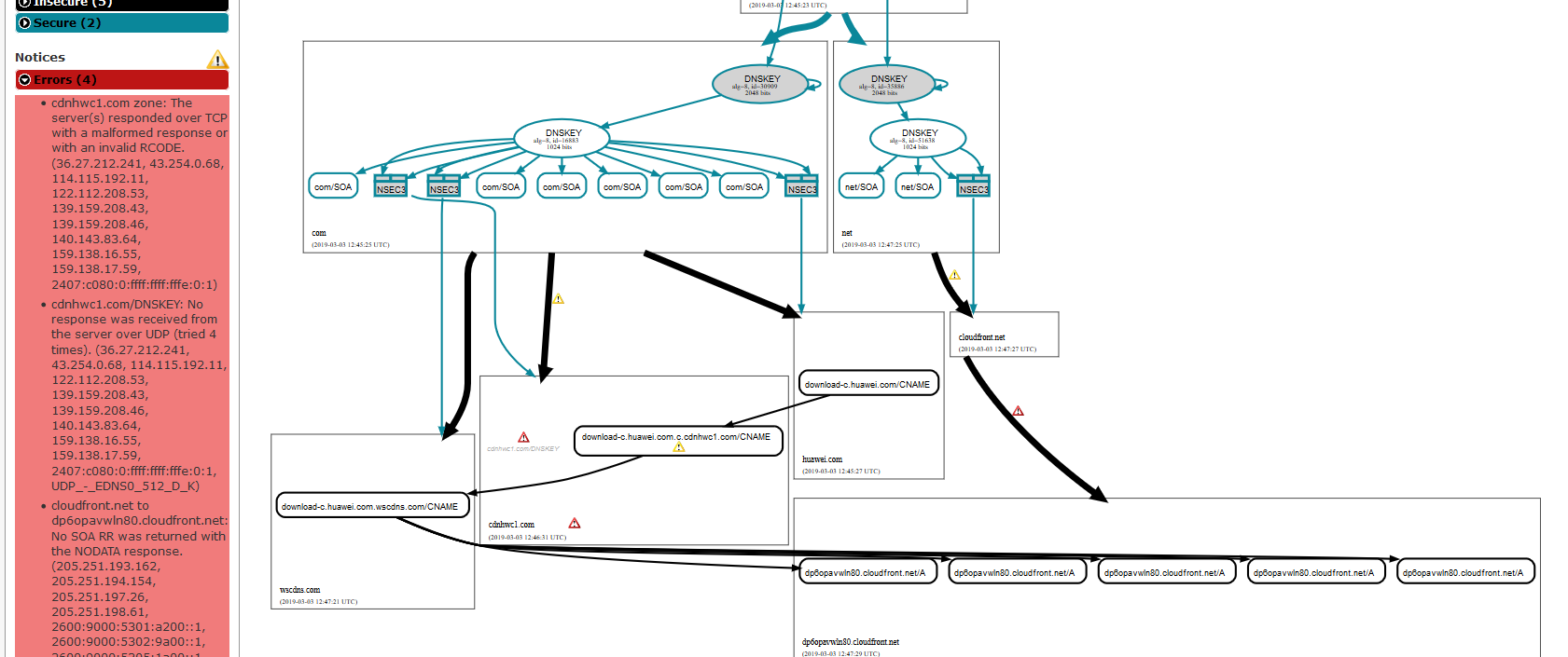

                  They have a HUGE mess!!
                  http://dnsviz.net/d/download-c.huawei.com/dnssec/

                                  dig download-c.huawei.com +trace
                                  ; <<>> DiG 9.11.3-1ubuntu1.5-Ubuntu <<>> download-c.huawei.com +trace
                                  ;; global options: +cmd
                                  ;; Received 28 bytes from 127.0.0.53#53(127.0.0.53) in 0
                                  probably need some help from you with the commands, to do any deeper analysis. but seems very odd to me, that the nslookup fails simply by changing the forwarding mode
