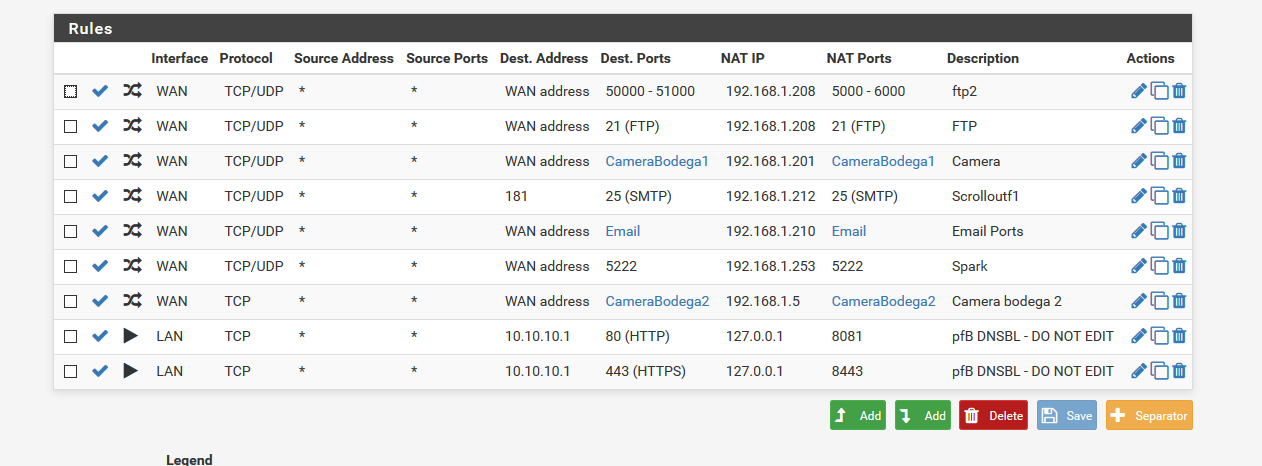

          Thanks for the reply, sorry i made a mistake on the port i fixed it but still no luck
          when you say send your WAN address instead of its inside you mean on the FTP server? currently using filezilla and using passive ports 50000-51000 and using the WAN ip instead of the LAN

            @killmasta93 said in Issue with FTP Passive?:
            Server sent passive reply with unroutable address 192.168.1.208, using host address instead.
            With those settings you would not be getting that error.
            Everything looks fine on the rules based on that last screen shot.
            Packet capture the port 21 traffic on WAN or, better yet, capture all traffic from the IP address you are testing from on the WAN. I'll PM you a link you can upload it to so I can look at it.
