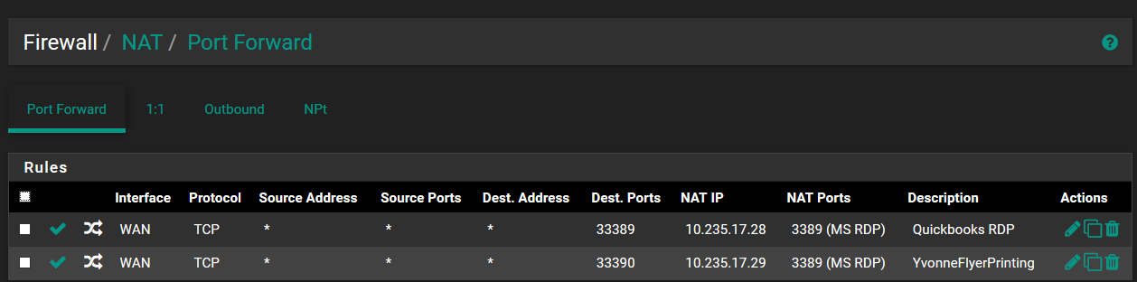

        @virtuousmight said in IP Lan Block Migrated - Remote Access cannot get through Firewall Gateway:
        The problem is that AT&T shifted our LAN IP block from 12.42.213.88/29 to 12.42.213.90/29.
        Your LAN IP block? Looks like WAN to me. They should have specified the address you should use as a gateway. Probably 12.42.213.91. But that would affect all internet traffic, not just a couple of port forwards. And those are not valid /29 networks. 12.42.213.90 is inside 12.42.213.88/29. The next highest /29 would be 12.42.213.96/29.
        I don't care for destination any in a port forward. The destination address should be the address they are connecting to.

              For your sake, please obfuscate your public IPs, especially as you appear to have RDP open from the Internet. Consider using a VPN or two-factor. Something like xx.yy.zz.96/29 is sufficient for the topic.

                    To me that looks like WAN should be configured like this:
                    IPv4 Configuration Type: Static IPv4
                    IPv6 Configuration Type: Static IPv6
                    IPv4 Address: X.X.X.66 /30
                    IPv4 Upstream Gateway: X.X.X.65
                    IPv6 Address: 2001:1890:xxxx:xxxx::1143:6616 /64
                    IPv6 Upstream Gateway: 2001:1890:xxxx:xxxx::ee43:6616
                    X.X.X.96/29 looks like it is routed to you. A port forward on any of those addresses should work without Virtual IP addresses assigned.
                    It looks like 2001:1890:xxxx:xxxx::/56 is also routed to you.
                    The only thing I would change is asking for a /29 instead of a /30 and asking for a /48 instead of a /56. They should have no problems with either request and, IMHO, should not charge for either. If they ask you why you want the /29 on the interface, tell them you need 3 addresses for VRRP.
