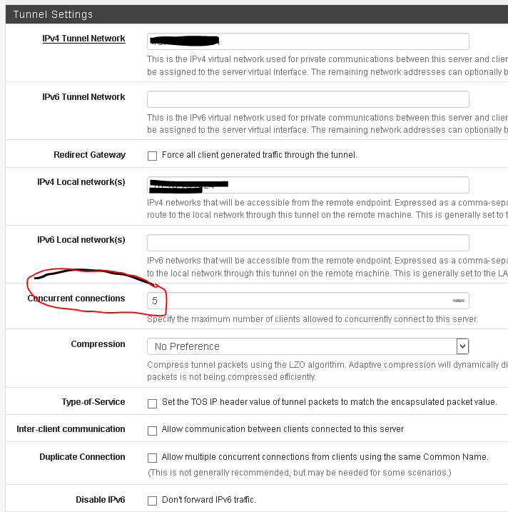

      I also reinstalled 2.4.3 and restored a backup from when I was out of town and the issue still persists. At the moment I am at a lost and don't know what else is wrong and am about to setup something different for VPN as much as I don't want to because I liked the way it worked with pfsense on it's own. Below are pictures of my OpenVpn setting. Please let me know if you need more information if needed to be confirmed of checked.

        Specify "Concurrent connections" in the server settings.

            I saw this earlier and I did play with this and it did not make any difference, sadly. To my knowledge this was always empty. Currently I set it to 10 again to test, restarted the server and repeated my test and got the same result. Phone 1 connects and works fine, phone 2/Laptop connect, but I can't get any traffic to anything on the internet or even on local, both time out on the 2nd connected device.
