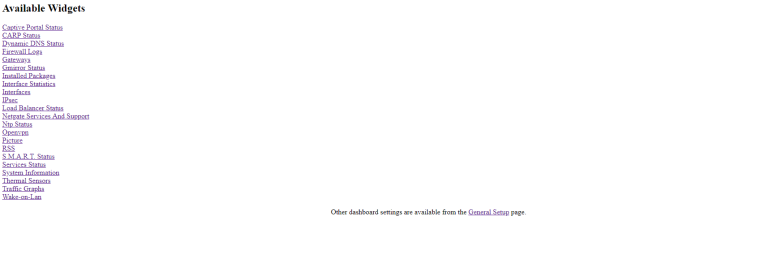

      I've got an issue with a pfsense 2.4.4-RELEASE system where after a power outage, it has come back on, and is functioning as normal everywhere except the WebGUI. When I try to load the login page, it just displays the attached screenshot. I had a snapshot of the machine as it's a VM, I restored it to the snapshot which has made no change. Any thoughts?!
      I have tried loading this page on both chrome and internet explorer on 3 different machines.

        The UI theme (CSS) is not loading. Click on the System link, then General setup and try to select a different theme before saving.

          Clicking on any of the links on the left just adds a /# to the end of the URL without actually loading anything else, and clicking general setup has loaded just the below error on it's own page. It seems to then need a reboot to get back to the previous screenshot.
          Fatal error: Uncaught Error: Call to undefined function isAllowedPage() in /usr/local/www/index.php:82 Stack trace: #0 {main} thrown in /usr/local/www/index.php on line 82 PHP ERROR: Type: 1, File: /usr/local/www/index.php, Line: 82, Message: Uncaught Error: Call to undefined function isAllowedPage() in /usr/local/www/index.php:82 Stack trace: #0 {main} thrown

            It seems like more than just your CSS files are missing or corrupted. Probably time to check your disk, repair as needed and reinstall pfSense.
