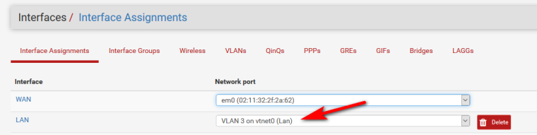

    If your not wanting to use the untagged network of the physical interface of LAN and want vlan 20 to be your lan - then setup the lan interface to use vlan 20 as like my above pic and set the name of pfsense to whatever it is you want. Now that name will return the IP of vlan 20. In other words LAN...
