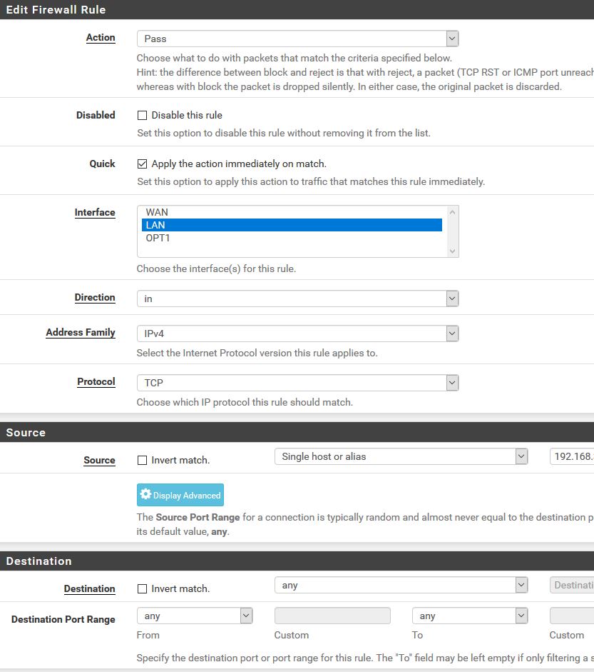

Under Firewall Rules, LAN, I created a rule to pass any traffic from 192.168.1.5 (test station to be limited) to !192.168.1.0/24, IPV4, TCP+UDP, with the Limit In=UPLOAD, Out=DOWNLOAD. Besides that rule, below it there's a pass any/any/any... rule to allow everything else, with no limit.

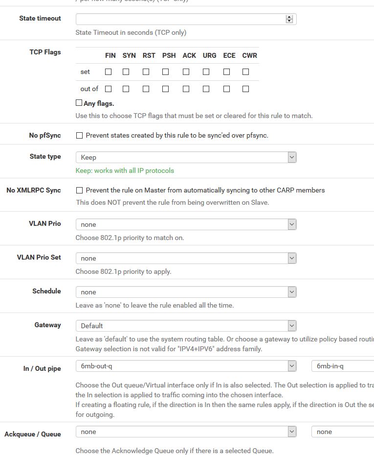

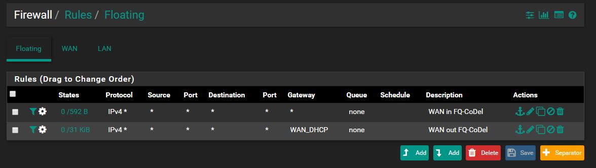

I created some floating rules as you suggested, however only the "IN" floating rule seems to be catching any traffic, so I applied the traffic shaper queues to the In & Out Pipes of that rule, and the result is the same, speedtest.net shows the upload is less than 10% of the shaper's limit. At first I had set the shapers IN and OUT to be 6mbps, and on speedtest.net, the download would be limited correctly at 6mbps, but the upload would error out. If I bumped up the upload/out limiter from 6mbps to 20mbps, then speedtest.net wouldn't error on the upload anymore, but would only show ~1.5mbps.
Here's some screenshots of the rules:

I changed from interface rules to floating rules as you suggested, and it works just the same as it did with the normal rules on the WAN or LAN interfaces. Essentially, the shaper for the download works fine, but the shaper for the upload is still being restricted to like 1/10th of the shaper limit for the upload queue.
For the time being, I've just multiplied the upload shaper by x10 to make it behave the way I want, but I'd still like to get to the bottom of it, whether it's a bug or me doing something wrong.
