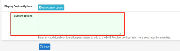

          Regarding "add a line at the top that says server:" - sorry but I don't see a way to add any line in the Advanced tab - there are only fields to type something.
          • jimpJ Offline
            Not the advanced options tab, but here:
            That's on the main DNS Resolver tab
