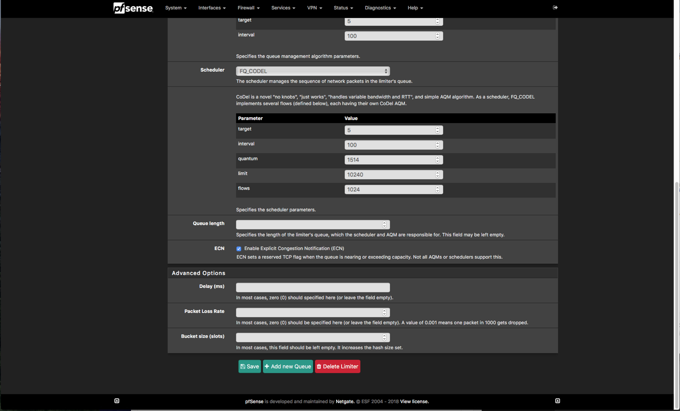

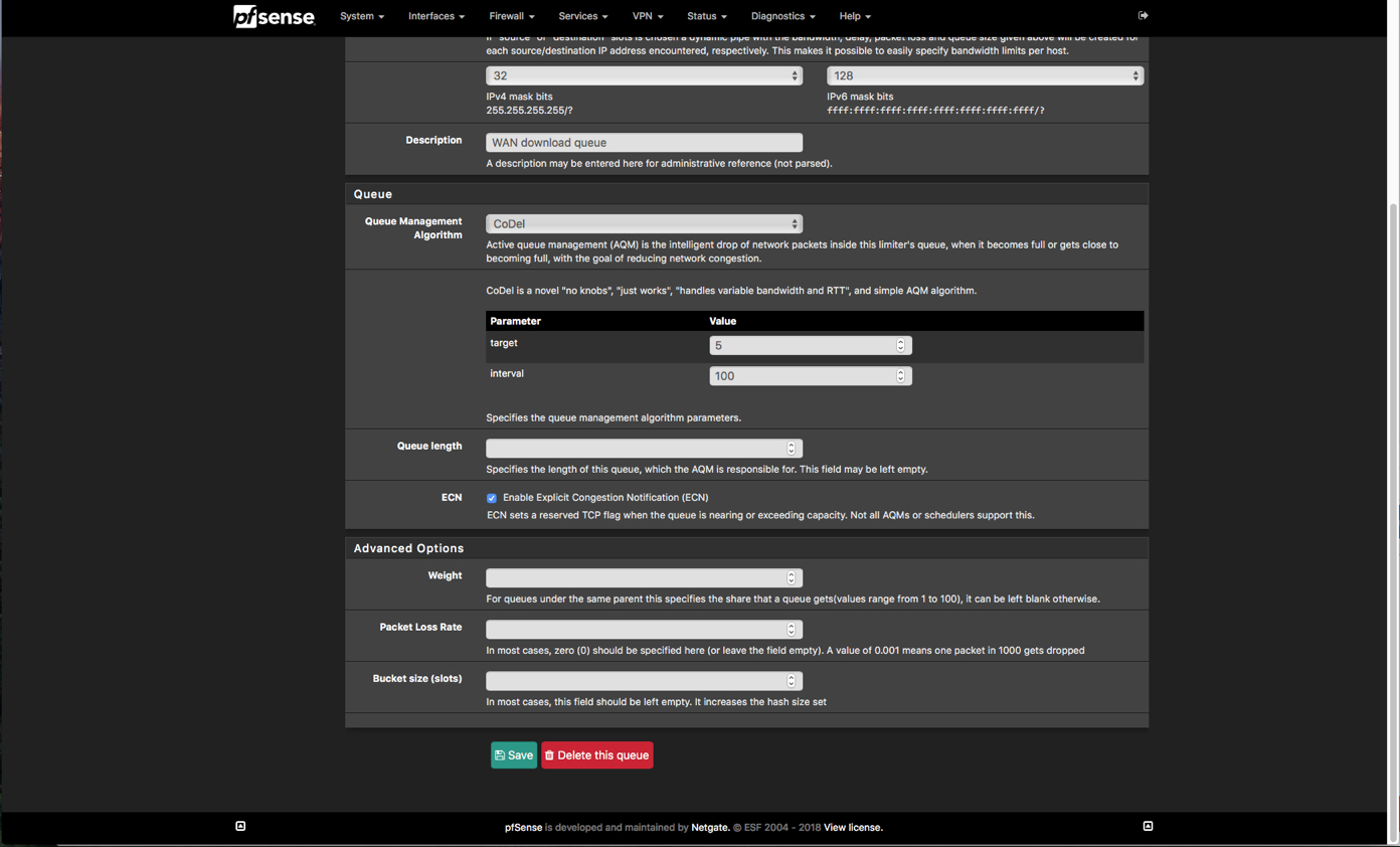

      I followed the instructions in a recent negate video for setting up flow control with codel/fq_codel. Now I'm seeing this error occasionally via console. Not sure what's causing it or if it really represents a problem. I know the bandwidths are set correctly. Not sure what else to check?
      pfSense version 2.4.4 on SG-3100.
      I can post screenshots for wan_up but other than bandwidth I don't see any difference in the settings.

        @wgstarks CoDel should not be set on the pipe or queues. Use taildop instead. FQ-CoDel is a scheduler and AQM.

            @wgstarks The August hangout video you are referring to does not accurately show how to properly configure the limiters and queues to use FQ-CoDel. You do not need to change Queue Management Algorithm to CoDel - leave it as Tail Drop. FQ-CoDel is managing its own internal queues. We have spent a lot of time hashing this out in the "Playing with fq_codel in 2.4" thread. The post I linked to above is written by one of the individuals that actually implemented FQ-CoDel in FreeBSD and he confirms in that post what we found through experimenting.
            In short, yes, you can use FQ-CoDel as the scheduler, and it looks to work very well, but you don't need to use plain CoDel as the queue manager at the same time. Does that make sense?
            There also appears to be a bug regarding limiters + NAT + ICMP so some of us are using separate floating rules to match ICMP traffic with a rule that does not have an in/out limiter associated. If you want more info, please read the "Playing with fq_codel in 2.4" thread starting at the post I linked to above.

                  @uptownvagrant Thanks. If I’m understanding the post you linked I should have the same settings as described there now that I have changed to tail drop on in/out pipes and associated queues.
