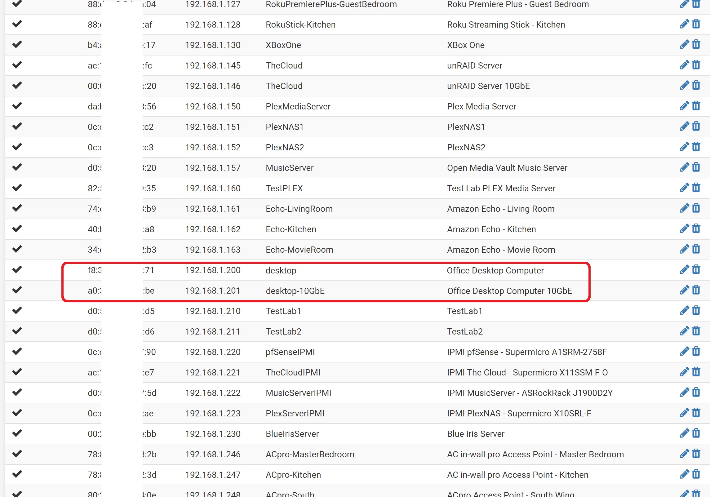

              Obviously, both NICs aren't plugged in at the same time. I am connecting through my 10GbE switch whether I'm on the 1G NIC or 10G NIC. And I have internet access from the 10G NIC, and I can access anything else on my network. I can access the webGUI from other computers/tablets. How do I find if there's an access restriction?

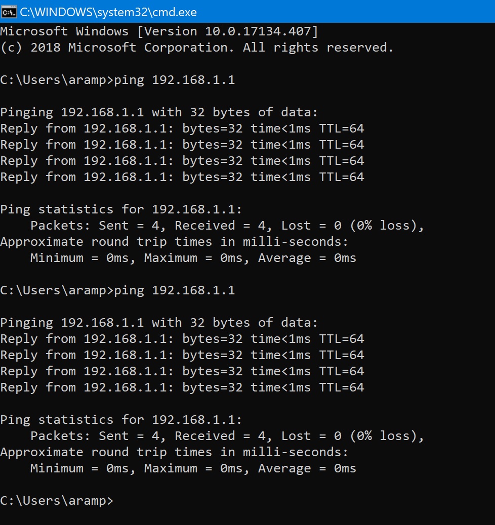

              Try to ping pfSense from 10G nic also fail? SSH CLI connection to it work?
              Is too easy open frenzy thread without providing sufficent information and basic test like ping , so it's a culture gap impossible to fix ๐Ÿ˜’
              Culture gap because I'm too old, young, or just a noob? ๐Ÿ˜€
              Ping works. Top test is the 1G and bottom is the 10G.
