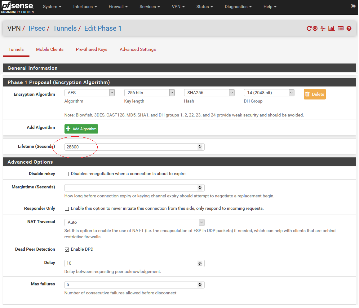

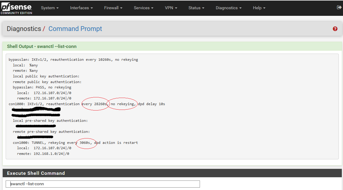

      When I set up the IPsec tunnel, I had rekeying disabled, as it was the default at the time. I have since unchecked the disable rekeying box. After a reboot I suspect rekeying is still disabled. The swanctl --list-conn output confims this.

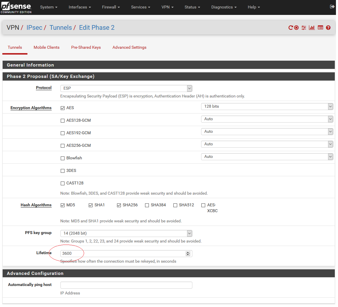

      I also noticed the lifetimes in the swanclt output are off by 540sec for both the Phase 1 and Phase 2 lifetimes.
      The tunnel functions as expected. however the IPSEC Overview Page lists multiple entries for the same tunnel?
