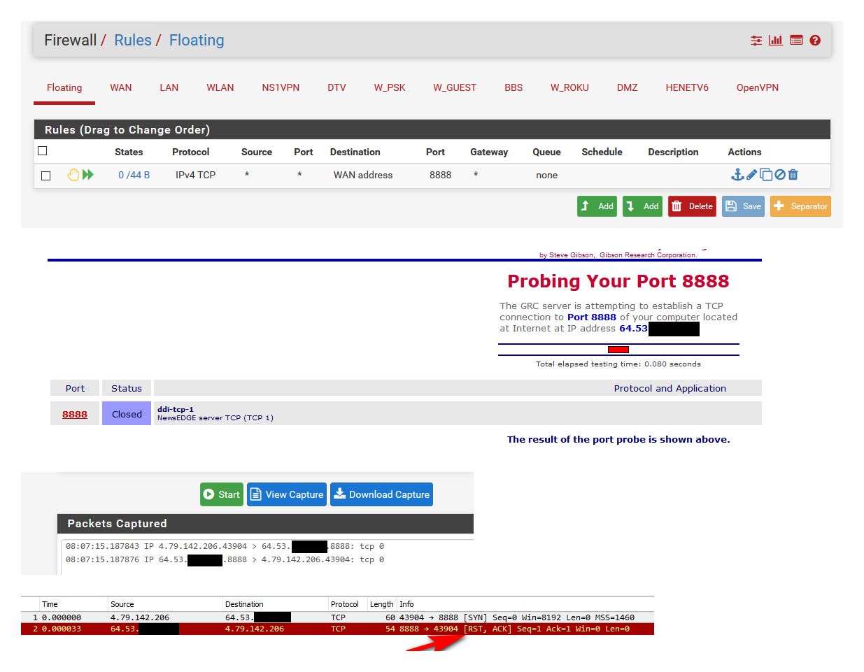

                • johnpozJ Online
                  So here -- something upstream (my isp most likely) is blocking 445
                  I use your grc tool and 445 comes back stealth - but I get nothing on pfsense wan.. Packet capture for 445 shows nothing..
                  I then pick another port 8888 in this case, and it still shows stealth - but pfsense actually sees this traffic, it just drops it - but it sees it..
                  So possible my cable modem is blocking this, such ports are clearly possible to be blocked inside even a modem. If you could do a query to your modem via snmp you might see something like
                  SnmpMib = docsDevFilterIpDestPortLow=445
                  SnmpMib = docsDevFilterIpDestPortHigh=445
                  But it really should not be sending back anything, it should just drop it.. But a sniff on pfsense will tell you if pfsense is seeing it, and then if pfsense or something behind pfsense is answering at all - So if sends back say a RST you would show it as closed vs no answer gets back the so called "stealth"
                  You say you created a floating rule - did you set that rule a REJECT vs block?
                  Here now I set a rule to reject 8888, shows closed and you can see pfsense set back a RST
