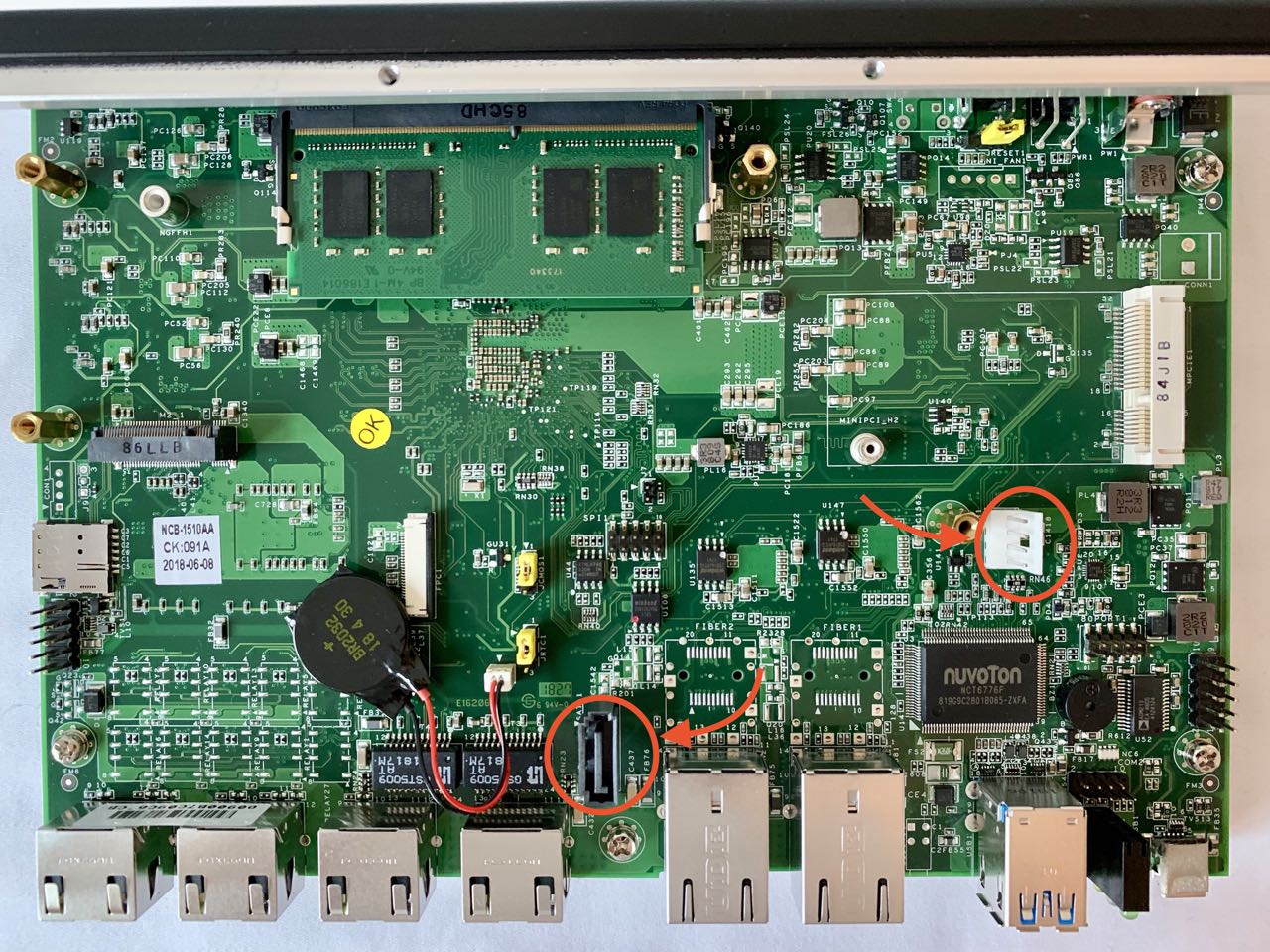

      I received my brand new SG-5100 today. I wanted to install a M.2 SATA in it, so I opened it up. Now, I am confused about something: This slot does not look like the 2242 M2 connector, it looks more like the older mini-pci SSDs (18+8 pins). Is this the right spot for the M2 installation? In older posts, others seems to have gone with the 2242 without a problem. Thanks...!!!!!

      • chrismacmahonC
        chrismacmahon
        That looks to be the MiniPCI slot, the M2 slot is located on the side of the board (keep the RAM module pointed away from you, it's to the left).
        Hope that helps.

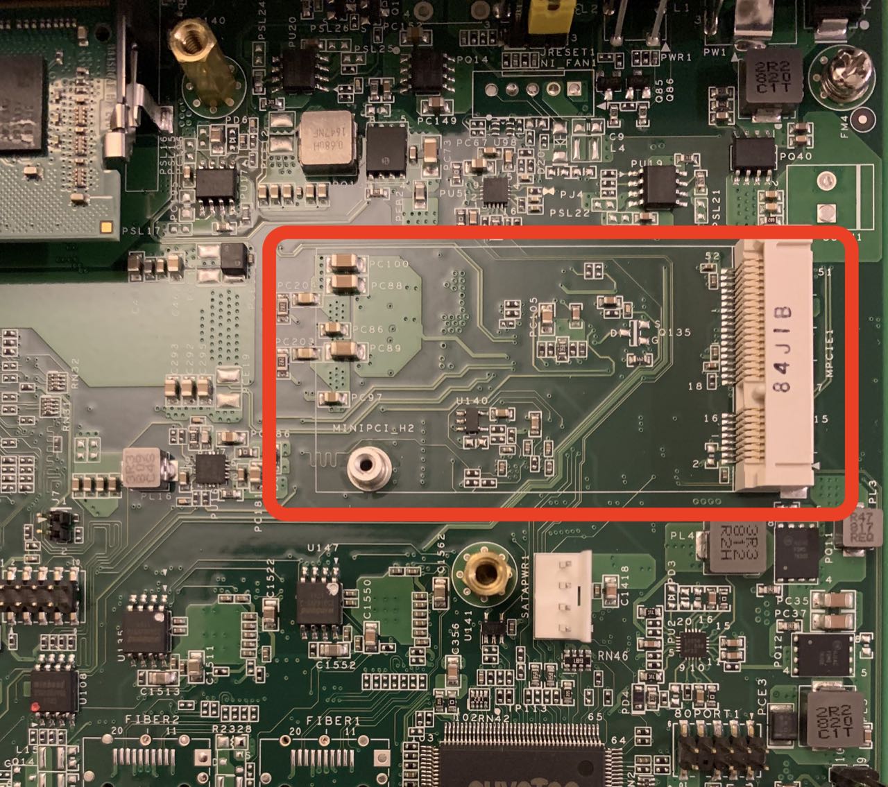

          Thank you for answering. Do you mean on the other side of the board where the CPU socket is? I didn't want to unscrew the board before being 100% sure, as the cpu seems to be connected to the base plate (heat sink) .. Other than that I only see a Serial ATA and a 4 pin power connector on this side. What is this MiniPCI slot for then?!0_1543599399179_IMG_3620.jpg

            If you look on the left side of that image you will see a BLACK bar next to the second post down. You should see just above it in white letters M2_1, that is where you put the M2 disk drive in.
            We have not tested adding a mSATA drive to the SG-5100.

              @chrismacmahon Got it. The M2 opening is so narrow the thought never crossed my mind that could be a connector base. But that looks to me to be a 2280 form factor as opposed to 2242. So, something like a Samsung 970 NVMe should work. Am I right?
