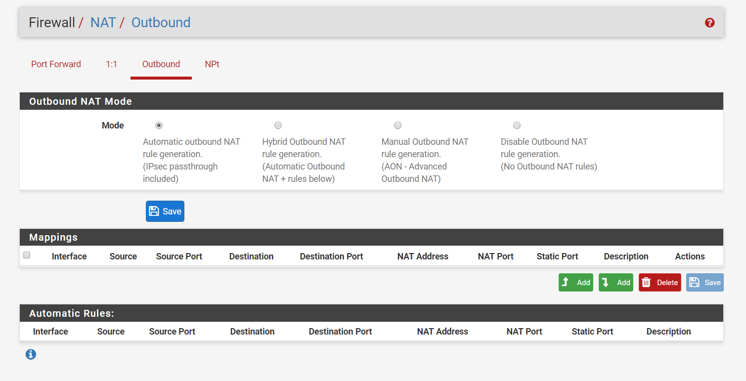

            And your nat is automatic - or did you change that to manual? or something.. Post up screenshot of your outbound nat tab..
            • M
              mountainlion
              • johnpozJ
                You have NO nats so no shit its not going to work.

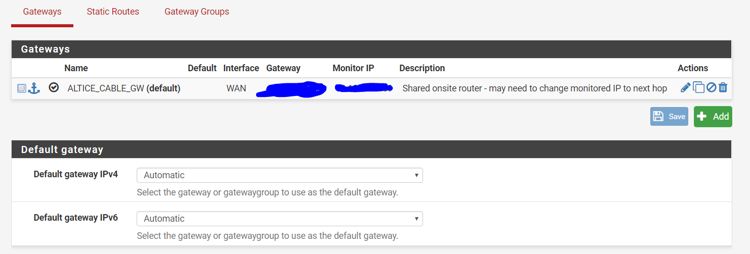

                                Make sure that:
                                1. WAN has a gateway selected on Interfaces > WAN (if static) or that it's set for a dynamic type (DHCP, PPPoE, etc)
                                2. LAN does not have a gateway set on Interfaces > LAN
                                Having a gateway selected will cause pfSense to treat the interface like a WAN, which means it won't have its subnet setup for automatic outbound NAT.

                                          • jimpJ
                                            @mountainlion said in Automatic NAT BROKEN:
                                            @jimp I think I have those parameters setup properly. Good suggestion, but not helping me, there is an explanation for this :) (previously mentioned)
                                            That does not tell us anything about Interfaces > WAN and if you have chosen a gateway on that page.
