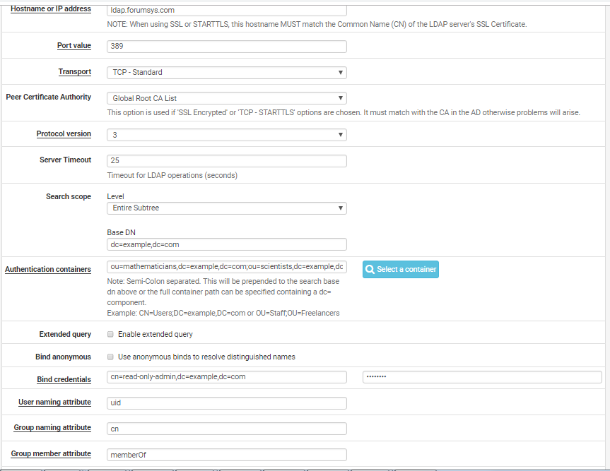

      1/on "SystemUser Manager>Authentication Servers" i add my ldap server;for my lab i used online LDAP server test(https://www.forumsys.com/tutorials/integration-how-to/ldap/online-ldap-test-server/):
      Server: ldap.forumsys.com
      Port: 389
      Bind DN: cn=read-only-admin,dc=example,dc=com
      Bind Password: password

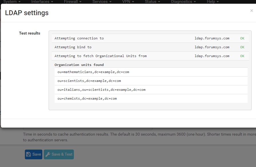

      2/on "SystemUser Manager>Settings" i tested my ldap server all are ok(you can see the attached imag)
      3/Doing test via Diagnostics->Authentication, I don't get anything ;Authentication failed, for an existing user/pw at the LDAP server?
      and no error massage found in system>logs file?
      please do you have any idea about this error?0_1544683775149_1544622160883-myldapconfig.png 0_1544683801043_1544622188660-testldap.png

            fayRofa @MR. Newbie
