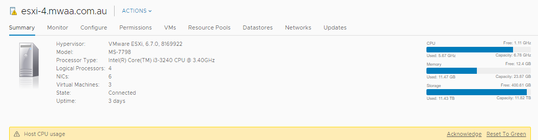

        I have the same exact issue, anyone have any ideas? I have tried disabling Hardware Checksum Offloading but nothing changes

            @david_harrison actually so is mine... everything seems ok now... what I did notice is that CPU usage goes up when assigning more than 1 cpu to the pfSense VM, but for my case 1 is more than enough

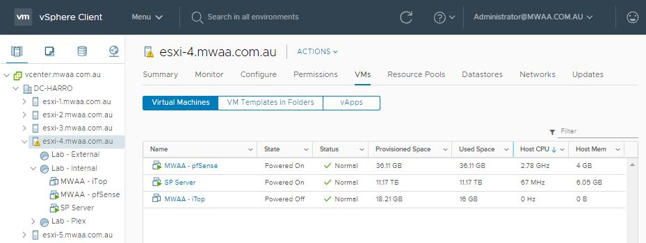

              david_harrison @david_harrison
              @david_harrison
              my issue wasn't so much that pfSense was using a lot of CPU...
              I have multiple VM's running on the host, and really when you added that up, pfSense was lucky to be getting what it was.
              Turn off all you other VM's on the host and see what pfSense is actually using on the host.

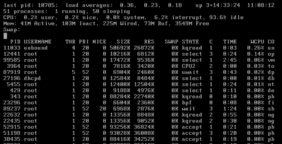

                    im passing through PT1000 and I350 Intel Nics and getting high cpu load when iperfing (1GBit) the pfsense host directly and also when iperfing hosts behind pfsense using it as as router (debian<--pfsense-->debian).
                    Pfsense shows 10% CPU load while the esxi host has a very high cpu load (80% on i3 7100).
                    Also tried vmxnet3 paravirt nics but load it only going down a bit - and shouldn't pci passthrough move all the irq stuff to the pfsense vm anyway ?
