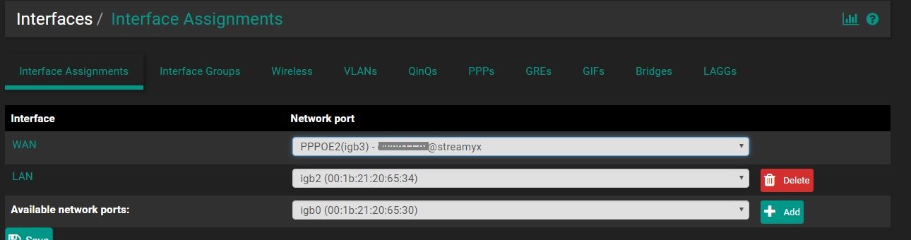

              this is my interface setup:
              i no know what is vlan or how to set it. but i already disable the DHCP on the Asus modem router. maybe it's not enough?

                  The only way some remote device could be connecting is via wifi.. Do you not have security setup on it, did you share this info with your neighbor.. Is it just the default SSID without security or default PSK? etc..
                  Yeah that config looks like a LOOP to me..
                  If you want to use your device as your "modem" then it should ONLY be connected to your WAN... its wifi should be turned off - get another AP for your wireless connectivity...

                      @stardreamer77 said in Pfsense connect with DSL modem wifi router problem need help.:
                      also Hide SSID
                      Completely Utterly POINTLESS!!! Do not do that!
                      Make your SSID UNIQUE, and use a good PSK!!
                      edit: As to can you fix it? Many of these devices allow for say port one to be in bridge mode, and provide no nat and public IP to the device connected to it.. While the other ports are behind NAT..
                      I do not know the particulars of your pppoe setup, nor what that device does or does not do for isolation of layer 2 when it its setup how you have it setup..
                      I would really suggest is just get another AP or wireless router to use as just AP so you can be sure your wan and lan or isolated at layer 2 physically..

                          Yes, it looks to me like your Asus router has started handing out DHCP leases in conflict with pfSense. Make sure it is running the same settings it was previosuly.
                          But, yes, it would be far better to use separate devices as the DSL modem and wifi access point. You're relying on PPPoE to separate WAN from LAN there.
