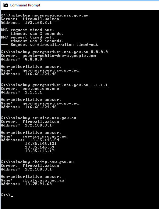

      I am at an absolute loss on why this isn't working or how I go about fixing it. I'm unable to connect to http://georgesriver.nsw.gov.au and the root cause is the DNS resolver.
      If you have a look the following nslookups, you can see that it fails when it hits the pfsense resolver, yet successfully resolves on 8.8.8.8 and 1.1.1.1. I've even tried a couple of other *.nsw.gov.au domains and the pfsense resolver works as expected.

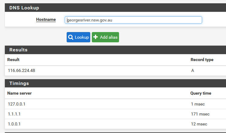

      When I use the DNS Diagnostic tool in pfsense, it resolves correctly.
      I've restarted the DNS resolver, and even restarted pfsense without any luck.
      Any ideas?
