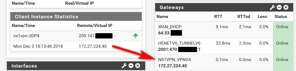

            Can you ping the IP? If you can not ping the IP then no monitoring will not work.. Also dpinger uses 0 payload.. Some IPs do not answer with that, etc.
            What does it matter if you ping or not - just set the gateway to always be up..
            Normally in a vpn client setup the monitoring IP is going to be the IP you get..
            if you change that then yeah you could have some issues depending.. Why do you want/need to change it.. If your vpn connection drops then you loose your IP and the gateway goes down..
